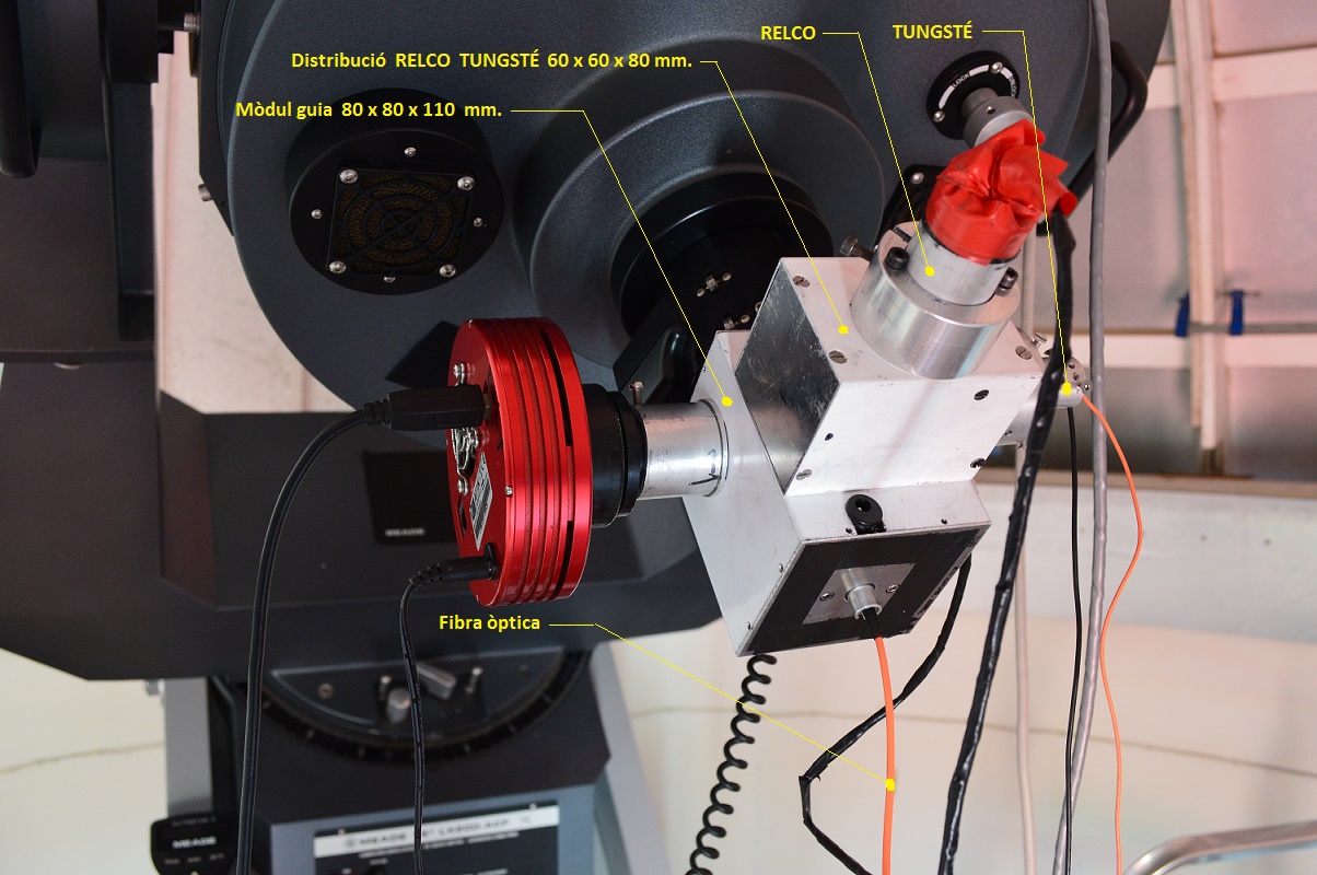

- Posts: 731
Re: ISIS AND A NEW ECHELLE
To all :
In recent weeks, I have conducted tests with the echelle, the results have been unstable.
I thank Martin Dubs for him generous and patient support, in the collimation and treatment echelle spectra.
ISIS has proven to be a good software, is surprisingly agile and reliable.
The AudeLA, use it to follow, well.
Attached here, graphic three stars of different Declination, have drawn his instrumental response. As you can see, the instrumental response of no use for the other two.
I think, the basis of the problem is that I can not get a good picture of tungsten, which has to be unique for each star.
I think the solution would be to install an optical fiber and a tracking box, leaving the echelle unmoving.
Have questions.
Fiber optics, micro lenses should carry at their ends?
What pinhole with reflective surface, use in tracking box?
I ask all sorts of suggestions.
Regards, Joan Guarro.

- Posts: 1276
Hi Joan,
I think you're right : the spectro should be independent of the telescope and placed in a local near the telescope (less than 20m) .
Once set, the spectro don't have shift (except temperature variations).
With my 2 echelle spectrograph, I take Tungstène and LED (to identify order) just one time at the beginning of the night and I take calibration lamp (Th/ar) after each target.
For fiber and its injection module you have 2 options:
- Buy the injection module from Shelyak :
http://www.shelyak.com/produit.php?id_p ... rubrique=7
It works very well
- Make it by yourself , but it is very difficult to achieve . The current project open source " Sardine " is working on this subject :
http://open-astronomy.org/sardine/?q=node/1
Sorry the website in only in French
Maybe you can contact them.
For fiber , there is no microlens , just a FC connector well aligned with the fiber and well polished.

- Posts: 731
Bonjour Olivier:
Merci pour ton réponse rapide.
Mon intention est de construire une boîte de suivi qui a le Relco et Tunsgteno et de travailler avec une seule fibre optique, qui va au spectrographe.
J'ai deux problèmes à résoudre. La première est la fibre optique et ses connexions.
Le second est le trou de 100 microns avec la surface réfléchissante. Dans ce cas, il y a deux options, l'une d'un trou sur verre de I mm. d'épaisseur, ( https://www.appliedimage.com/products/o ... ertures-oa ), L'autre un troud air sur une surface métallique de réflexion douteuse et de mauvaise qualité.
Je ne comprends pas très bien comment se comporte le cône de lumière sortant de la fibre optique (sans micro-lentille) pour être efficace dans le collimateur de l'echelle, un 30 mm. diamètre et focale 125 mm.
Il y a des jours, j'ai demandé pour l'inscription dans le forum de "La Sardine" Je ne l'ai pas encore reçu le pasword.
En 1 heure, avec ma femme, nous allons à Majorque, nous sommes à quelques jours, sans aucun mobile, pas d'ordinateur, pas de télescope ... Je vais répondre à des e-mails autour.
Bien cordialement, Joan.

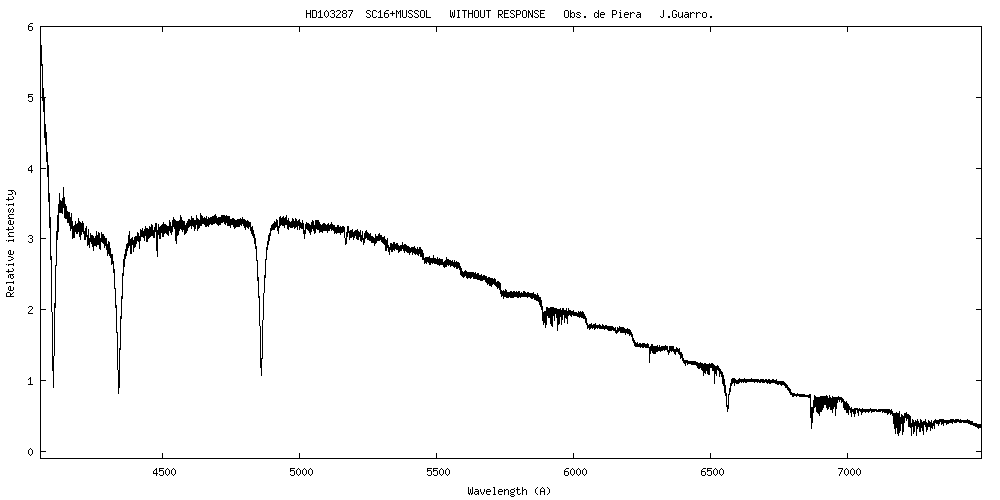

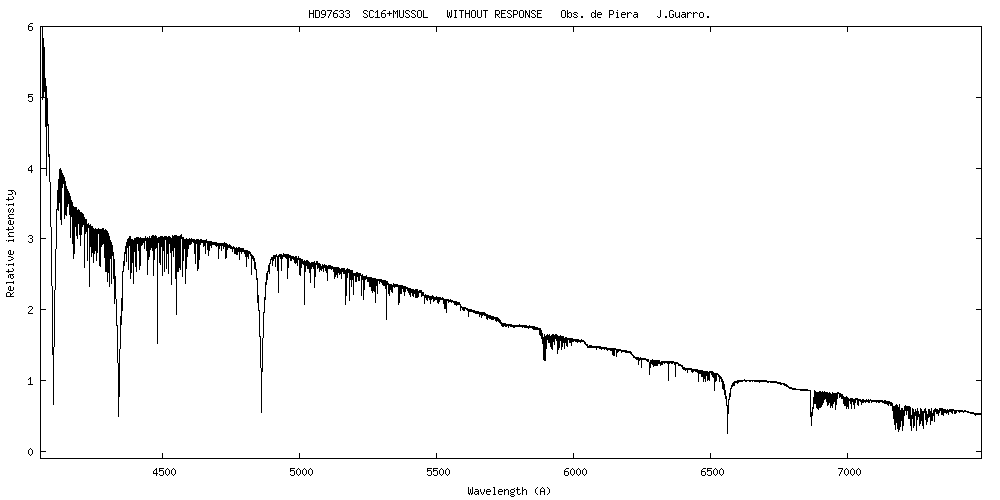

- Posts: 731
To all :

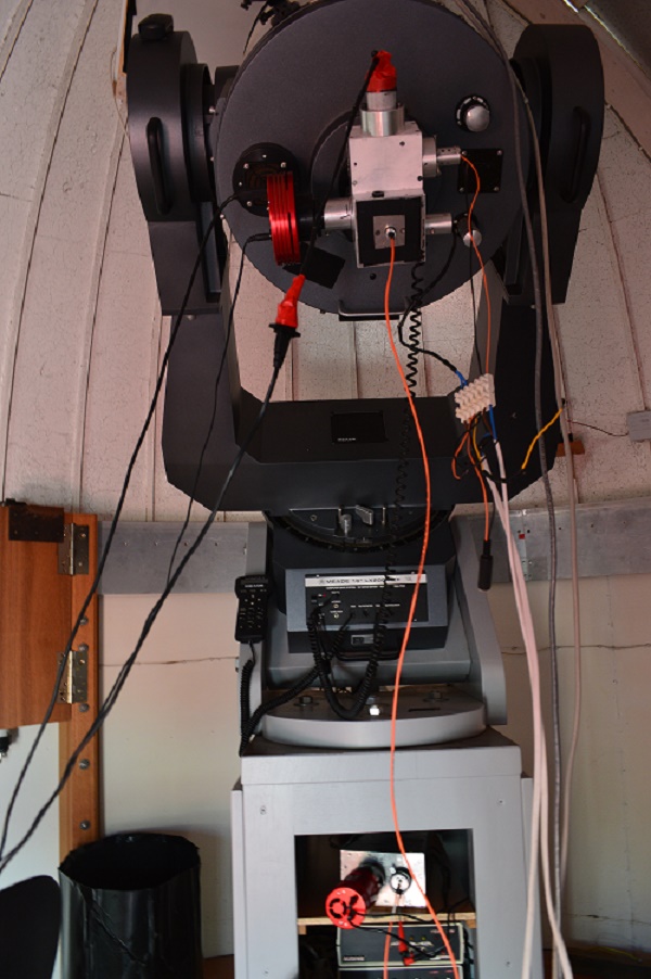

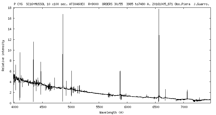

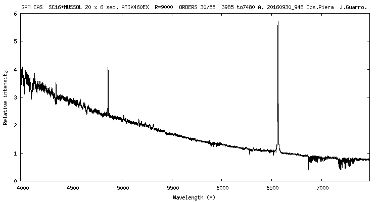

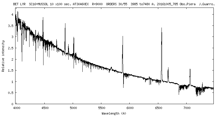

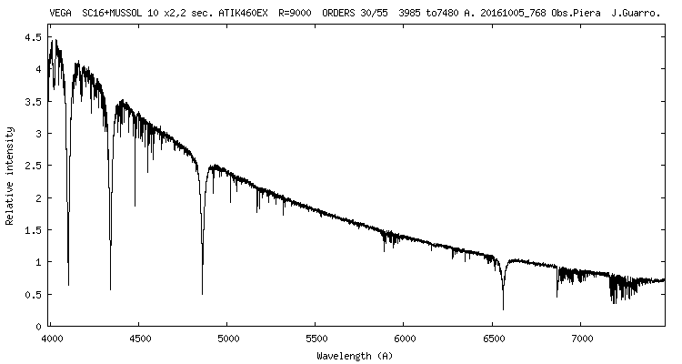

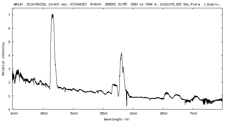

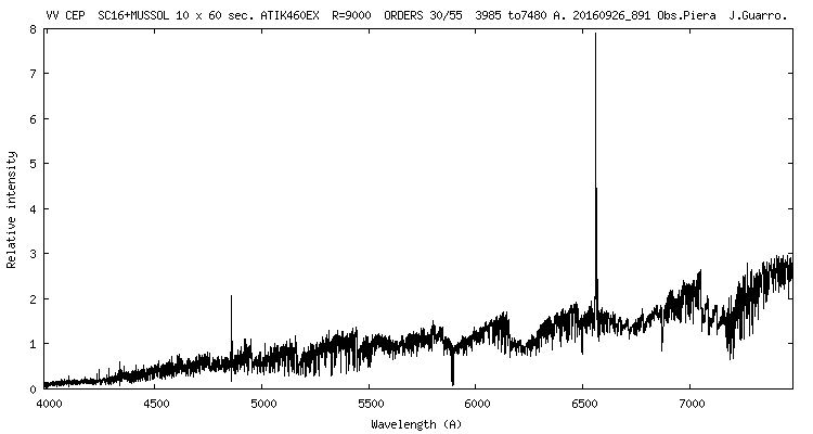

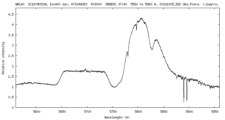

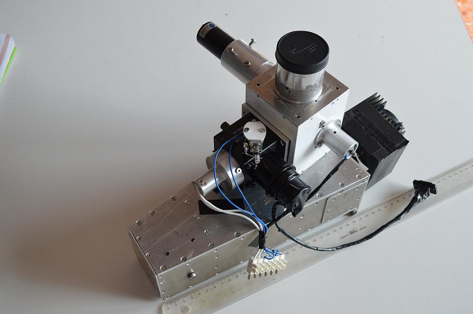

After installing an optical fiber 2 meters long, it seems that the Echelle work, the calibration is accurate.
I baptized Echelle,with the catalan word "Mussol" is translated, Owl, Hibou, Eule, Gufo, Búho.
I thank everyone who helped me, especially Martin Dubs essential for their cooperation and patience when they note the setting and data reduction.
I hope you like it. Sincerely, Joan.
