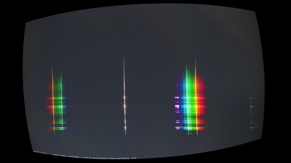

At the moment I analyze a video taken by Koji Maeda (thank you for giving permission to use this beautiful meteor spectrum for illustration of my method) with a Sony alpha 7 with a 24 mm f1.4 lens which gives excellent spectra. Actually I analyze the video frames, but the method also works with the still image as shown below:
original image recorded by Koji Maeda, reduced by factor 4

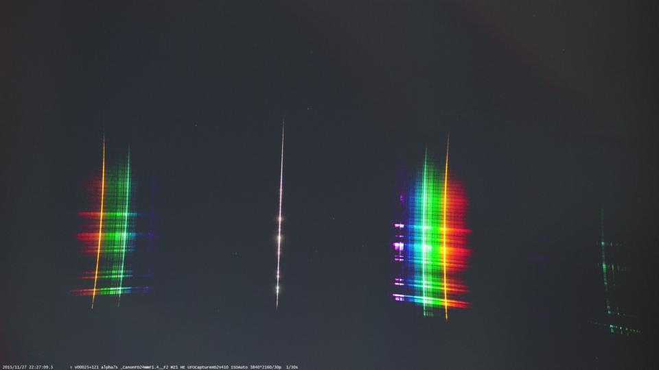

After linearization and rotation (only approximate, still working on it):
linearized with distorsion correction
This can be analyzed with IRIS (ISIS works also, but wavelength calibration is not automated yet).
I find it easier to calibrate when the dispersion runs parallel to the x-axis, a small rotation can be corrected. This was done here.
The direction of the meteor can then be corrected with the slant command (not done in this image, by coincidence the angle was very small, approx. 1°). The advantage of my method is that standard spectroscopy software can be used afterwards to extract a number of spectra with the same calibration. In the original images the dispersion is different for each position of the meteor and the spectra have a different smile, so they cannot be registered and stacked in case of the video frames.

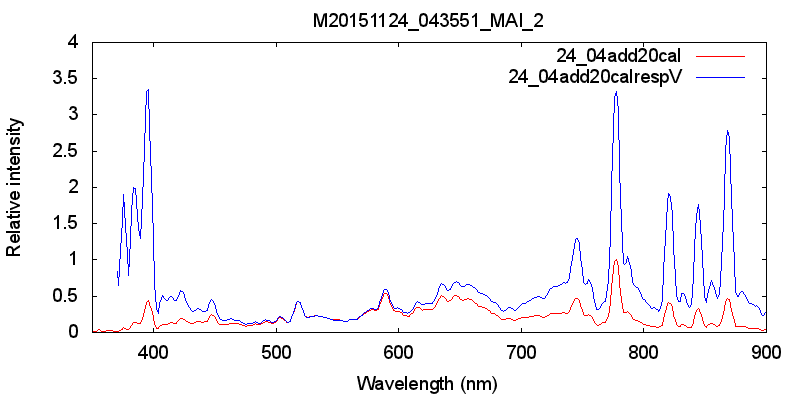

Flat field correction on this type of setup must be difficult. When recording spectra at different positions, have you looked for any potential field illumination effects on the spectrum shape depending on where the spectrum falls?

your question is right on the mark. This is what I am working on at the moment. As you say it is quite difficult. There are several effects which influence intensity calibration:
- grating efficiency
- detector efficiency
- atmospheric extinction
- flatfield correction.
With a video camera (8 bit) you have in addition a small dynamic range, so S/N is usually quite bad. In addition, the meteors do not all have the correct brightness for optimum S/N without saturating the CCD.
With a wide field lens the light falls off quite a bit towards the corner, so a flat field is necessary. I think it is best to apply it from an image without grating in order to avoid higher orders entering from large angles. This should compensate for vignetting and distorsion of the lens which spreads the signal near the corners. In principle the transformation to orthographic projection should also be taken into account but I have not done this at the moment. The grating efficiency is also sensitive to the incidence angle but to a smaller degree. I checked with some calculations. I made some attempts at IR correction, but it is still preliminary:
red: uncorrected spectrum<br />blue: IR applied
blue: IR applied
I used Venus for reference, no atmospheric extinction correction applied (H Venus: 28°, Meteor 31.5°at peak brightness). Unfortunately there is no easy way to check the results.
