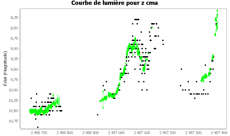

Z CMa in outburst
Posted: Thu Jan 07, 2016 6:04 pm
The Herbig Ae/Be Star is in outburst at mag ~ 8
See previous observations on ARAS Page http://www.astrosurf.com/aras/surveys/p ... /zcma.html
