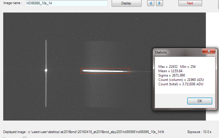

Well almost :) . With the ALPY 200 at mag 8 I normally just use 10 sec exposures. For example here is HD86986 at air mass ~1.5 showing a max ADU/pixel of 22k.
This is with the ATK314 2x binned though to minimise read noise on the faint targets. 10s is enough at mag 8 to give SNR ~100. Only at R~130 though !
