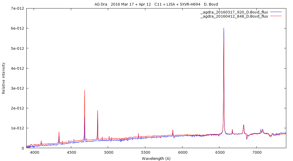

Photometric and spectroscopic observations of AG Dra in March and April 2016 show a brightening from V=9.71 on March 17 to V=9.57 on April 12. The B-V colour index changed from 1.38 to 1.20 over the same period.
Spectra taken on those dates and flux calibrated using the above V magnitudes are compared below and show a corresponding increase in flux on the blue side of H-alpha.
The emission line flux of H-alpha, H-beta and HeII (4686) are as follows (in erg/cm2/s). The flux of He I (4471) is <0.05 H-beta.
March 17
H-alpha 4.7x10-11
H-beta 7.5x10-12
He II (4686) 7.5x10-12
April 12
H-alpha 5.0x10-11
H-beta 1.1x10-11
He II (4686) 1.6x10-11
From eqn 1 in Leedjarv et al. (MNRAS 2016) these HeII/H-beta ratios indicate a temperature increase from ~193,000K in March to ~222,000K in April.
Spectra taken in 2015 show a HeII/H-beta ratio steadily increasing from 0.60 (~161,000K) to 0.76 (~175,000K) between April and October.

Hello Peter,
I am using ISIS to divide out the continuum and measure the line flux. I am not sure of the precision so only quoted figures to 1 dp.
My spectrum on March 2 also gave a HeII(4686)/H-beta ratio of 1.0.
I note that apart from your March17 spectrum you are also seeing a steady rise in the HeII(4686)/H-beta ratio from February to April. Clearly something is happening.

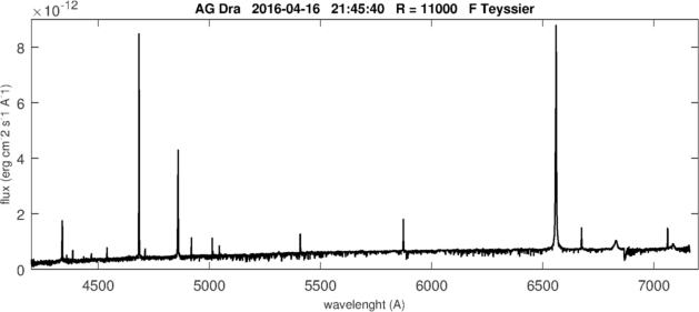

Tonight spectrum
H beta and He II region
A few lines

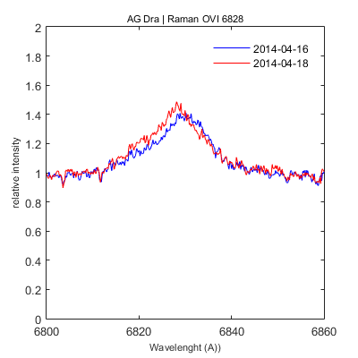

Good results and cadency !
Comparison of Raman OVI 6830 (16 & 18 -04-2016)
_agdra_20160418_831_full_Raman OVI 6828.png (17.57 KiB) Viewed 13773 times
Temperatures
(Iijima, 1981), the same than David used
16-04 : 220 000 K
18-04 : 222 000 K
Formula 2 gives 233000 and 238000 K respectively
Good agreement !
