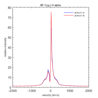

François, thank you for the alert!
I observe yesterday this target. Full profile:
Heliocentric radial velocity of h-alpha line:

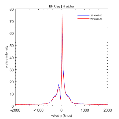

Re: BF Cygni : strong jets
Posted: Tue Jul 19, 2016 9:12 pm
Nice, Paolo !

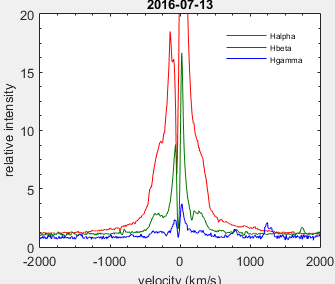

The satellite bumps are clearly seen at R = 5000

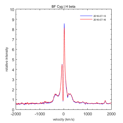

Here's a comparison (13 and 16th of July)
_bfcyg_20160716_951_full_H alpha_1.png (13.52 KiB) Viewed 11534 times
_bfcyg_20160716_951_full_H beta_1.png (13.69 KiB) Viewed 11535 times

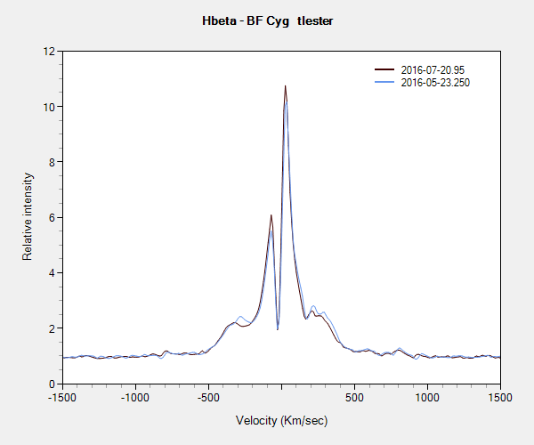

My latest spectra for July 20th at Hbeta (R = 6400) compared to my last result on May 23rd

Tim : very interesting. The outflows appears before June.

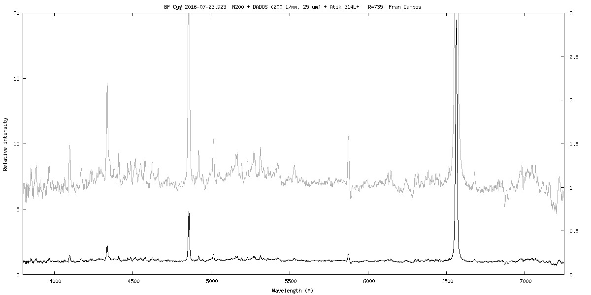

Excel·lent resultat, Joan,
Here is my contribution from last night. Not as good as Joan's one, but I am happy with the result.
Greetings
Fran

You're getting all the juice to DADOS. You could indicate on the charts, the type of telescope, the number of integrations and the exposure time?

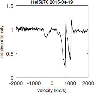

Last night, I could take a spectrum of BF Cyg .
Emission lines of HeI have emerged since my last spectrum taken in September 2015

Bien vu, Olivier
BF Cygni is a symbiotic of low excitation
The temperature of the hot component is 'only' 60 000 K at quiescence.
[OIII] and He II can be observed, faint
During a classical symbiotic outburst, the envelop of the hot star expands and cools
Here's the maxwellian distribution of energy for a temperture of, say, 40 000 K
according to the energy in eV
There's only a few photons emitted by the pseudophotosphere above 24.6 eV : He remains neutral, so no emission lines of He I (or very faint)
He I appears essentially in absorption, probing the strong (stratified) wind from the hot star (about 450 km/s)
Note Na I in faint emission and the complex shape of the absorption, combination of interstellar and symbiotic nebula
