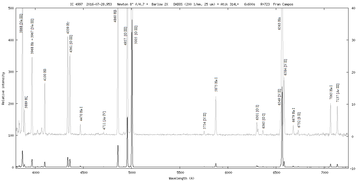

Meanwhile, I have identified almost all the lines of the spectrum of IC 4997, although there are two lines at 4000-4100 A that I failed to identify. Also I see some errors in the position of some bands: for example, the [O III] bands have an error of 2 A. Maybe a calibration error? I have utilised 10 lines of calibration (RELCO lamp). :?:
_ic4997_20160728_953 spec.png (26.74 KiB) Viewed 3891 times
