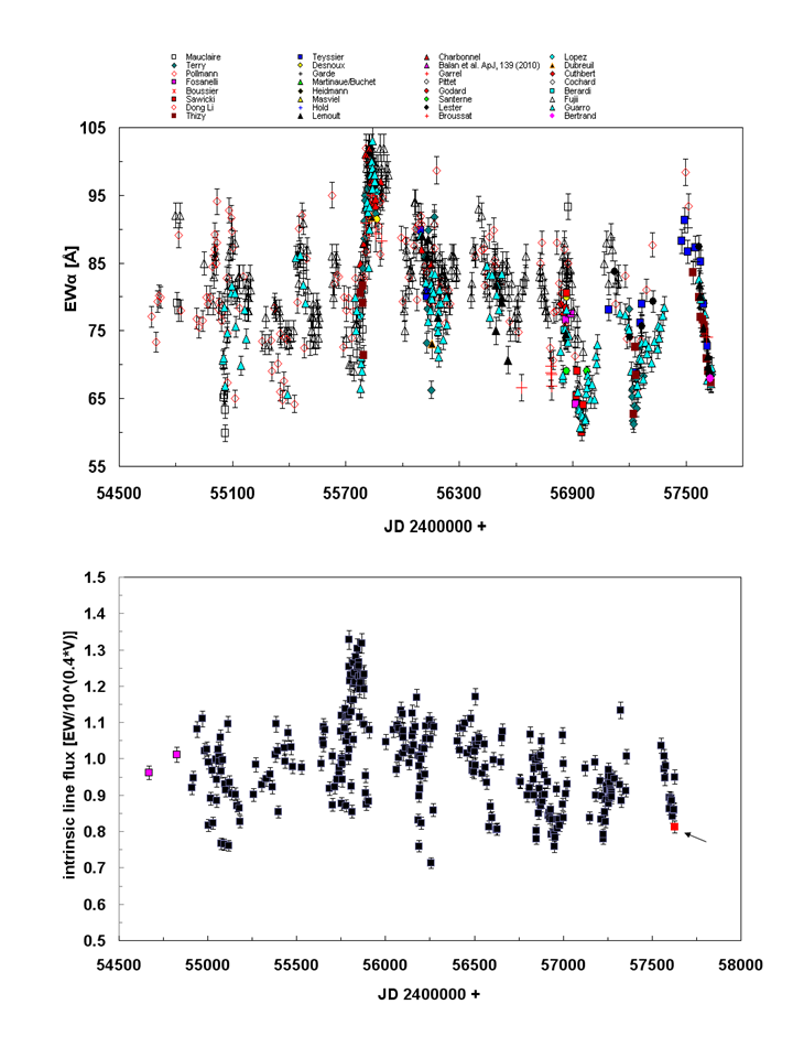

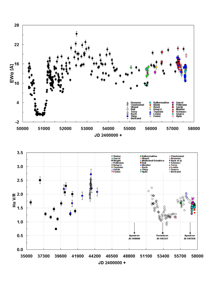

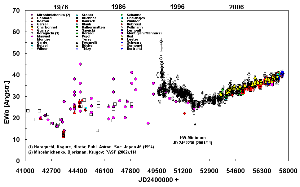

here comes the evaluation.
But I need your geographic coordinates for calculation of radial velocity of gamma Cas and VV Cep.
Ernst
