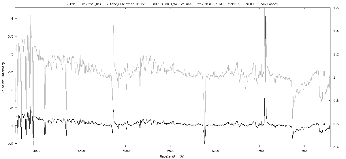

in the AAVSO forum there is an alert about a new outburst of Z CMa (tyoe InA). The star has abruptly raised from mag. 9.7 to 8.4.
After eluding clouds I took the following spectrum. The resolution is low due to a technical problem (I am currently obtaining spectra with R>800) and I'm not sure about the response correction because I utilize HD 56405 (A1 V) as comparison star, but in ISIS I don't have the instrumental response to a A1V star, and I had to use a A2 V instead.
Greetings and clear skies,
Fran

Nice job Fran!

Good job, James,
The SA200 is a fine tool to get spectra from dim stars, specially supernovae... and very comfortable to use, attached in a filterwheel.
Greetings
Fran
