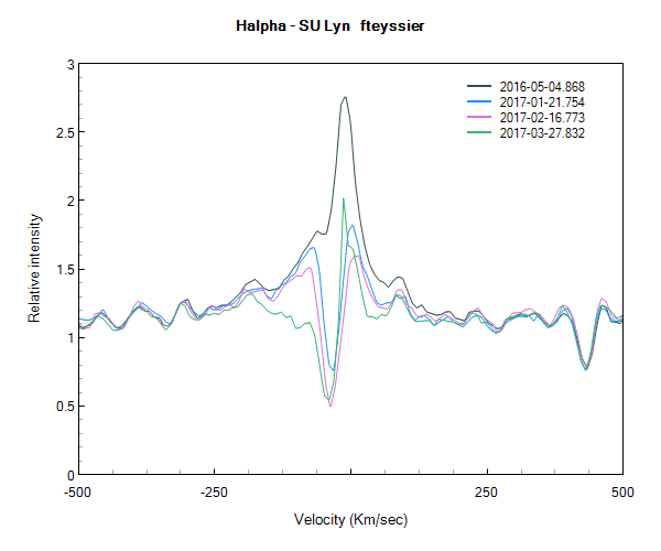

H alpha evolution
sulyn_ 20160504_868_fteyssier.png (29.61 KiB) Viewed 22495 times
Note that Katarzyna Drozd (Nicolaus Copernicus Astronomical Center, Warsaw, Poland) is very interested by this new discovered symbiotic
So, more data are required (low an high res)
Say, at least one spectrum a month (SU Lyn isn'st a very active symbiotic star, looks like EG And, ZZ CMi, with essentially variations due to orbital motion)
Photometry BVR should also be welcome
All the best
PS : don't forget the other main targets.
This is the continuous observations, at the highest cadency as possible, on the long term which are the keys of the insterest of the database

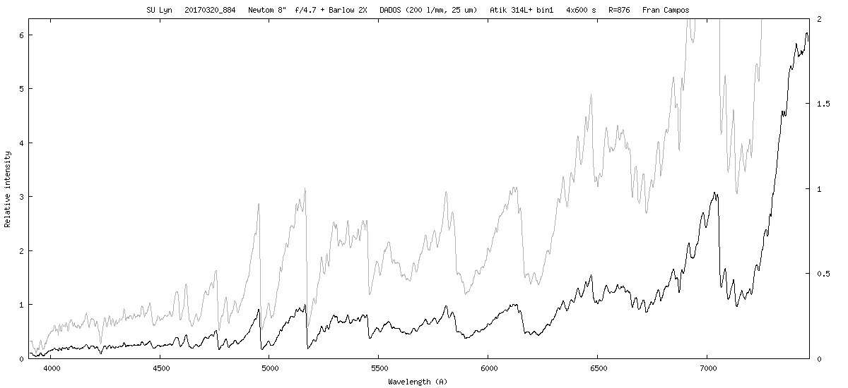

Ok, I will try to take a low resolution (R=800) and a medium resolution (R=6000) spectrum every month. For the moment, here is one taken five days ago.
Salut!
Fran
