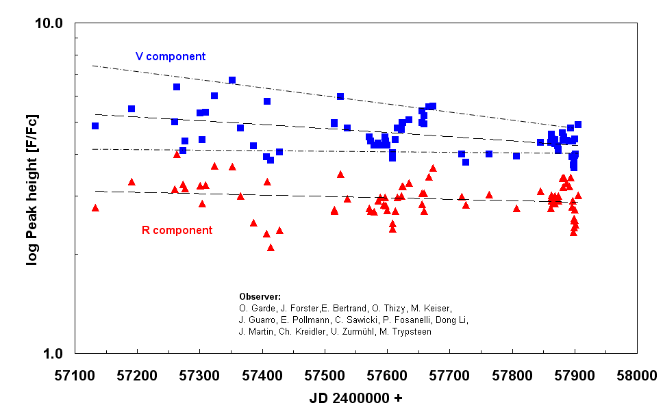

I would like to ask, whether there is a certain interest in a campaign to estimate or calculate the radius of the accretion disk of VV Cep.
High resolved Halpha spectra, how they are currently received by different observers, do provide the opportunity in August this year, to perform such high interesting goal.
At the beginning of the eclipse, we could observe, the different beginning of the decrease of the intensity of the Halpha emission components V and R. Based on radial velocity measurements of the central absorption core of Halpha, one could calculate the effective radius of the accretion disk of the B companion.

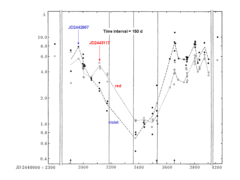

The enclosed Fig. decribes the equivalent widths of the violet (filled circles) and red (opne circles) component of the Halpha emission as function of the Julian Date.
This had been done in the past by Möllenhoff & Schaifers 1978 & 1981, A&A 64, 253-258 and A&A 94, 333-337, and by Kawabata et al. 1981, Publ. Astron. Soc. Japan, 33, 177-188.
It would be great, if this interesting aspect in observation of VV Cep would get a certain attention.

Dear colleagues,
enclosed you can see a plot of the time behavior of the Halpha peak height & equivalent width of the V and R component (from spectra of different observers) in order to get a first impression of the baseline of these emission components out of eclipse. The last measurement in that plot is from April 18th (J. Guarro).
At least the peak heights of both components seems to provide a good chance to determine the exact beginning of the eclipse. The dispersion of the measurements comes from the "natural" activities of mass transfer from the M2 super giant into the B star disk (EW & V/R variability).
The Halpha V&R and V/R are high variable parameters with a certain periodic behavior. Please have a look to the investigation we recently published at IBVS No. 6156:
http://astrospectroscopy.de/media/files ... 156-02.pdf
The source of the variability of Halpha, originating from an accretion region around the hot companion, remains unclear and the time sampling of these Halpha observations are too sparse to permit a meaningful period analysis. See our IBVS publication No. 6198:
http://ibvs.konkoly.hu/pub/ibvs/6101/6198.pdf
The more spectra we collect, the more precisely would be the estimation of the time differences of the V and R eclipse. Comments are welcome!

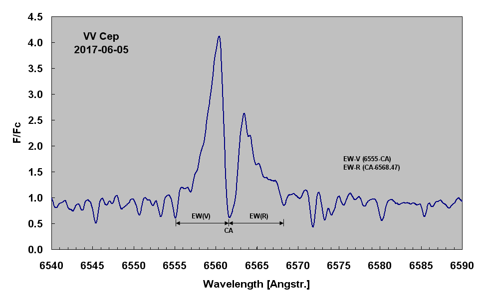

Here's a spectrum taken this morning with ESP (R=30000)
The H Alpha profil.

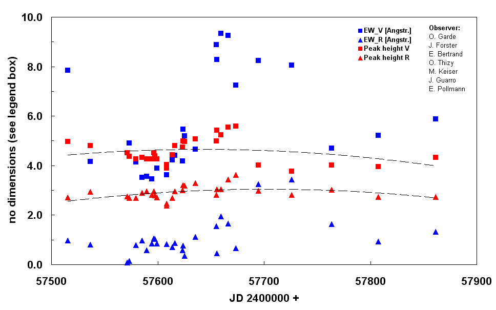

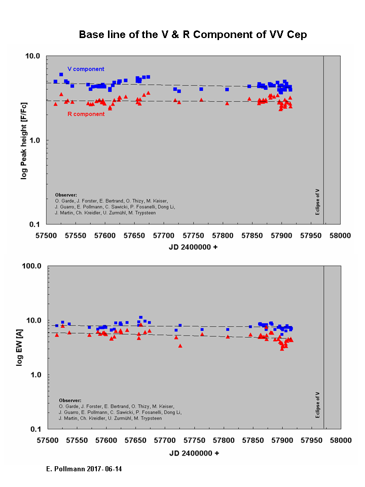

Dear colleagues,
against the background of the VV Cep eclipse, starting on 4 August 2017, an observation campaign during the next OHP meeting would be very helpful. As much spectra as possible during that meeting would contribute to determine the beginning of the eclipse as precisely as possible.
The attached monitoring shows our current effort, to determine the baseline (peak height and EW) of the V and R component before the eclipse (Fig. above)
After a review of the EW evaluation of the used spectra of the different observers with a more precise normalized continuum and a precise wavelength section of both components, this parameter is now useable (Fig. bottom).

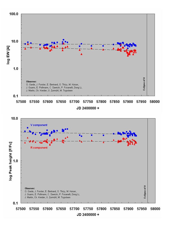

Dear colleagues,
a revision of the analysis of the previous campaign spectra has now led to the use of the equivalent width (EW) of the red and blue components for the determination of the baseline (see attached Fig.)
In view of the immediate imminent eclipse, a well-defined base line now appears for both, the peak height and the EW. At the upcoming OHP spectroscopy session in the last week of July, we will try to improve the quality of the baselines by further observations.
