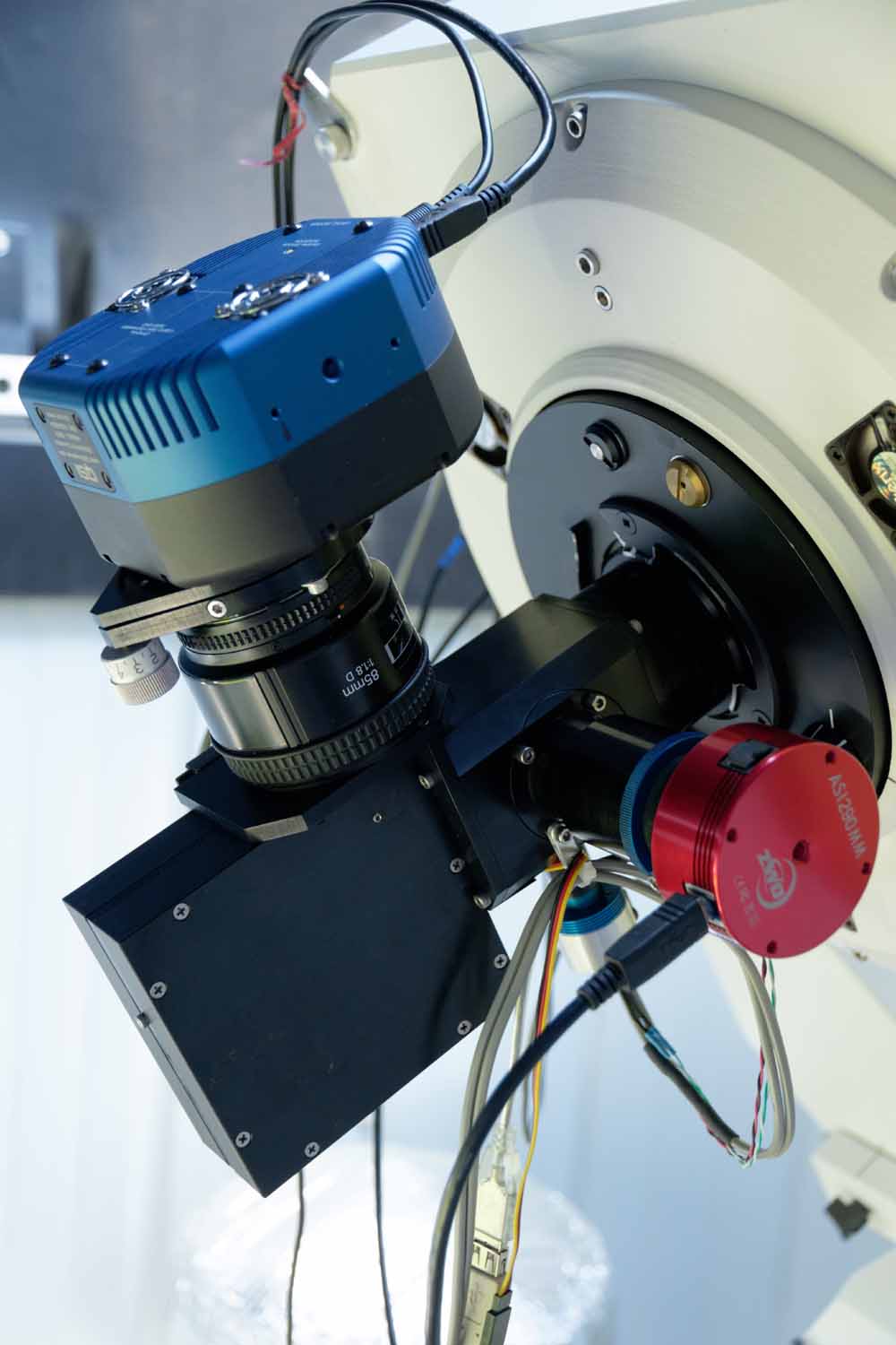

So far indications are that flexure will not be a problem (but it is early days). Here is a picture of it mounted on the telescope.

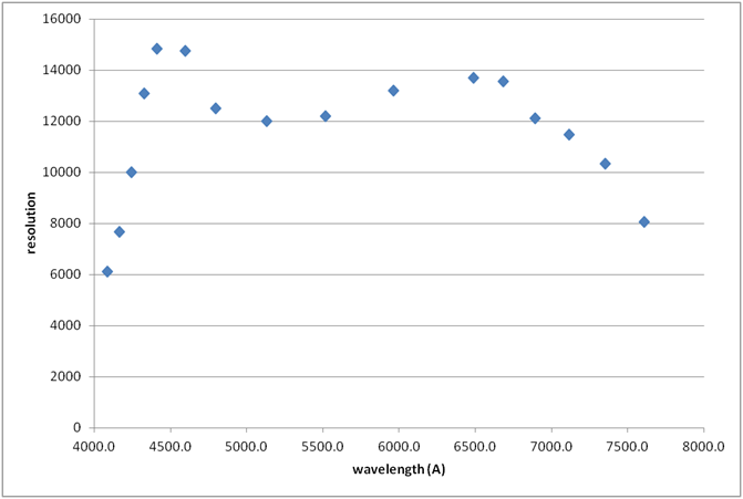

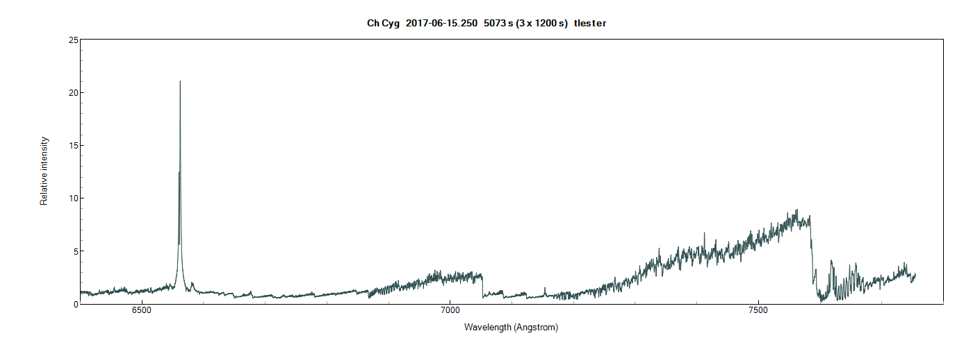

I can cover the spectral range from 4050 to 7750 in one shot and may be able to squeak out even more (the camera lens is the limitation).
Here is a graph of resolution versus wavelength.

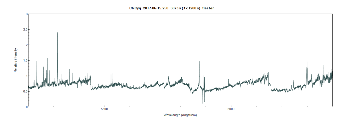

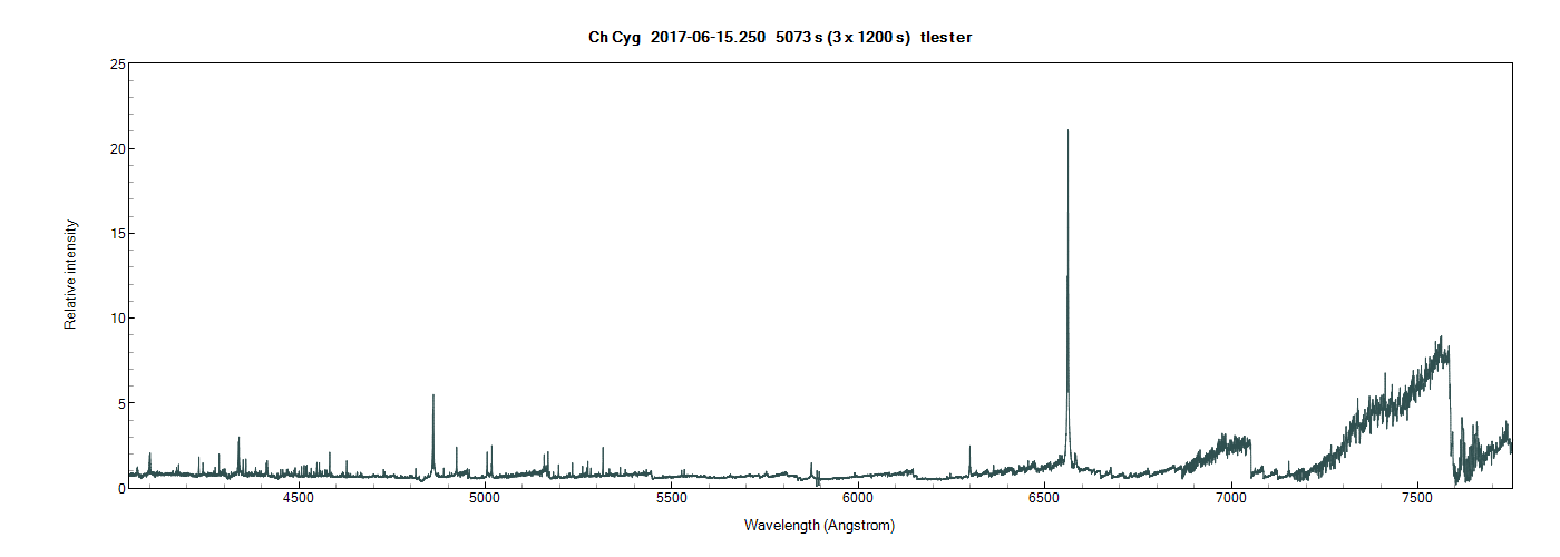

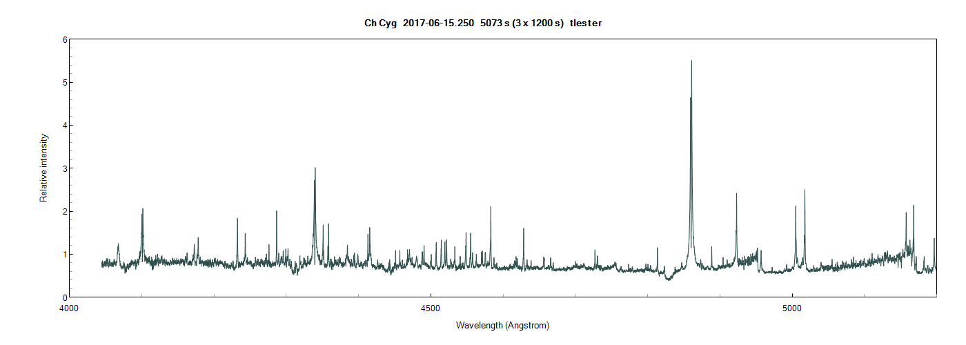

And here are my first real results for CH Cyg.

Very impressive Tim. Could you post some information on the design?
Regards Andrew
Yes, impressive!
Good resolution, good SNR
Congratulations, Tim

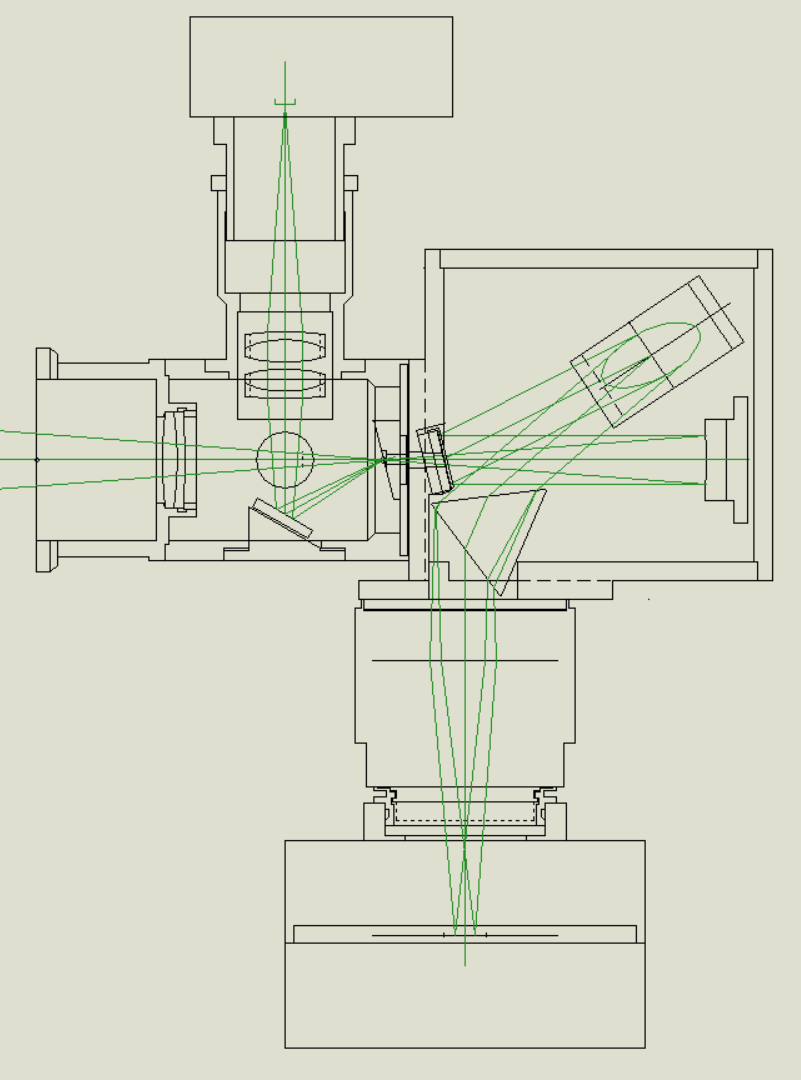

Here is a drawing of the internals. The slit housing is rotated 90 degrees from its true orientation in this view.
I haven't taken a picture of the inside yet but don't want to open it up just at the moment.

A stunning design Tim. The design and workmanship looks to be of a professional standard and could be the basis of a commercial product.
Do you have any problems with the processing with the star being located in slightly different positions on the slit?
Where did you get the perforated flat from?
Regards Andrew

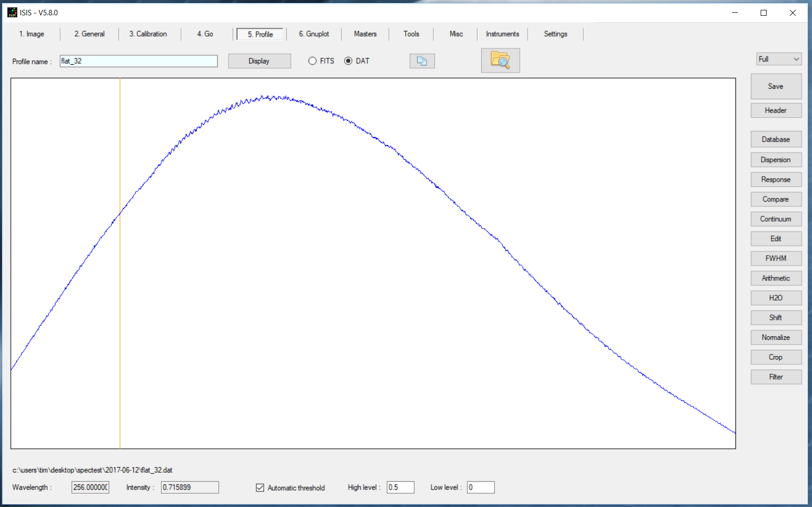

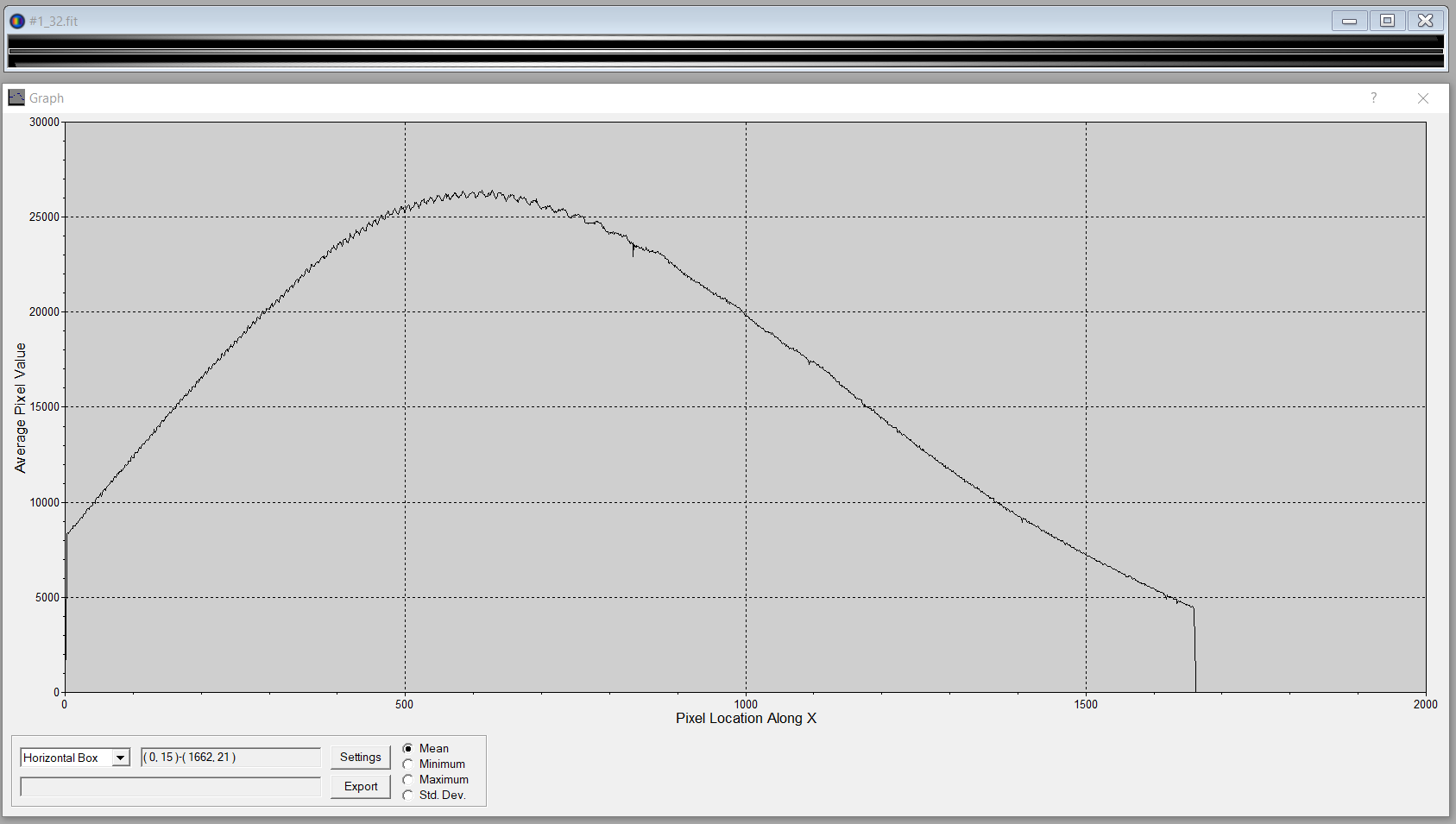

The star image is guided quite accurately in the middle of the slit which produces a Gaussian profile centred on the 75um width. Isis handles this just fine.
However it is another story for the tungsten flats.
Here is the profile for my flat in order 32. Notice the increased noise near the peak of the blaze, right where you would expect less noise!

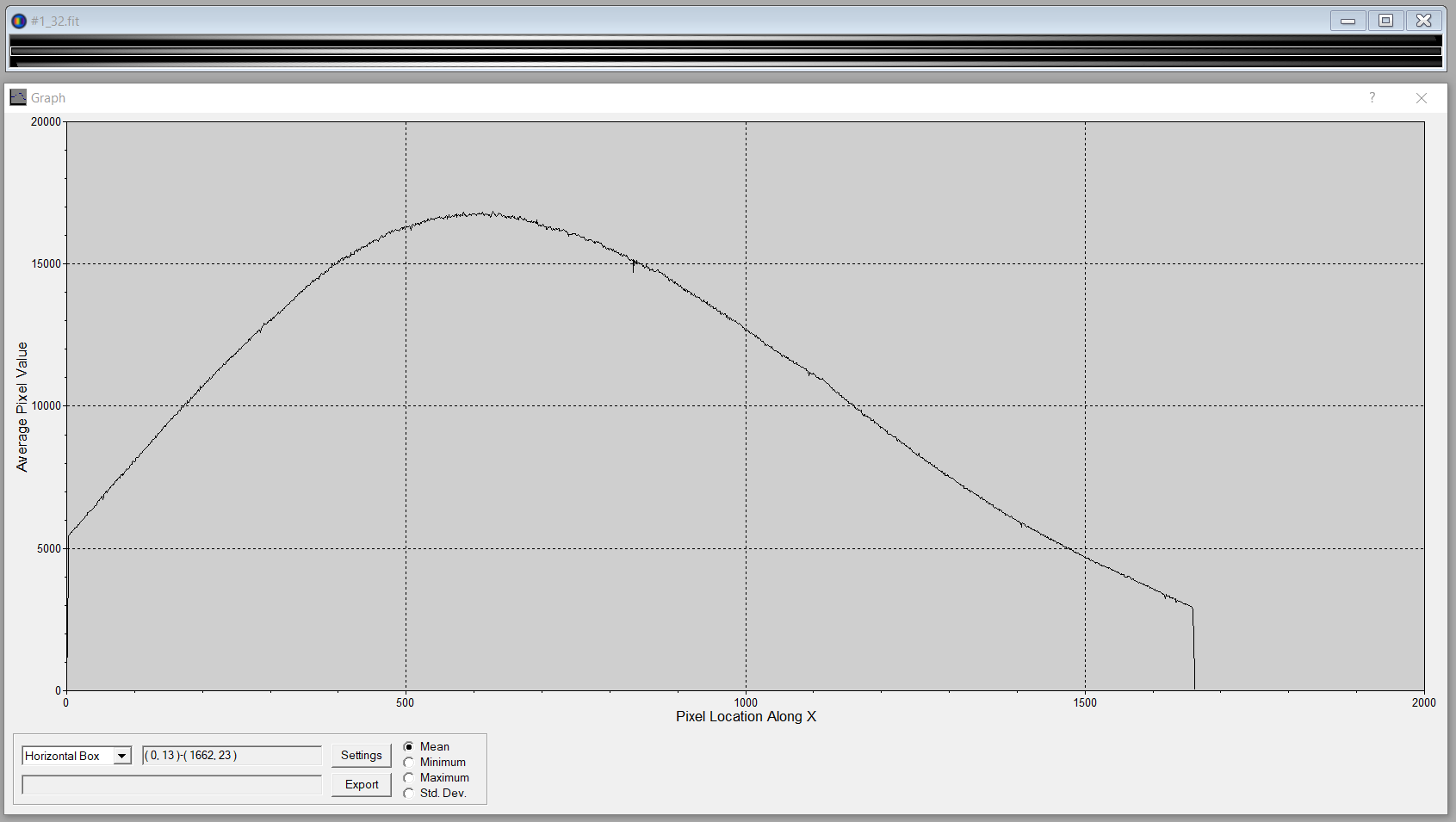

If I generate a profile in MaximDL from the straightened image of the flat for order 32 it is smooth, as it should be.
However, If I narrow the zone over which MaximDL averages then the profile starts to look like it does in ISIS.
I believe this shows that Isis is not quite capturing the whole 75um line width. This makes sense as ISIS was designed with a 50um fiber in mind.
This problem does not impact the star spectra directly because the gausian star profile has fallen off significantly towards the ends of the short slit.
It does, however, affect the accuracy of the blaze function that is generated from the tungsten flats.
Christian - if you are reading this I would be very grateful if you could add to ISIS an option to specify a slightly wider zone over which to integrate. :idea: ;) :D

Hi Tim,
Thanks for the answer.
About flat ripple, did you try to adjust the binning width adjustment option ?
Tim Lester
Posts: 168
Location: Arnprior Ontario
Post by Tim Lester »
Thanks for your quick reply Christian.
I had not fully appreciated what the binning width was but I had set it to 12 which should be a good value in my case.
Looking at the flat images the smallest binning width that would capture everything is about 8 and 20 would start to include the orders on either side (for order 32).
I have tried all values from 8 to 20 and nothing changes. Interestingly order 29 is smooth as are all the orders above 35. The flat plots for the problem orders 30 - 35 do not change at all with binning width. The matching MaximDL profiles generated from the flat images are all smooth.
I tried using an artificial perfectly uniform PRNU file in case a bad PRNU was the problem but that wasn't it.
What next? This is a little troubling. I have uploaded my working directory here if you would like to take a look: https://1drv.ms/f/s!AvXqhKI5kEGRkQbnMJRnLH8EYZyz
