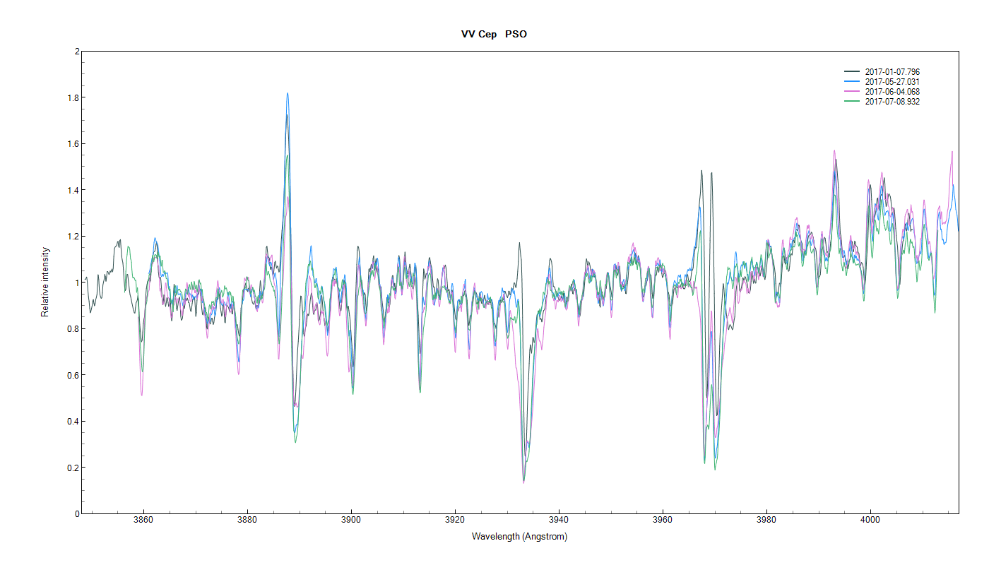

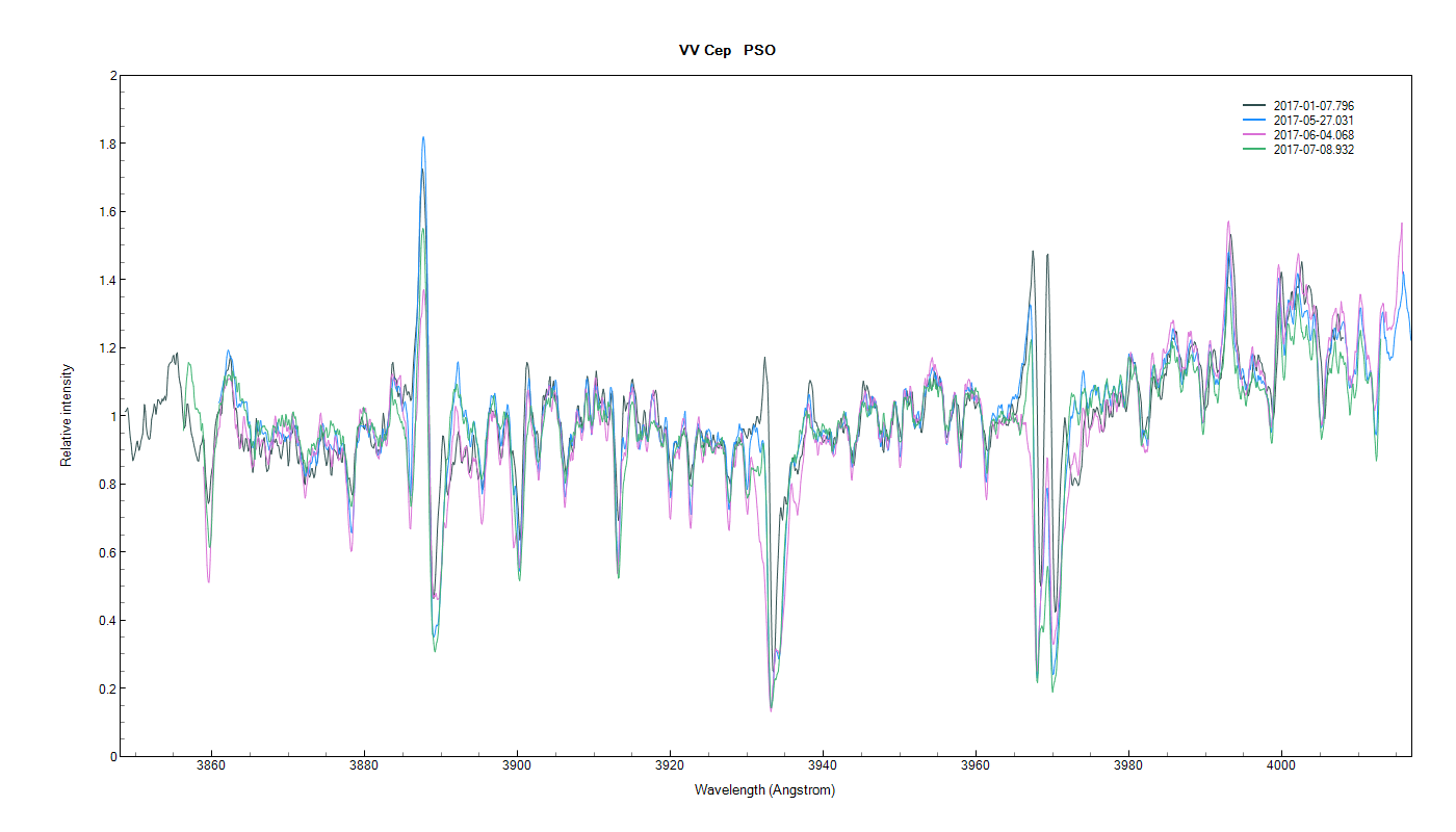

After some observation gap, I've tried my new ATIK 428 EXm camera in the UV with LHIres III 2400/mm grating in order to continue my serie at the same resolution like I have had in 2015 and 2016 autumn:
http://www.spectro-aras.com/forum/viewt ... 3&start=20

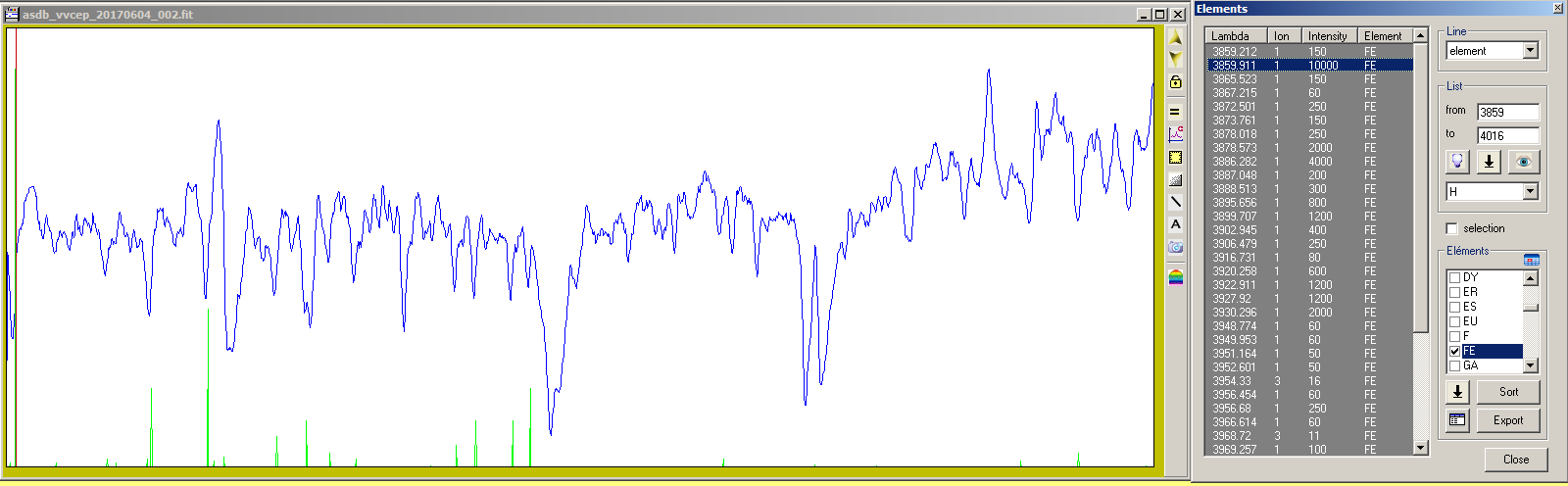

Now I can clearly identify a non-shortterm big increase of many Fe absorptions: (I regret not always including the complex 3859.911 Fe feature fully.)
I don't know for sure, but possibly the Fe notions in VSpec should be Fe I.
Based on 11 spectra - one from 2015 -, not seen any variance before on these lines.
Currently I hope it's not only an exceptional shortterm variation. To make sure, continuing my serie monthly if possible.
To see all my serie in the same range, here my all the relevant .fits, attaching "spectra_vhel_norm.zip" (helocentric correction was necessary) - at this moment I can't see anyone picking these up.
PS.: had to use a "black light bulb" as a flat for the 428 EXm (this camera flat requires special treatment), removing 3 emissions. But, I've checked and it doesn't have any correlation with the Fe lines.

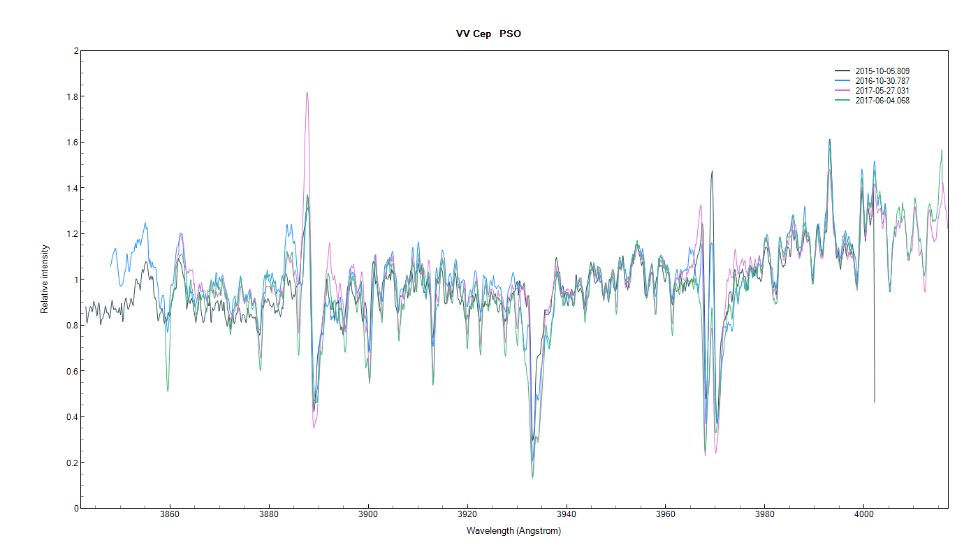

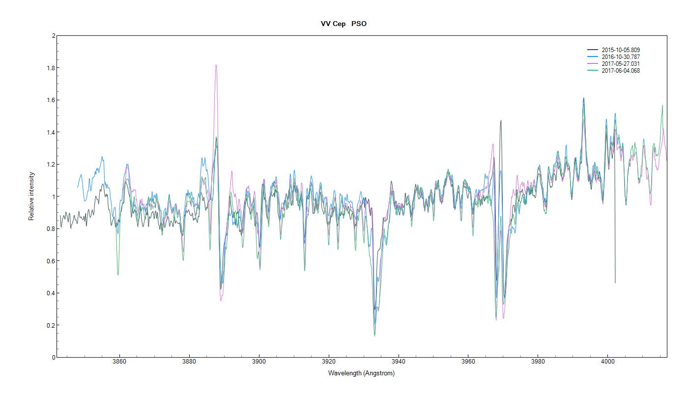

Your LHlresIII 2400 l/mm grating spectra of VV Cep on 4Jun17 had good agreement with my L-200 with 1800 l/mm grating of this object on 08Jul17:
I had to shift my spectra -1.6A in Isis to line up the two; I didn't correct for heliocentric & VV Cep rotational motion. Since I use a lower resolution grating
and a wider CCD (Atik460ex) I get more of the spectrum, abiet, at lower resolution.

Yes, your spectrum looks to me matching somewhat, however your wider and lower resolution spectrum has many spikes where I don't have any (e.g. in the 3915-3921A region where apart from the 3-4 Fe absorptions, nothing should change).
How much ADU did you have in a RAW image at what exposure time and bining, and which slit? At what FHWM? (ISIS => 3. Calibration => Line PSF: I get FHWM=2.87 in the middle)
I've had 1860 ADU (at good times, poor times: half) of a 10 minute exposre (30 cm scope, 35 micron slit, ATIK 428 EXm, bin2x2). Final sum of exposures are always above 1 hour (or 1.5-2 hour at faint times).
I also suggest comparing with the same resolution and f-ratio, otherwise we'd need to extract EWs that is hard to calculate here because the continuum is very hard to define.
On the other hand, these Fe I spikes looks to be pulling back - luckily shot one more between clouds yesterday: So this event might only be temporary, or due to an advenure with resolution (on 20170604.002 had the highest). Peter
