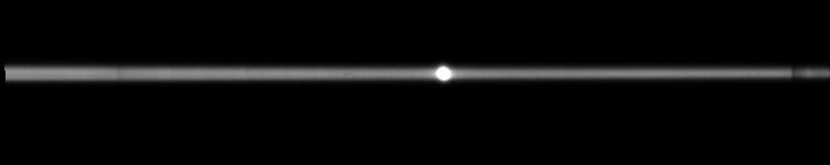

Tonight I am observing gamma Cas. Very interesting B star.

you have a very good osc index, much more better than me. Very good seeing or very good guiding ? What is your focal ?

Great screen shot, thanks :)

Hi Thierry,
thanks. This is my set up:
- C9.25 at F/10
- I use PHD guiding for autoguiding + EQMOD ASCOM for PEC control. The two softwares work simultaneously.
- My ccd to make spectra is SX-MX916 working in bin 1:1 so the pixel have the following dimension: 11.6 x 11.2 um
- To guide I use a guiding scope installed over the C9.25 (see picture). The mount is an EQ6Pro.
- The guide scope focal lenght is 480 mm and the diameter is 80 mm.
- The guide camera is an Orion SSAG.
The seeing condition was no so good because a light cloudy hide the star (not very clean visible with naked eye) + light pollution typical here in Milan suburb.
I can reach much better osc index (0.45 - 0.5) if I have a sky clear, stable and without clouds. EQMOD ASCOM is very important to support PHD on guiding quality. Also the counter weight installed in the Losmandy bar just at the top of scope help a lot.
