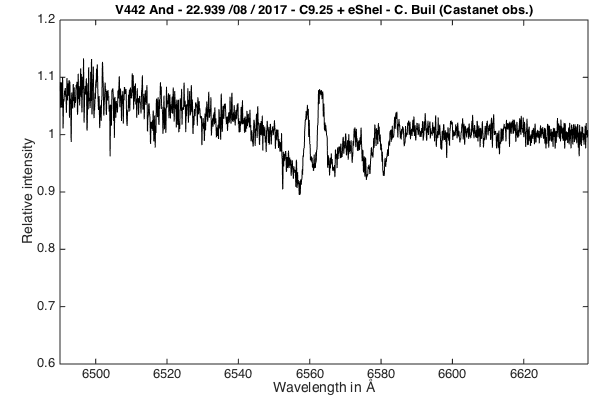

Valérie's spectrum seem to show some faint emission. But evolution is very quick as Christian Buil spectrum taken on the evening of august 22nd shows:

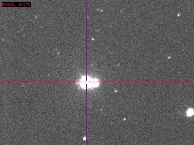

And an overexposed (10 sec) guiding image showing V442 And on the fiber tip (not visible due to too long exposure):

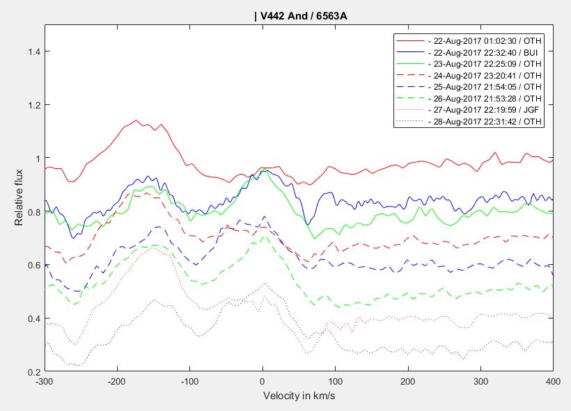

The nice thing about ARAS is that this is a network of observers and when weather is cloudy on one location, there is usually another location with clear sky. Thanks to Christian Buil that observed the bight after the outburst announcement and Joan Guarro Flo whic observed last night, we have data almost every 24h on V442 And. And spectra do show changes night after night - a very interesting target for the moment so do not hesitate to observe it (and upload spectra on BeSS).
Anyway, here is the evolution of V442 And for 8 consecutive nights after the outburst has been discovered:
V442 daily evolution aug21-aug28.JPG (70.44 KiB) Viewed 26718 times
Note that tonight emission is a double peak with the R peak higher than the V peak. Daily changes in the profile are really impressive. Hope data could be useful afterward to better understand the outburst mechanism?...
Olivier

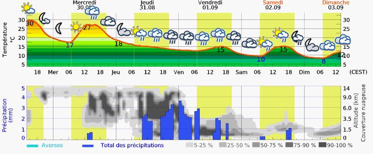

Unfortunatly weather forecast is bad for me for the next few days:
Capture Weather Revel 2.JPG (60.06 KiB) Viewed 26686 times
So I hope some of you can pick it up and observe V442 And every night (high resolution, R>10000 if possible; ideal would be as for all Be stars a SNR>100 on the continuum close to Halpha, personally with 1h exposure, I get around SNR=85 as measured by ISIS using FWHM menu and looking at SNR2 value)... it would be nice to get a good time coverage for the emission evolution and see in few weeks how it evolves, if there is any period (2.615d for exemple, which is the star rotation period), etc... Joan, hope you get good weather on your side! :-)
