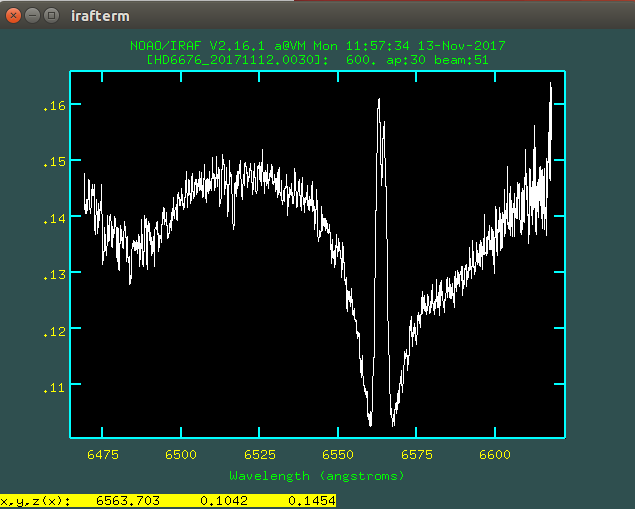

I thought I would try my MRes spectrograph on one of the candidate Be stars I found back in 2014. It is still in emission.

Nice and interesting observation, Andrew

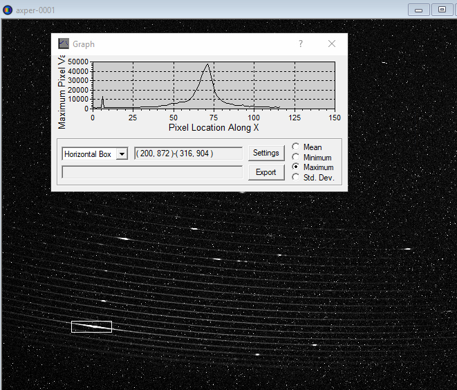

AX Per Mag V = 10.9 , a 600 sec exposure - Looking at [Fe VII] emission
with H a raw profile, almost saturated

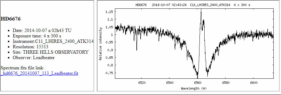

Andrew Smith wrote:I thought I would try my MRes spectrograph on one of the candidate Be stars I found back in 2014. It is still in emission.

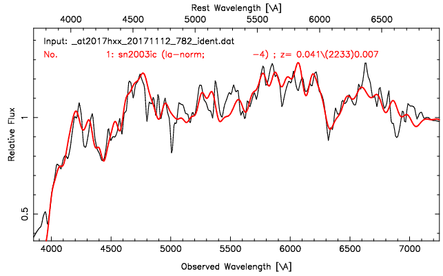

Aha.. That was one of the ones I checked at high resolution back then. Here is a quick screen grab from the campaign page. It does not look to have changed much
No clear skies here tonight but I bagged another supernova classification (sn2017hxx) last night taking me into double figures :-)

Yes I thought the HD6676 spectra were very similar when I checked.
