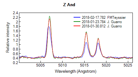

Clear sky

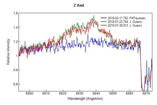

Echelle spectrum following VSNET Alert
In comparison to recent spectra obtained by Joan Guarro
Raman OVI has vanished As did [Fe VII] (at least in comparison to the continuum) Expected behavior for a classical symbiotic outburst
[OIII] 5007, He I 5016 and Fe II (42) 5018 Further observations are welcome

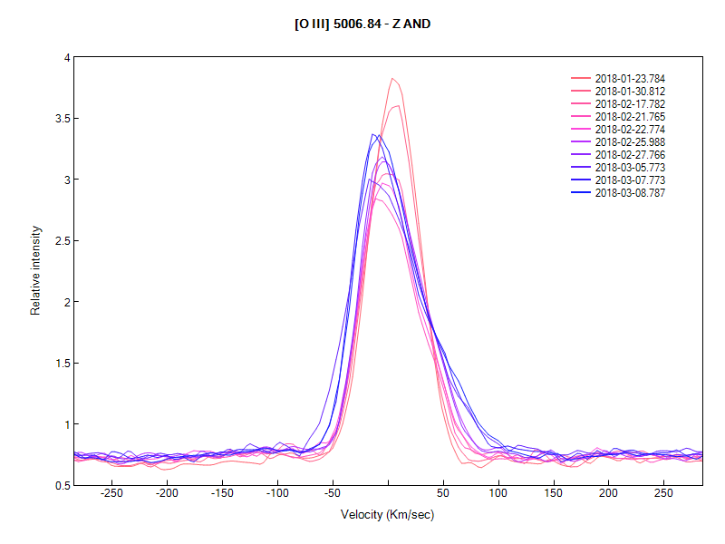

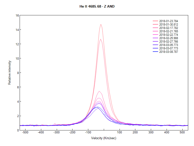

- Posts: 1562
Re: Z And outburst

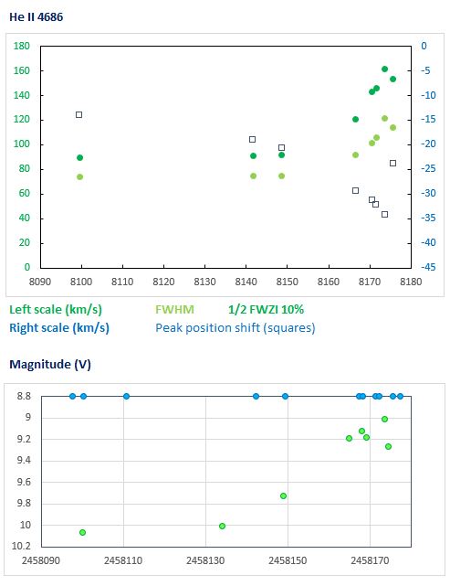

Observations during the outburst
He II line
From echelle spectra obtained by Joan Guarro, Tim Lester and François Teyssier Significant broadening of the line and shift toward blue
Can be interpredted as the result of increasing wind from the hot component
He II line

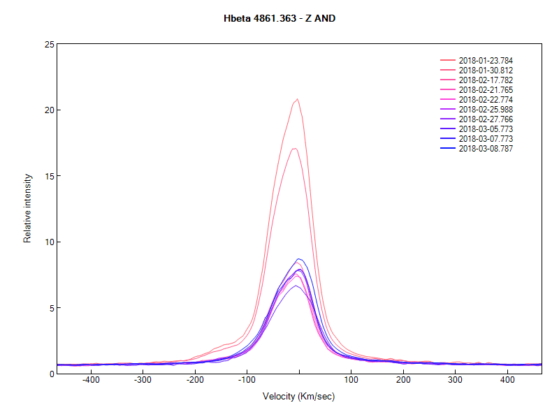

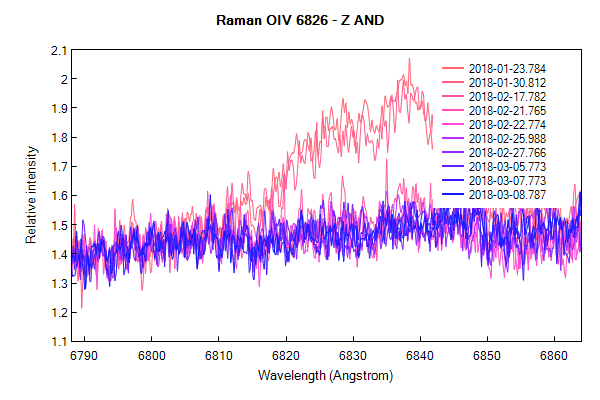

- Posts: 1562
Re: Z And outburst
Monitoring of the outburst, (good coverage despite declining altitude of the star)
Echelle spectra obtained by Joan Guarro, Tim Lester, François Teyssier
corrected for heliocentric velocity
[Fe VII] still weakening Raman OVI totally disappeared at the begining of the outburst Blue shift of He II No satellite lines (jet) in Balmer lines. Unfortunatly, the star is lower and lower

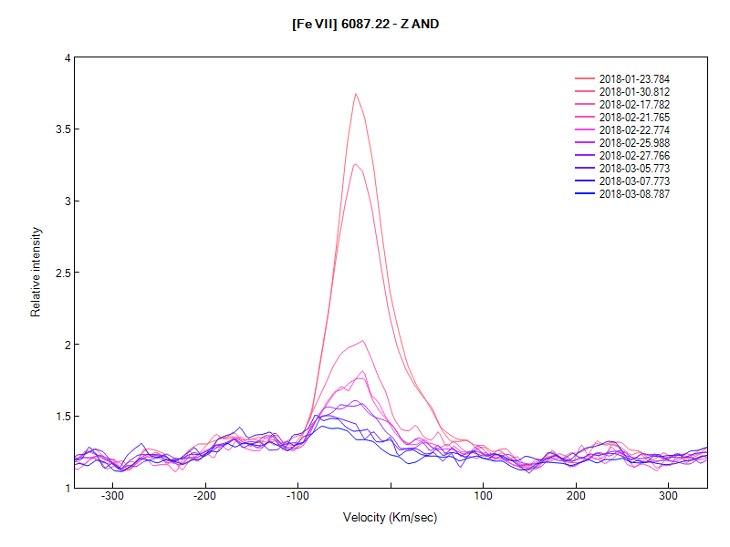

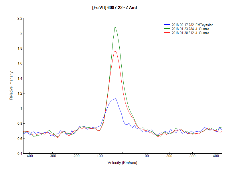

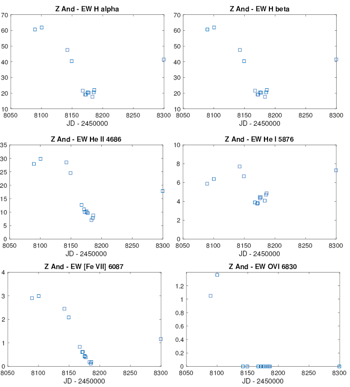

- Posts: 1562
Re: Z And outburst
New observation Z And in the morning sky
[Fe VII] reappears, while Raman OVI reamains undetectable.
EW from Echelle spectra (J. Guarro, T. Lester, F. Teyssier)
- ZAnd.PNG (28.27 KiB) Viewed 41865 times

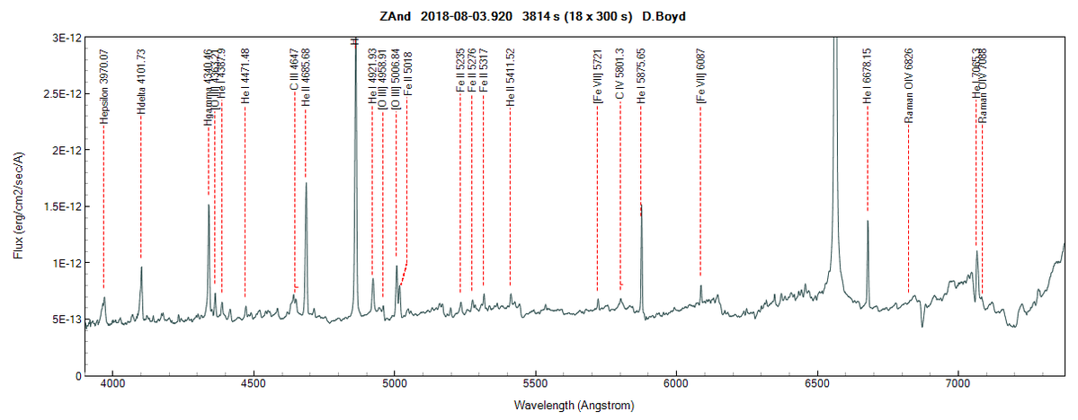

David Boyd
- Posts: 164
Re: Z And outburst

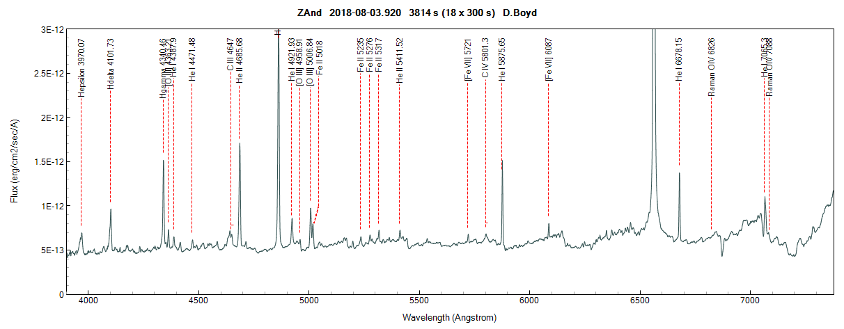

Low resolution spectrum of Z And. Confirms [Fe VII] present but Raman OVI absent.

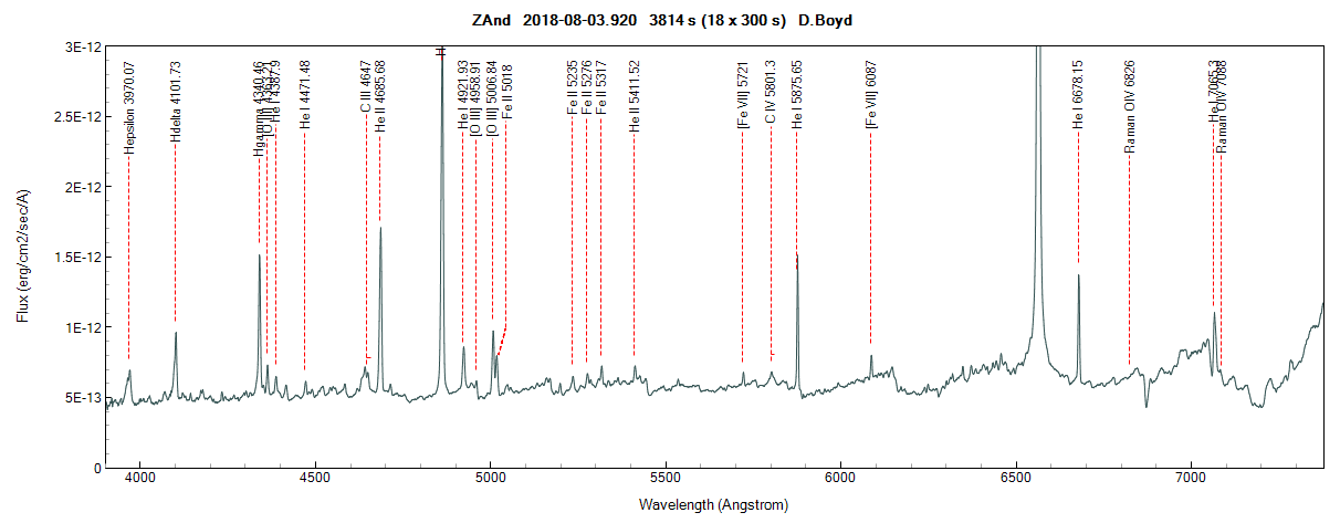

- Posts: 1424
Re: Z And outburst
David, François, a very similar spectrum taken by using a UVEX2 spectrograph prototype (see http://www.spectro-aras.com/forum/viewt ... f=8&t=2085) :
(the jump feature in the UV region is real)
- Posts: 1562
Re: Z And outburst
C'est excellent
On voit bien le saut de Balmer en effet, très intéressant
En plus la résolution est à un bon niveau avec [OIII] 5007 bien séparé de Fe II et He I
Une calibration en flux absolu là-dessus et c'est parfait pour ce genre d'étoile
Bravo Christian !
Bravo Christian !

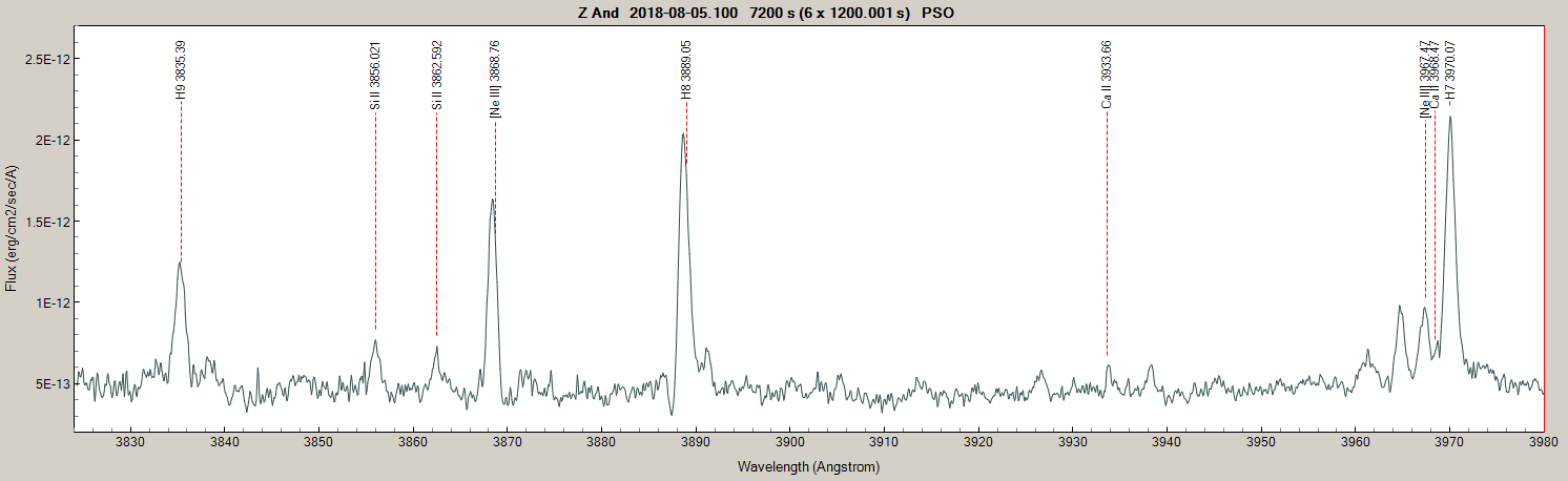

- Posts: 420
Re: Z And outburst
Congratulations Christian for the breakthrough!
By chance, I've also visited this object in the near-UV (12" Newton, LHires 2400/mm, 35 micron slit, R~5500 average) on the weekend: (Flux calibrated with 2-stars method on 15 And (miles), using the wide slit.)
There is a real absorption (visible on all raw images) near to H8, going below continuum. However, I'm not sure whether if it's a P-cyg profile of H8, or just from a different feature (H9 is a bit unfocused, H7 is contaminated - they are not confirming it well).
The Si II annotation needs to be verified, VSpec shown match with 2 strongest out of the 3 lines, and saw these features on F type stars (in form of absorption) mentioned before.
- Peter
EDIT: uploaded the flux corrected spectrum
- Peter
