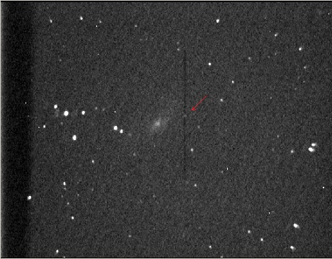

Yesterday, with lucky imaging between clouds, I've caught SN 2018zd, must be around 14 Vmag. Could have done much better with normal sky.
It's located perfectly for northern observers, ideal for Alpy, and can be shot all over the night! (clouds more becoming constant prevented me).
Only 2 of my 9 x 20 minute exposures got good snr, others possibly got taken through varying veils.
See:
http://www.astronomerstelegram.org/?read=11379
http://www.rochesterastronomy.org/sn2018/sn2018zd.html
https://wis-tns.weizmann.ac.il/object/2018zd
It took me a longer time to find it in the wide field view of my f/4 system (300/1200 Newton + Alpy 600 + Lodestar X2 + ATIK 414 EXm):
2.5 sec exposure
2.5 sec exposure

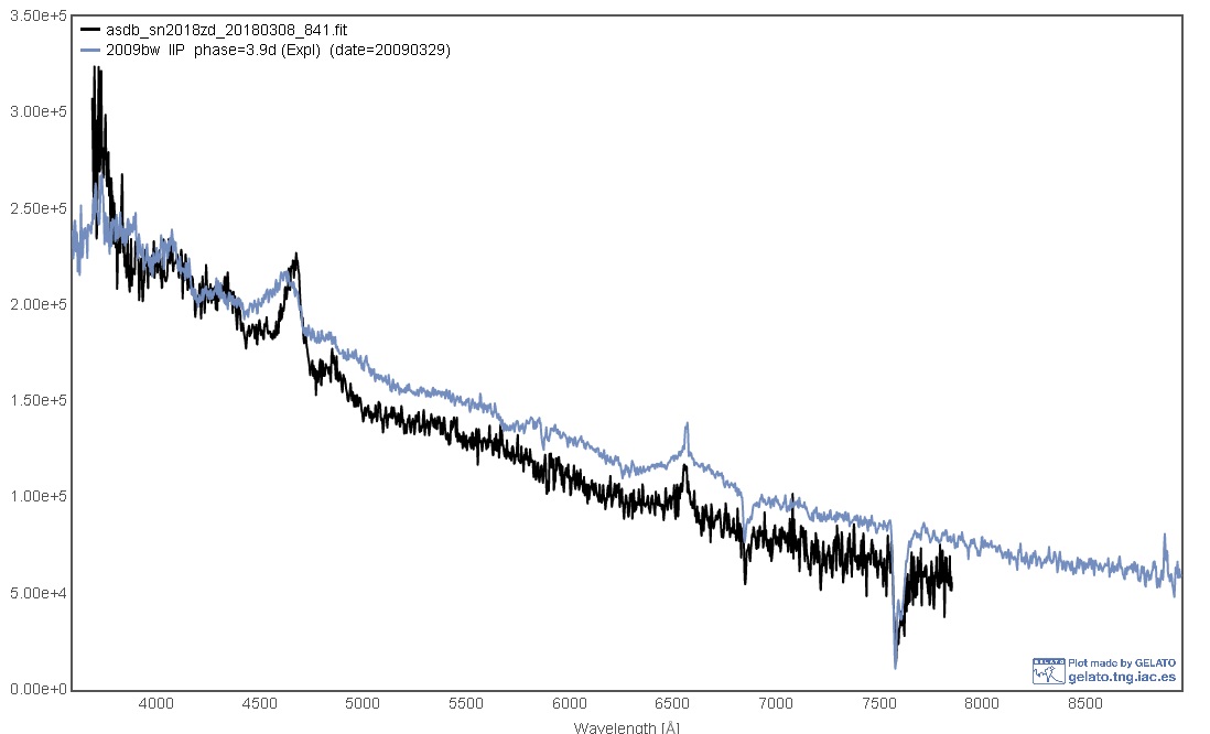

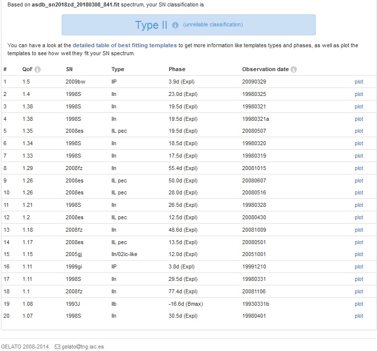

Although ATEL#11379 classifies it as type IIn, Gelato is uncertain for my specturm (I've given NGC 2146 velocity value from simbad: 891 without any sign):
Browsing through the offers, my human look with a few days age prefers a IIp one (despite ATEL's IIn), because only they have such a prominent peak around 4684A (the 2nd peak at 4869A almost vanished on my spectrum):
It's relative intensity, 9 x 20 minute (out of only 1-2 are good SNR, others like a half and less), ATIK 414 EXm, Alpy 600, 300/1200 Newton, 18 micron slit.
The narrow peak at 7102A may be a noise, had weak signal towards the red.
I believe it may me important to re-observe quickly, having so close to peculiar.

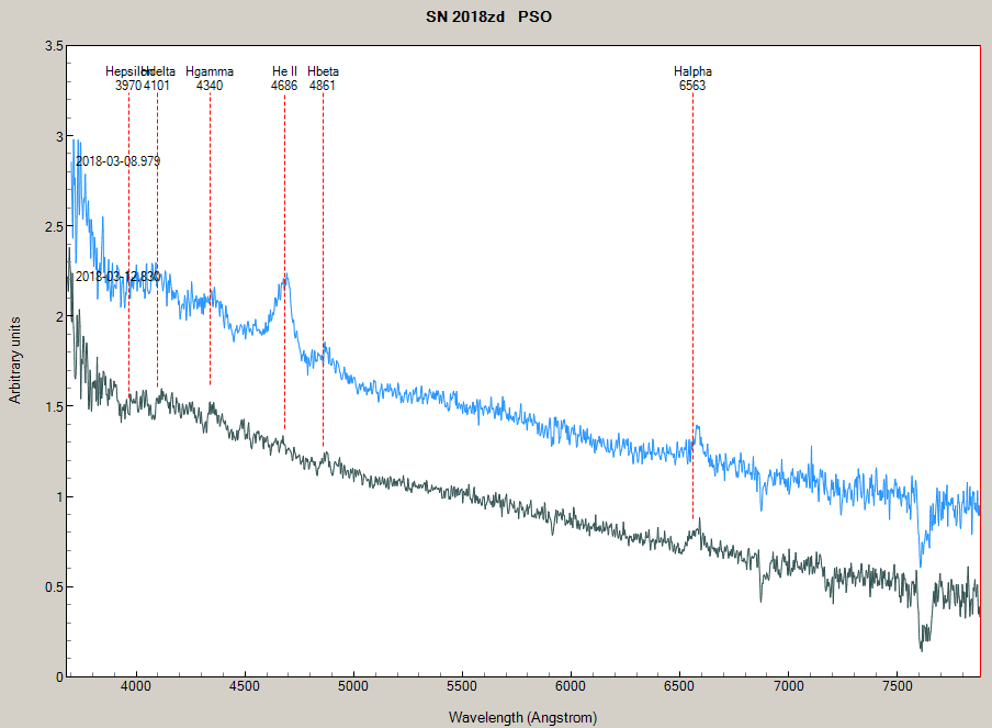

Another shot just from now (10 x 600 s, clear sky but interrupted by clouds, 300/1200 Newton, Alpy 600, ATIK 414, 18 micron slit):
Old (2018.03.08) elevated by 0.5 in PlotSpectra (both normalized for 5000-6000A).
Lot of changes in 4 days:
- HeII 4686 vanished completely
- tiny Balmer P-cygni profiles appear (very roughly at 2-3000 km/s near H-alpha, question where is the 0 point)

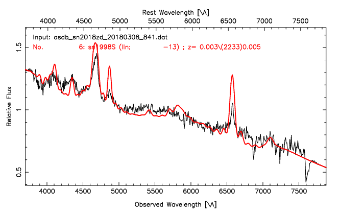

Gelato still claims "Type II uncertain", best offered fit for now is SN 1998S type IIn with 17.5 - 21 days.

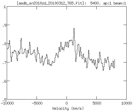

By Gelato, The SN 1998S type IIn has a similarily low velocity, however that's much narrower. Here I think the absorptions are wider and must be well resolved by the Alpy (R~670 average) at the H-alpha, with a rounded shape (not a sharp one). By Simbad, NGC2146 has 891 km/s redshift, so no need to spend another hours for the host galaxy, I guess.
In IRAF, setting 0 point to fixed 6562.7A (no redshift considered) generates this graph:
So I can read a roughly 2500 km/s for which if i add the host's 891 km/s (as a positive redshift I assume), then getting a total of 3400 km/s (rounded).

Here is my contribution from last night to add to Peter's data. The humidity was very high and there were some thin clouds wafting though at times during the exposures. I took 8 600sec exposures of the target. I had a very difficult time finding a Reference star as all candidates other than HD043378 were too far off in air mass from the target. But with HD043378 being so bright I had to take only 10 sec images of which I took 7 in order not to saturate. The calibration looks good to the red side of about 3925Å.
Woody

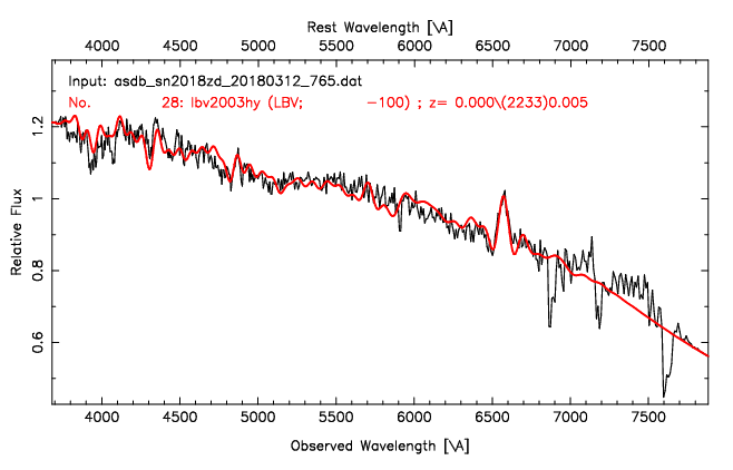

I am also learning as I go along ;-) I ran your spectra through SNID. From the earlier spectrum it confirms a type IIn with good confidence, for example a good fit to 1998s 13 days before maximum.
It was not sure about the second spectrum though. One of the better visual fits is to a supernova impostor (LBV 2003hy)
I looked up LBV 2003hy and found a reference that suggests that, although it was initially classified as an LBV, later measurements suggested it was in fact probably a type IIn supernova
http://adsabs.harvard.edu/abs/2005ASPC..332...86M
