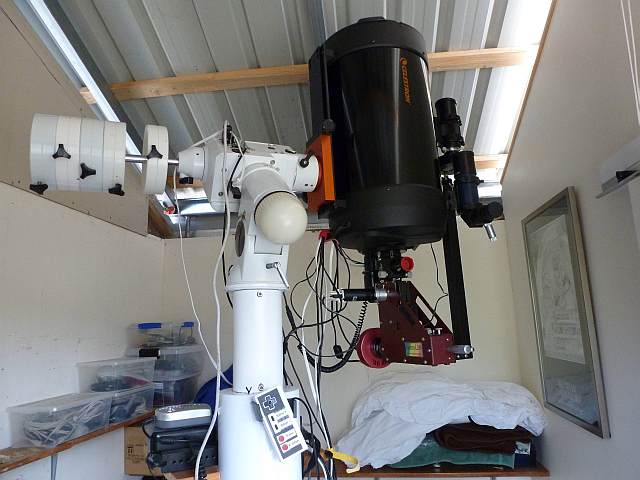

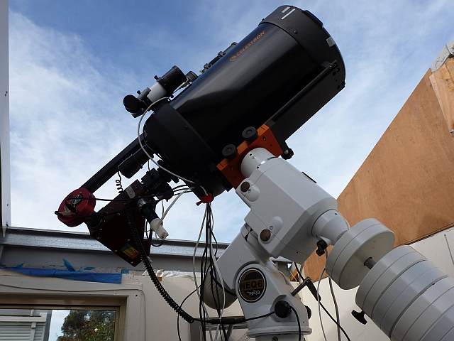

The C11 is a popular choice for spectroscopy and fits well on an NEQ6pro mount.
I use the Spectra-L200 plus ATik 314L on my C11 controlled by a Lodestar guider, using EQMod and CdC.
Mainsail Obs 001s.jpg (64.74 KiB) Viewed 8020 times
Mainsail Obs2 009s.jpg (61.95 KiB) Viewed 8020 times
