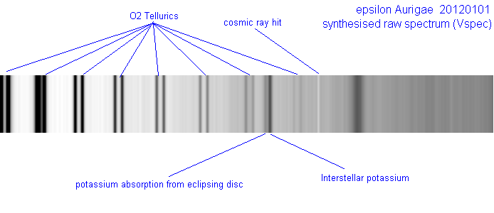

Observing again tonight after a 2 week gap (bad weather and travelling away for Christmas)
The potassium absorption from the eclipsing disk of epsilon aurigae is still just visible at 7699A but very weak now. I predict it will disappear in the next 2-3 weeks but it might still be visible in the Na D lines
eps Aur 7699A potassium line
Re: 2012-01-02 epsilon Aurigae
Posted: Mon Jan 02, 2012 1:00 am
by Valerie Desnoux
Interesting result... Unfortunatly it is raining above Paris.
V;-

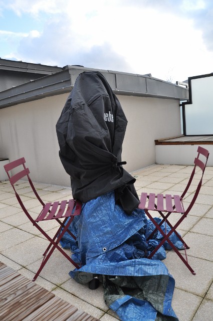

Just back from "castorama" to buy a Weber barbecue protection... It is very efficient to protect a telescope ! at least the mount.
Bache Weber
Bache Weber
DSC_0041 (425x640).jpg (98.4 KiB) Viewed 5032 times
Few minutes later... spectro in paris without spectrograph !
