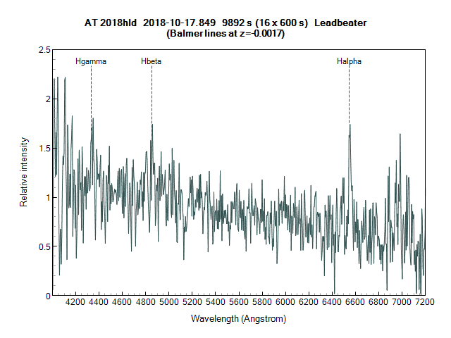

A spectrum taken last night of possible nova AT2108hld / TCP J00420310+4102331
https://wis-tns.weizmann.ac.il/object/2018hld
http://www.cbat.eps.harvard.edu/unconf/ ... 02331.html
At mag 16, this was difficult with the standard ALPY 600. The SNR is only ~10 so probably not good enough for a definitive identification but some Balmer emission lines at M31 velocity (z=-0.0017, NEDS) are clear and there is perhaps signs of a P Cygni profile at H alpha with a velocity of ~1700km/s

Note that the RV of M31 quoted (z= -0.0017) is the local RV of this region of M31, not the mean RV of the galaxy which is quite different (z=-0.001), because of the rotation of M31

Thanks Etienne,
mag 16 is an absolute magnitude of -8.5 at the distance of M31 (ignoring extinction) which is about right I think (perhaps a bit brighter than average)
It would have been much easier with the ALPY 200 but that does not have enough resolution for nova identification.

Impressive shot Robin!
Would it be usefull to remove M31 spectrum to get the pure nova spectrum?
This could make easier to identify nova type, isn't?

Hi Benji
Benjamin Mauclaire wrote:Hi Robin,
M31 is so large that it completely filled the full length of the slit so the sky background subtraction would have already removed the galaxy spectrum.
The problem is the low SNR. The blue continuum and the H alpha, beta emission lines are the only significant features. I looked for Fe II lines. They could be there but it could just be noise. I have decided to announce it as a nova on TNS though. Perhaps someone will take a better spectrum.

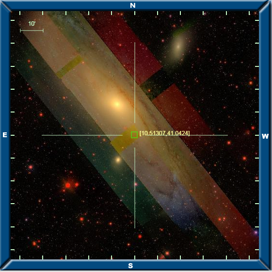

I use the goto controls (eqascom + Cartes de Ciel) to go to the coordinates published for the discovery. I check that I am in the right place by comparing the star field in the spectrograph guider image with DSS images and sometimes also by checking using astrometry.net
I then take a series of 10 second exposures from the guider image and add them to identify the "new star" target. (see attached image)
With a target this faint, I cannot see it in short exposures while guiding so I choose another star in the field bright enough to guide on and measure the offset of that guide star from the target.
I then calculate where I need to place the guide star so that the target will be on the slit and start guiding with the guide star at that position. (It is always a relief when the first spectrum appears 10 minutes later !)
