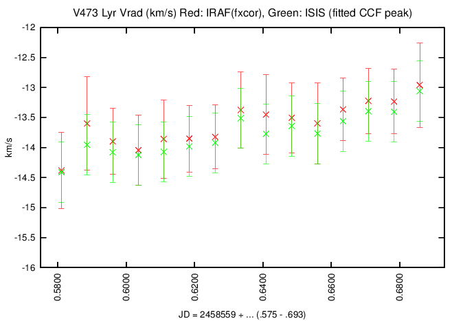

Till this morning, I've taken 14 x 600 sec exposures (300/1200 Newton + 2.66x APM Barlow, internal cal.lamp, 35 micron slit, ATIK 428EXm, bin2x2).
Did take calibration between each exposures (15 sec, + 15sec waiting guide to settle, all automatic).
Calibration: brightest Neon line went up to 22000 ADU, in overall used 7 weak Ar lines + 4 stronger Ne lines.
v473 ADUs varied from 2200 ADU to 4000 ADU when it came higher in the sky.
Tellurics not removed, as did not find any in my range (Vega: before/after).
Did take 45 Dra (+1 mag brighter, matching F8Ib-II spectral type!, known RV), for an easy RV match (allows cross-checking the absolute RV).
Taking 45 Dra (1 x 10 minute, 8000 ADU) has become even more important, when I realized Vega did not show any telluric line in my range (6103-6222A).
It also allows a quick evaluation (matching all the light projection - no need to build an artifical F8 type from library), adding its absolute RV from Simbad (-12.32 km/sec):
RV + AG Dra measured with both ISIS and IRAF/fxcor
This graph contain error information from fxcor, and filled a constant 0.5 km/sec for ISIS (no error estimate other than the graph it produces).
By text, the ISIS fitted CCF peak output (JD-MID, Vrad diff to 45 Dra in km/sec, error):
JD-MID RV diff
2458559.5811 -2.090
2458559.5886 -1.632
2458559.5961 -1.759
2458559.6036 -1.804
2458559.611 -1.751
2458559.6185 -1.662
2458559.626 -1.600
2458559.6335 -1.191
2458559.6409 -1.454
2458559.6484 -1.322
2458559.6559 -1.447
2458559.6634 -1.241
2458559.6708 -1.075
2458559.6783 -1.084
2458559.6858 -0.738
Sum: within this ~2.5 hour, RV increased by roughly 0.7-1 km/s (min. 0.5). If can trust 45 Dra (Simbad), absolute Vrad is provided on the graph. Otherwise, need to find artifical spectral type from somewhere.

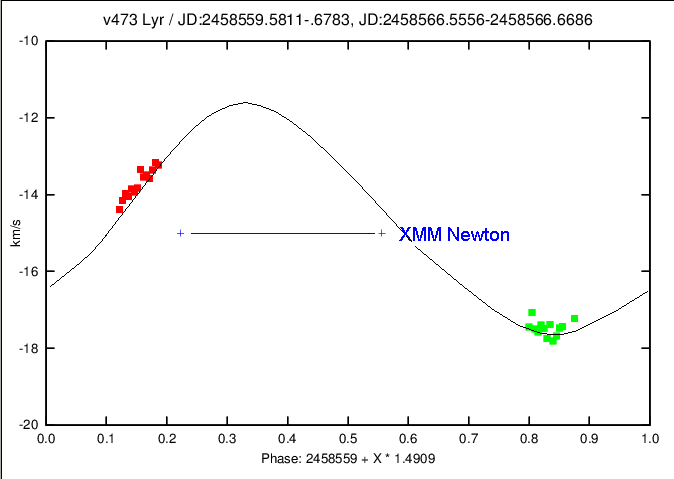

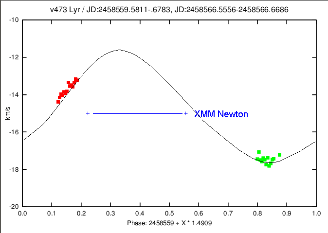

Summary
XMM-Newton has made a non-detection.
Only I was doing RV spectroscopy during this campaign, there was no professional followup.
Showing on this illustration containing my 2nd day of observation (2019.03.24 morning as green, the red what was already published):
the start of the period is self chosen (arbitraty)
Used IRAF/fxcor output here, all telling RV error was between 0.55 - 0.8 km/sec.
Template star I've been using: 45 Dra of both night. Unfortunately, found 1.1 km/s shift between the 2 night's 45 Dra.
3 possibilities for this error (I'm uncertain which can be):
- real RV shift
- error of 45 Dra measurement itself
- error that is correcting optical path difference, so it fixes shifts for target star (= my wishful thinking)
A 2nd way of processing using synthetic spectrum would be another choice - but having no others spectrum to confirm, so skipping this for now. I believe at least, the relative RV accuracy of 0.55-0.8 km/sec within 1 night should be OK (valuable as a gradient).
The curve was drawn by me (bezier curve) by free hand as a speculative illustration - using the average RV (~ roughly -15 km/s) information from earlier papers.
Blue line is representing the real XMM-Newton coverage (I've extracted from the public log), where there was no outburst (told me by profs).
Photometry was also collected from others, that is still under evaluation by professional - independently from this assessment.
