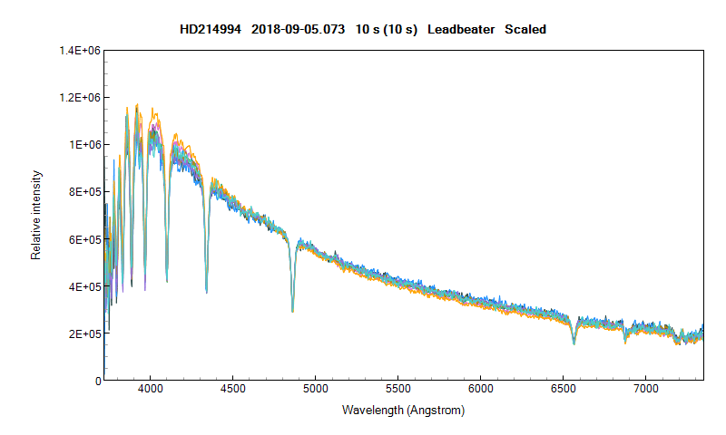

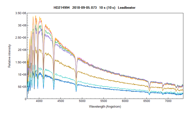

I found some measurements of a reference star which I made under variable cloud conditions. The flux in the individual exposures varies by a factor of over 3x but after rescaling the spectra agree to better than +-10% so it would seem calibrating in relative flux is possible to reasonable accuracy even in extremely poor atmospheric conditions. (see the attached plots)
