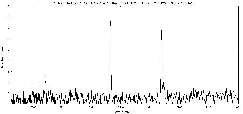

During vacation + 2 clear skies, I've made further experimental progress on this area.
On 04.15, I've been shooting repeats of stars Christian mentioned, attaching as a zip (so everyone can compare). No heliocentric correction made.
One of the interesting repeated star of SNR perspective, but here with the LHires + 35 micron and a 12" scope:
As one can see, H7 and H8 peaks also present. Continuum available reliably only towards 4000A.
On the other hand, aavso has started a project for such of these stars, see:

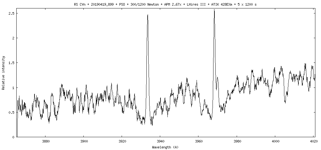

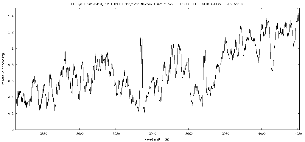

From yesterday(04.19), two of these targets (none of them easy):
In case of BF Lyn, H & K emission cores are well separable (depending on period), coming from the binary components.
H7 or other emission also present (requires deblend procedure to measure).
I have started a process getting through a 1st validation at aavso (unsure when to happen - and what else required), so pls take all of these quick results as preliminary / demonstrative.
I was using ref.star from Pickles (order 3 polynom everywhere), using BLB flat in 1D (removing few emissions), doing Ar/Ne lamp. Made no heliocentric correction in these examples.

However, in 2.3 it is clearly stated that " The spectral subtraction technique provides better results when..." - something that applies for BF Lyn - e.g. multiple lines to deblend require precise continuum, and the widened absorptions (high rotation) require careful treatment.
Moreover, the measurement difference is multiplied when the EWs are bigger (Fig.1) - and to my practice, what I see on that graph, that difference is quite relevant.
Although the EW is resolution independent, the measurement trivially isn't - there are errors that must be analysed and treated, e.g. seriewise correction to fit the lower to the higher resolutions serie, or injecting assumptions about continuum or other accidentally included features - e.g. here: H-epsilon - and test the injected theory.
