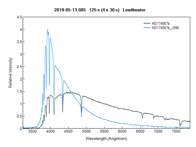

Hello Christian,
It looks like the approximate Planck curve correction for the temperature of the flat lamp has stopped working in ISIS v5.9.6. Here is the same spectrum (wavelength calibrated but not instrument response corrected) processed in v5.9.3 and v9.5.6. David Boyd is also seeing the same problem

Sorry, can more specifically indicate the procedure you use, what are the functions and parameters involved.
Re: Possible bug in ISIS 5.9.6
Posted: Tue May 14, 2019 12:40 pm
Hello Christian,
It is the standard reduction using the ALPY predefined wavelength calibration mode. See the attached screen shot of the general tab and the xml configuration and log files in the zip file. I think David Boyd was using the LISA using a file mode wavelength calibration. The two spectra were produced using 5.9.3 and 5.9.6 with identical setups. The ratio of the two result is a 2700K Planck curve. See the attached comparison.

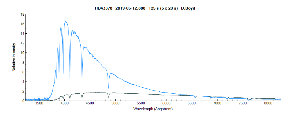

Here is my experience of trying the new version of ISIS 5.9.6.
This plot shows the result of the first step of processing LISA raw spectrum images to produce a dark and flat corrected profile but without response correction produced by 5.9.3 (black) and by 5.9.6 (blue). I use a .lst file to wavelength calibrate.

The ISIS code was changed during the update 5.9.4: I deleted the correction by the Planck curve during this update for the automatic processing because problems appear (consequences of other modifications, it would be a little long to explain here). It is now necessary to carry out this correction manually if necessary.
I will publish in a short time my UVEX spectra processing procedure, which of course adapts to LISA / Alpy. We will have the opportunity to discuss this important subject ...!
