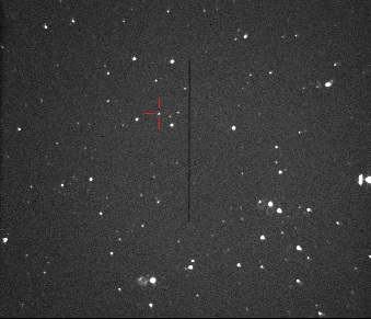

Fresh result from last night, switching to the Alpy setup quickly when received the vsnet-alert:
star choice in the red cross

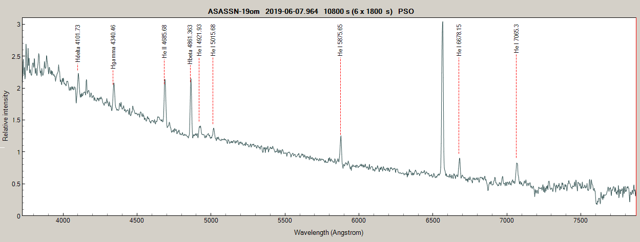

6 x 30 minute, 300/1200 Newton + Alpy 600 (18 micron slit), ATIK 414 EXm camera:
Strong and narrow Balmer and He I lines + HeII 4686 present, but the continuum is CV-like.
Uploaded spectrum to britastro specdb (https://www.britastro.org/specdb) under the name "ASASSN-19om".
Re: AT2019hau - Possible nova (mag 14) in Cygnus
Nice spectrum on a faint target, Peter!
Yes, the continuum looks to that of a CV.
But the emission is inusual for a CV in outburst, the lines are faint, no absortions ...
Nova: The He I and (then He II) appears about two mags after the maximum ; there's no Fe II lines which would be the case for a low speed nova (with narrow lines)
It looks to be a symbiotic in outburst (TiO bands overhelmed), with a strong interstellar extinction (thus strong blue continuum)
New spectra are very welcome!

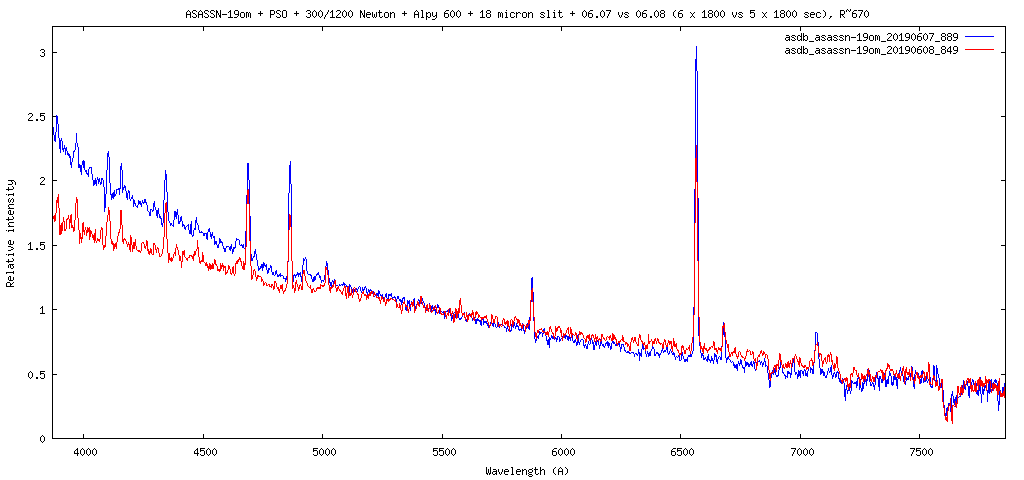

Glad to see it's an interesting object, yesterday night made a repeat with the same setup:
I believe the target has faded a lot, hence the narrow spikes should be coming from noise on the new spectrum.
Verified also the continuum's blue fade validity (taken Iot Cyg 3 times in a before-mid-after fashion, starting at beginning of the night in both cases).
Uploaeded this new spectrum to britastro specdb.
Meanwhile received a comment from Steve Shore (for 1st spectrum):
"I'll bet a cataclysmic, likely a VV Pup-type system, perhaps an AM CVn
or AM Her. Very low extinction (no hint of Na I), and the Balmer lines
are pretty opaque."

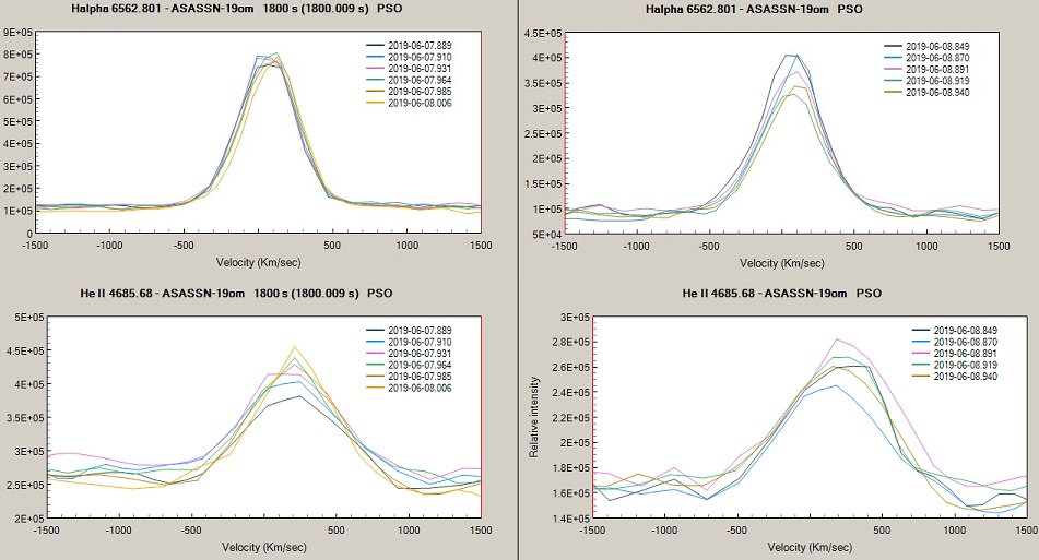

@Peter - Can you see any sign of an eclipse in the emission line strengths between the individual exposures ?
Hello Robin, no I can't find anything conclusive (besides the fact that of course, the intensities vary):
(In raw ADU unit, no response calibration - except flat/bias/dark, and disabled cosmic ray removal for this graph)
Other lines too noisy or obviously inconclusive to show.

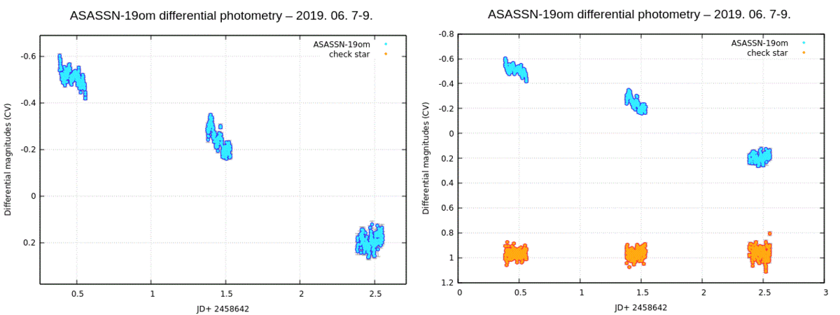

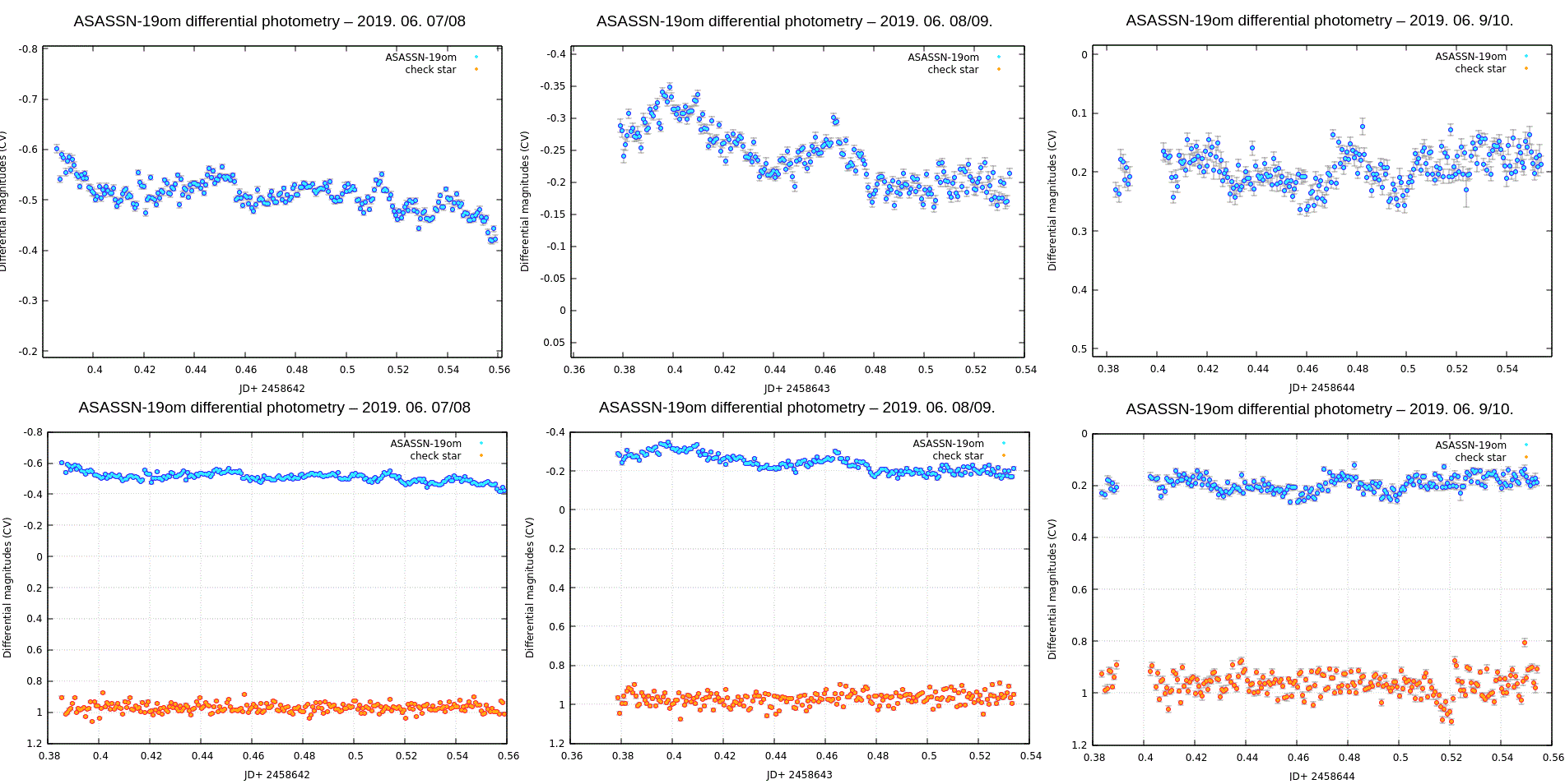

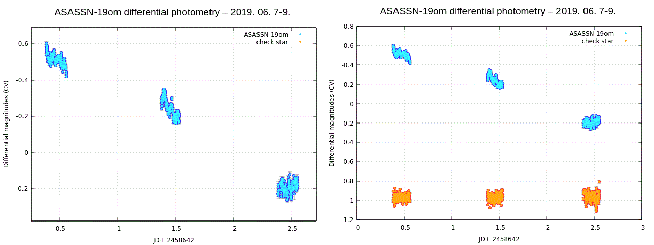

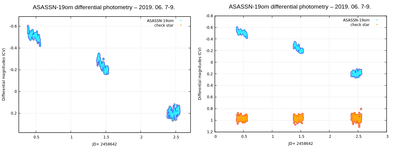

I've asked Tamas Tordai to prepare his simultaneous observation serie, covering also my time.

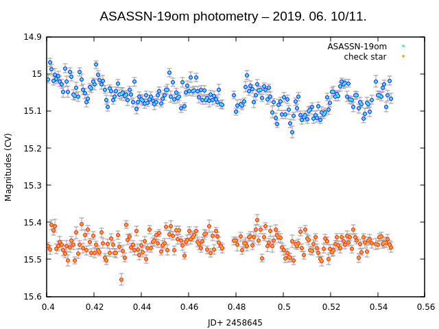

He has prepared for us these graphs (JUN.7 - JUN.11 at this time), he is mostly doing differential photometry with a clear filter:
Author: Tamas Tordai
Summary of first 3 days since alert:
Author: Tamas Tordai.
Based on these results, the outcome I've been told that it's most certainly a UGWZ-type dwarf nova.
