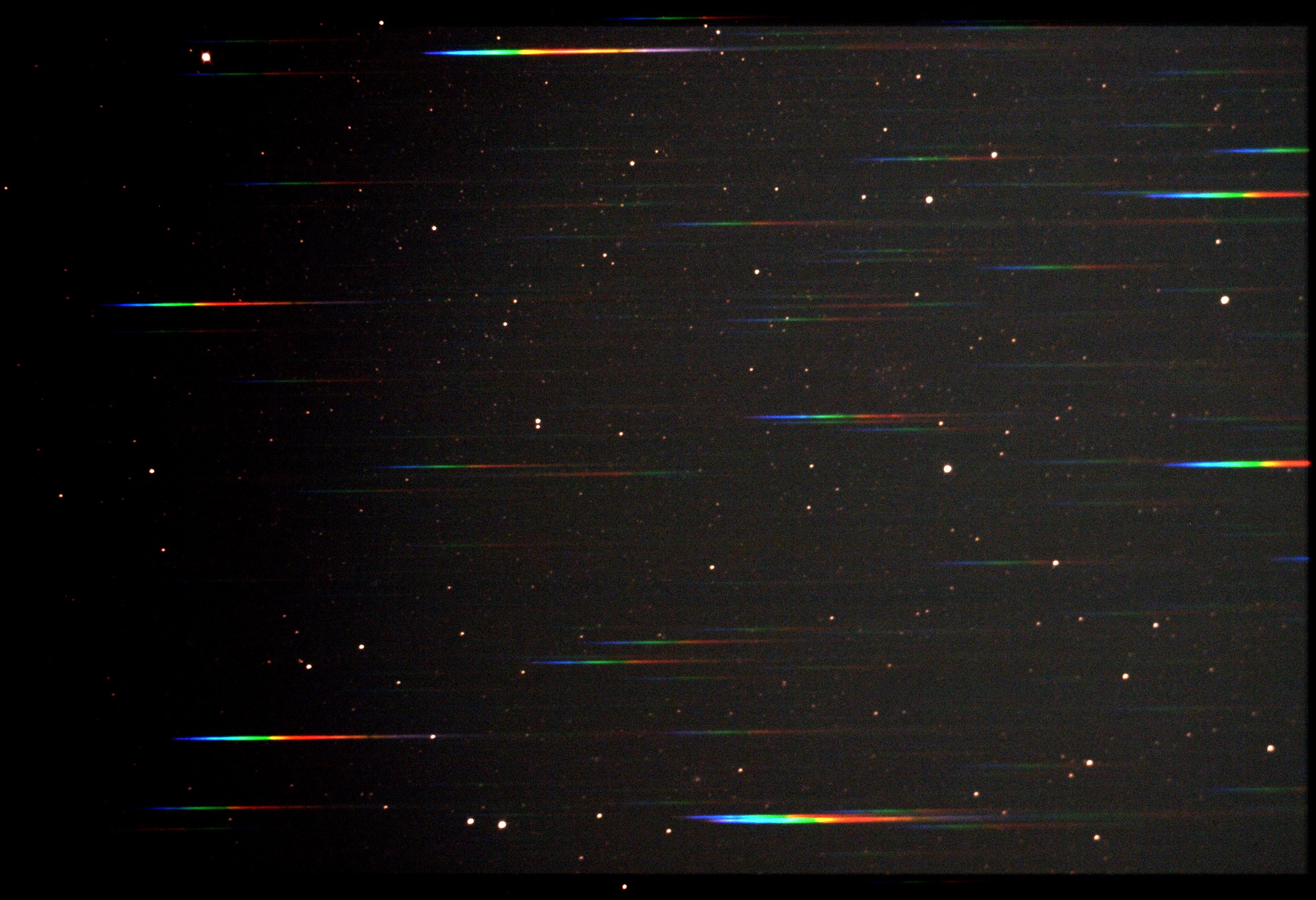

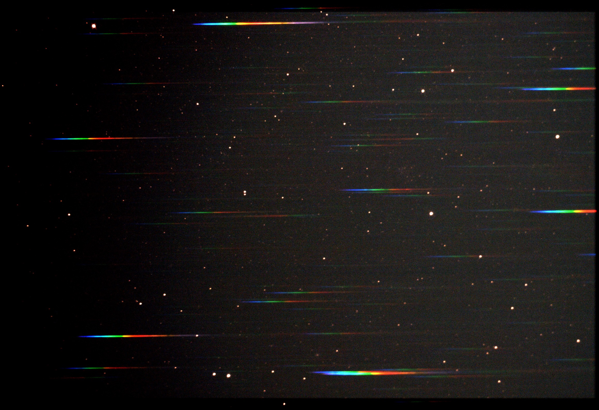

Hamish Barker
- Posts: 227
Re: ASASSN-19qv: classical nova (11 mag) in the SMC
stack of 14 x 30 second subs. ( had to throw about 1/4 away as my mount is a dob on unguided equatorial platform.).
Here's a jpg with colours fiddled a bit to balance for a grey background (my camera is a dslr with IR/UV filter removed so everything turns out a bit too red, hence why HD6509 at top left shows pink in the IR part of the spectrum as all three colour filters leak in IR).
Am just processing the binned greyscale fit. Unfortunately there's quite a gradient in the sky and no decent comparison star so it will be hard to make a reliable instrument/sky response correction but I will try with old one and also with the star at top left which is HD6509 (K2/3III) and the right hand star of the bright pair at lower left which is HD6933 (A9IV), which i have in another camera orientation so the spectra don't overlap as they do here.
Even without processing I can see an emission line in blue and in red also. I think the green central peakiness is just my camera's response.
It's quite exciting. I wonder how many other spectra were taken of this star last night.
A great result Hamish ! The spectrum definitely shows the characteristic Balmer emission of a classical nova. The green band may be unresolved Fe curtain lines. It shows the power of the simple Star Analyser. I suspect this might be the first Star Analyser spectrum of an extra galactic nova

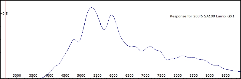

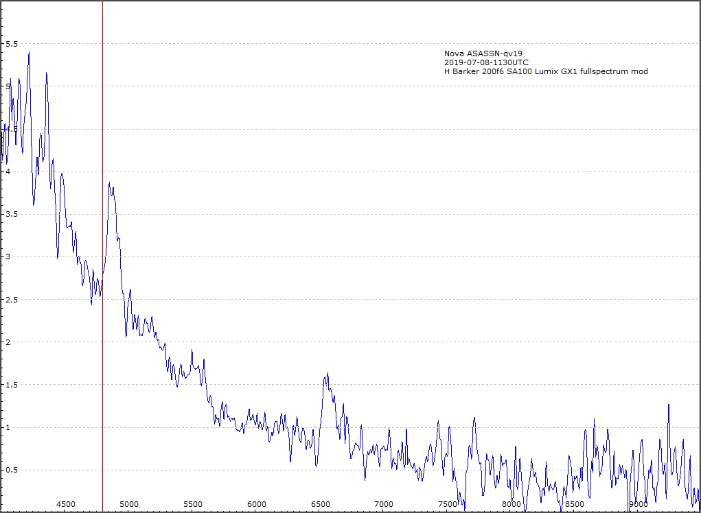

Hamish Barker
- Posts: 227
Due to the gradient across the image I can't get a proper reference for the instrument & airmass response, so have reused one from another day a week or so ago. Similar chilly conditions but probably then was higher altitude so the airmass would have presumably been lower. I have attached a copy of the response curve and my reduced spectrum.
The camera has response down to about 4000A. At the long end, the second order is going to be overlapping below about 8000A but I left it in the chart both as I think one can possibly see the second order of the Hgamma line.
- uvir-responsehd152235.jpg (64.63 KiB) Viewed 13789 times
- nova-asassn-qv19-2019-07-08-1130utc-withheader.jpg (230.58 KiB) Viewed 13789 times

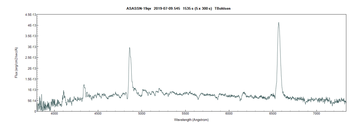

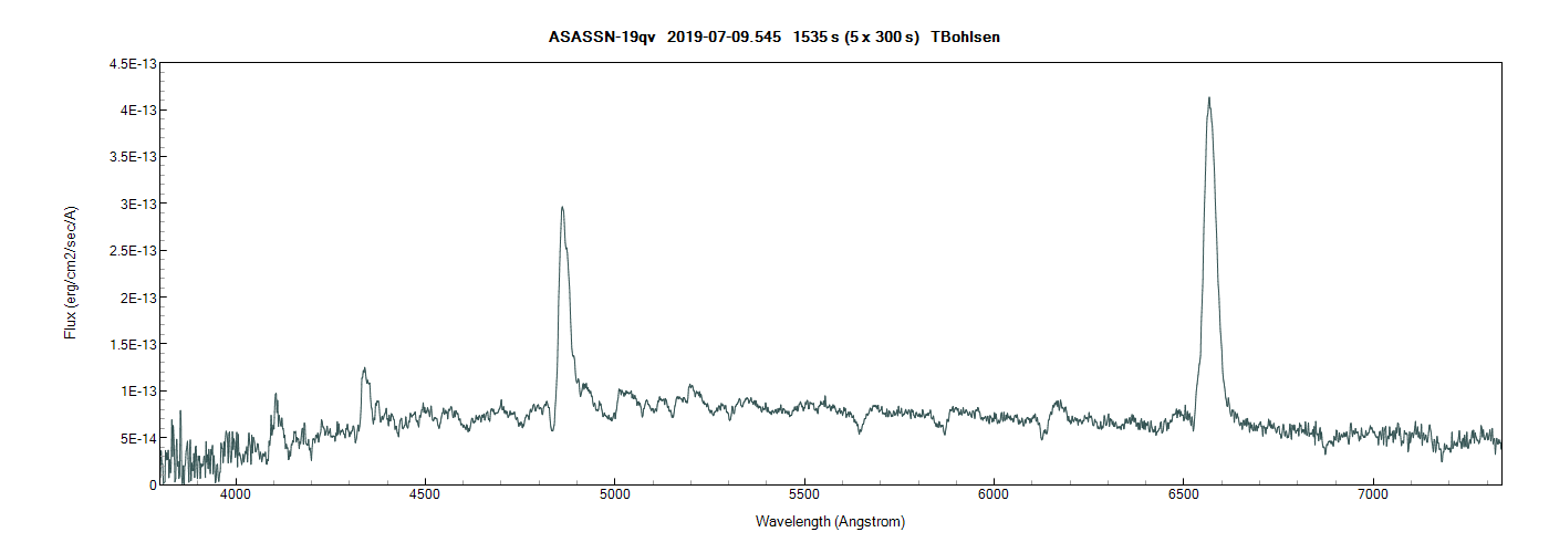

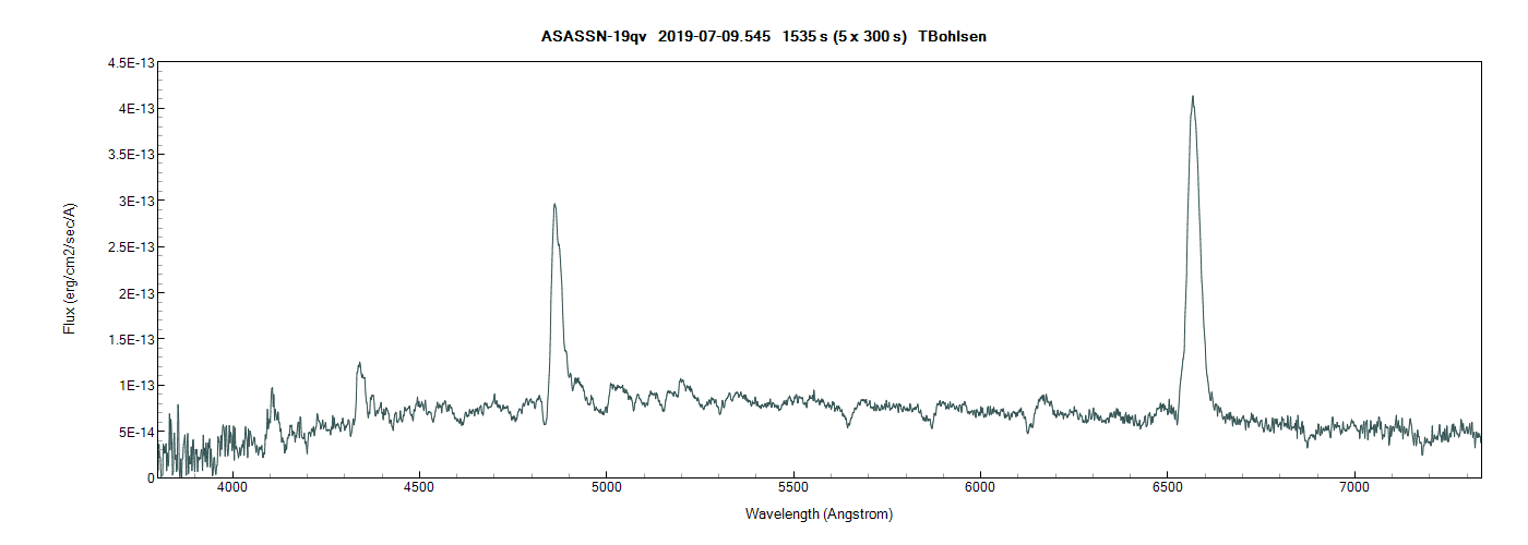

Terry Bohlsen
- Posts: 191
I haven't had clear skies until last night.
Taken with my LISA R=1500
Terry
Terry

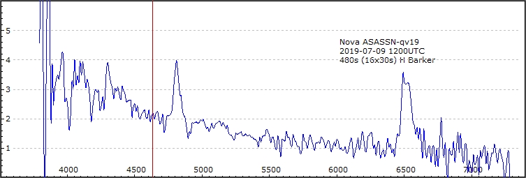

Hamish Barker
- Posts: 227
nice one terry. What software do you process with? I'm interested to make the erg/cm2/s flux calibration but have not got that far yet.
Here's mine from about the same time. ( my camera date was set wrong but it was about midnight here so I'll say 1200UTC.
I got a much better reference spectrum using beta carina. Maybe a few degrees lower but at least nice and bright and plenty of balmer lines so a better calibration. I'm pretty new to this so forgive the poor quality. i guess even rough data is better than no data.
Should I filter since I am oversampling anyway? I guess I should just bin more to reduce the noise, since seeing and chromatic loss of focus due to the converging beam is anyway limiting my resolution. Or it is better to leave the data as-is?
