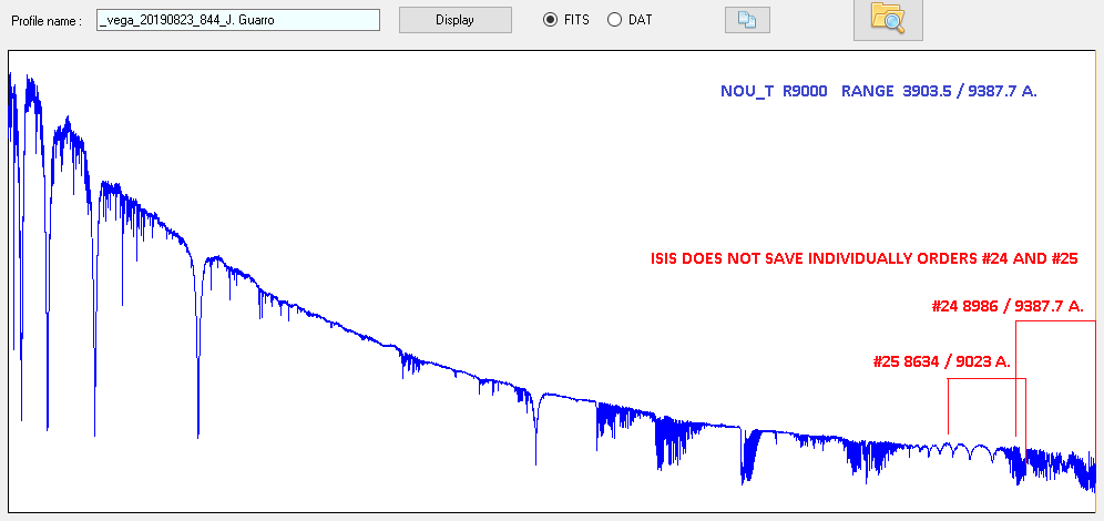

- _VEGA5.png (18.02 KiB) Viewed 15086 times
- _HD191182 5.png (13.7 KiB) Viewed 15086 times
- _PI AQR 5.png (14.06 KiB) Viewed 15086 times
- Posts: 685
Re: NEW NOU_T ECHELLE RESULTS

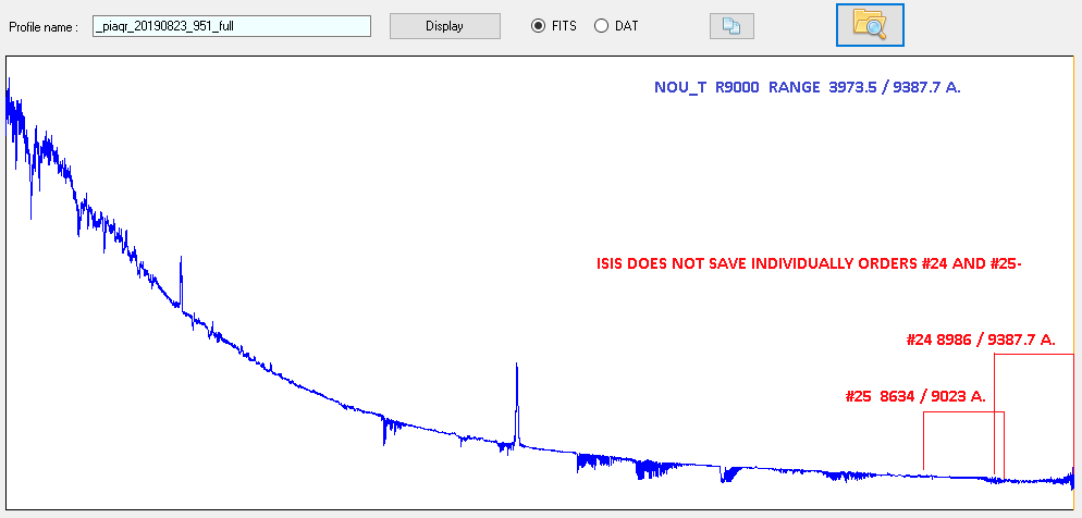

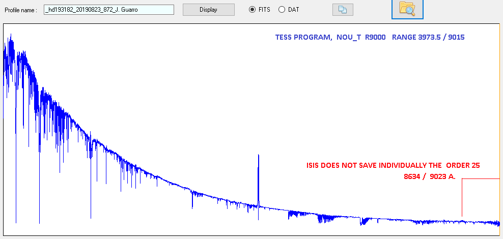

Now I can save with ISIS the ORDER 25 and 24, the problem has been resolved.

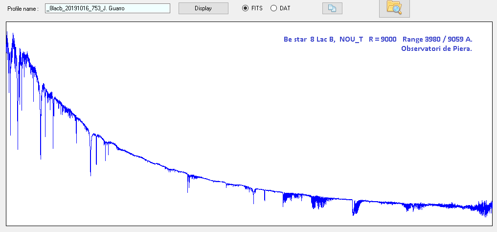

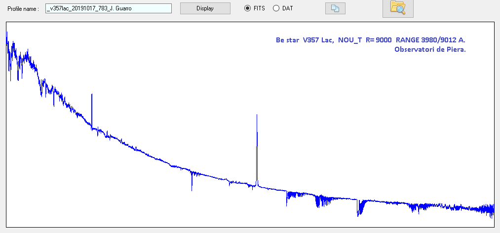

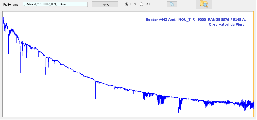

I leave here three graphics of Be star, I hope they will like you.
Cheers, Joan.
Cheers, Joan.
- _v442and_20191017_863_J. Guarro.png (15.78 KiB) Viewed 14805 times
- _v357lac_20191017_783_J. Guarro.png (14.25 KiB) Viewed 14805 times
- _8lacb_20191016_753_J. Guarro.png (14.86 KiB) Viewed 14805 times

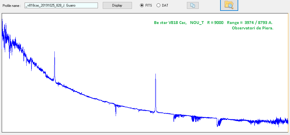

- Posts: 685

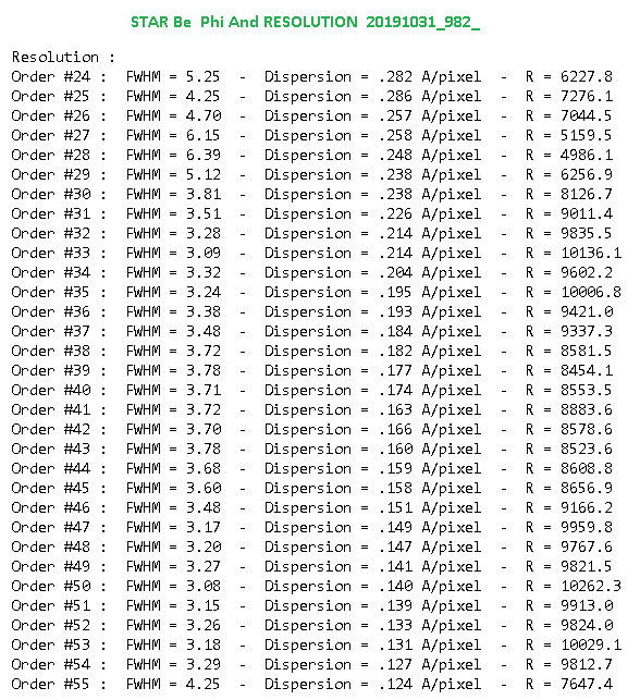

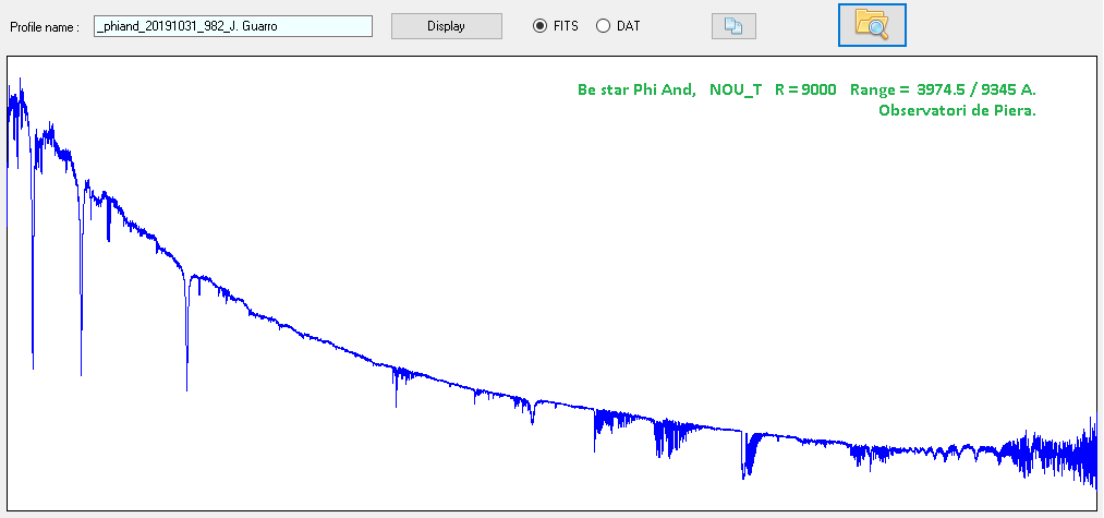

Here, you may see two new observations of Be Stars.
After some adjustments I've given for finished the NOU_T collimation. You can see his Orders and Resolution numbers.
Joan.
Joan.
- _v818cas_20191025_828_J. Guarro.png (14.36 KiB) Viewed 14658 times
- _phiand_20191031_982_J. Guarro.png (15.1 KiB) Viewed 14658 times
- RESOLUCIO_PHI AND.png (40.79 KiB) Viewed 14658 times

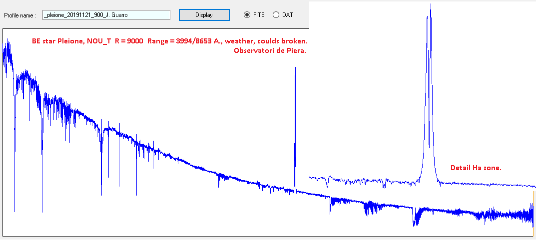

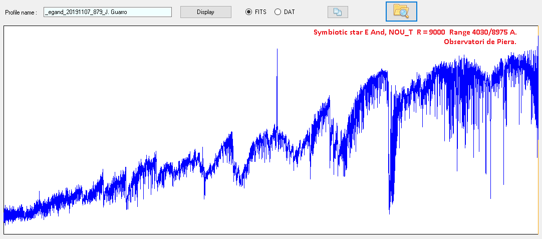

The weather hasn't very well last months here in Piera...
Joan.
Joan.
- Pleione.png (12.95 KiB) Viewed 14115 times
- Eg And.png (35.84 KiB) Viewed 14115 times

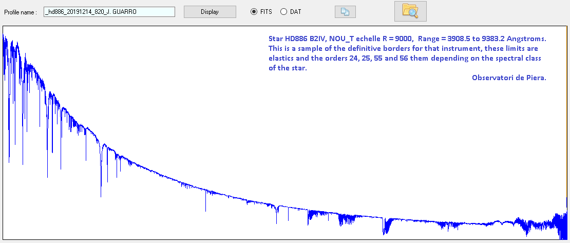

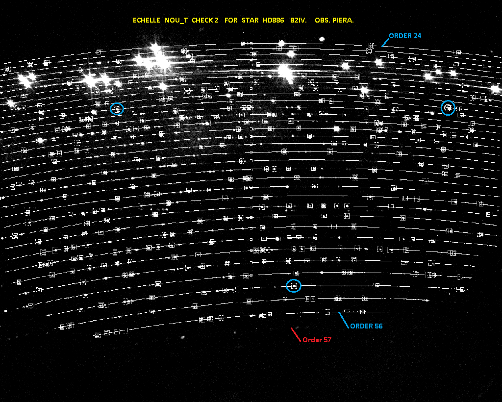

I've taken advantage these last days of bad weather to sharpen the NOU_T, these are the definitive results, his limits.
But now the NOU_T allows observe the Ca II H&K emissions at 3933.663 and 3968.470 A.
Joan.
Joan.
- HD886_CHECK.png (304.21 KiB) Viewed 13605 times
- HD886.png (16.72 KiB) Viewed 13605 times
