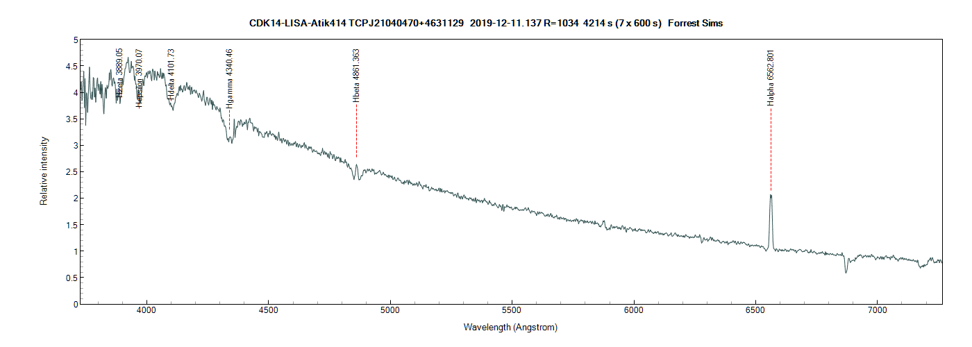

Please note that the artifact in my spectrum at about 4358Å is not real but probably HgI light pollution that I have not figured out yet how to remove from the spectrum.
Here is a spectrum I took last night with a Shelyak LISA.
Thank you.
Woody Sims

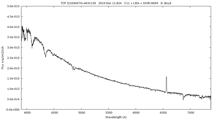

Here is another spectrum of this WZ Sge dwarf nova taken about 16 hours after Woody's. It is a composite of 24 300 sec integrations taken with a LISA (R~1000) on a C11 scope. I have flux calibrated the spectrum using a concurrently measured mean V magnitude of 10.99. The level of the continuum flux is almost identical to a spectrum I recorded on 24 July as it was fading from its first superoutburst.

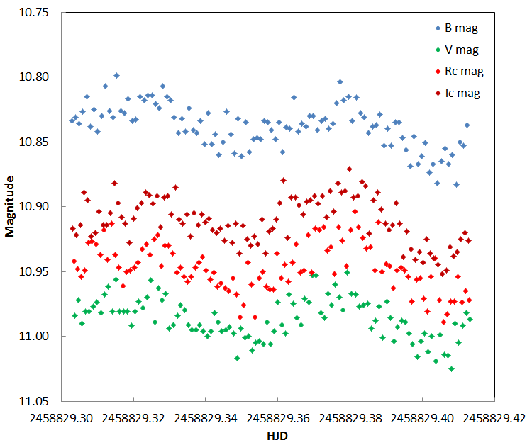

I also recorded the following BVRcIc photometry over 2.6 hrs before it disappeared behind some trees. The light curve shows modulation at a period of around 0.055 d which is consistent with the superhump period found during the earlier superoutburst indicating that this may indeed be another superoutburst.

Observations have been sent to Vitaly Neustroev and the ARAS database.

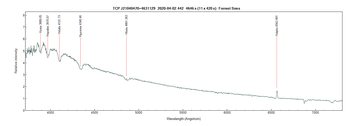

Vitaly Neustroev recently alerted us to the need for photometry and spectroscopy for TCP J21040470+4631129 to cover the period before during and after planned HST observation for the night of April 9/10. But the HST plan changed as TCP J21040470+4631129 has just gone into another superoutburst. David Boyd was able to get photometry on it on the night of March 28 and again on March 31. The V magnitude went from 15.408+/- 0.053 to 10.826+/- 0.018. In this magnitude range it is well in the reach of Alpy and LISA spectrographs. Here is a spectrum from this morning taken with my LISA.
Woody Sims
