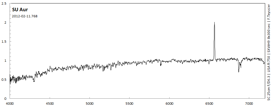

A typical spectrum of SU Aur taken with a C11 telescope (D=0.28 m)
and a LHIRES III spectrograph equiped with a 600 grooves/mm grating
and a 23 microns slit. 9 x 600 s exposure and bad seein (4-5 arcsec).
The resolution power is estimated at R = 3300 (measure on neon lines).
Date 11.842/02/2012 :
