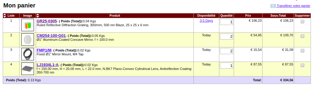

Regarding the precision parts from Thorlabs, my cart is already full, but I haven't ordered the parts yet, for interested people, here are the references:
As csv (xls are not allowed there):
Produit,Description,Product URL,Quantité,Prix,Sous-Total,Currency
GR25-0305,Ruled Reflective Diffraction Grating 300/mm 500 nm Blaze 25 x 25 x 6 mm,https://www.thorlabs.com/newgrouppage9. ... 06.23,Euro
CM254-100-G01,"Ø1"" Aluminum-Coated Concave Mirror f = 100.0 mm",https://www.thorlabs.com/newgrouppage9. ... 109.7,Euro
FMP1/M,"Fixed Ø1"" Mirror Mount M4 Tap",https://www.thorlabs.com/newgrouppage9. ... 31.08,Euro
LJ1934L1-A,f = 150.00 mm H = 20.00 mm L = 22.0 mm N-BK7 Plano-Convex Cylindrical Lens Antireflection Coating: 350-700 nm,https://www.thorlabs.com/newgrouppage9. ... 87.55,Euro

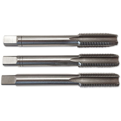

And 3 pass taps for M3 and M4 screws: https://www.manomano.fr/p/tarauds-hss-3 ... id=3035169 and https://www.manomano.fr/p/tarauds-hss-3 ... id=3035170:
