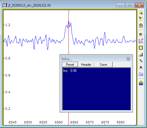

Posted: Mon Feb 10, 2020 11:33 pm
For example if 20191211 is used as the template. Dividing 20200113 by the template gives the change with the constant lines and the continuum divided out. The reduction in H alpha absorption is then obvious and the EW change can be measured with good accuracy as 0.46A

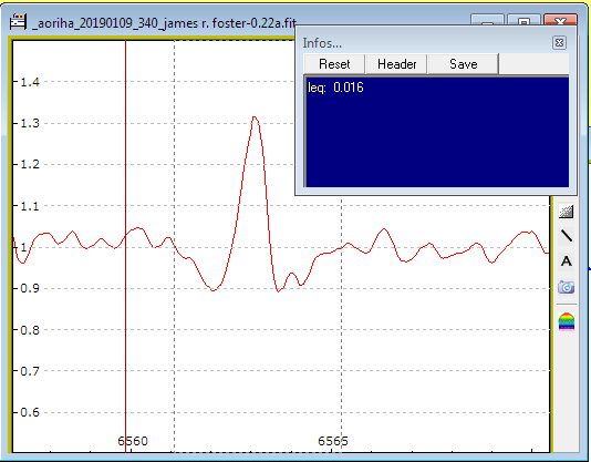

Hi Andrew,
Probably but comparing with a template allows you to see the wood for the trees.
In this case the ratio was not quite flat ie there was some broad change in continuum shape so I did normalise the ratio using a low order spline fit to be able to make the "EW change" measurement but it was much easier to do compared with trying to guess the continuum in the original spectra.
I think it is important in cases like this to consider first what you are trying to measure and use the appropriate tools. Measuring EW directly in spectra like this where all lines are blends and there is no continuum is effectively impossible. Here dividing out the stuff that is not changing (or perhaps subtracting rather than dividing, or even converting the spectra to absolute flux using brightness measurements and then taking the difference might be better) allows you to see what is changing and make some sort of quantitative measure of it.
There is other interesting information revealed the ratio of these spectra too. For example the broad change in the local continuum shape results from the deepening of the molecular bands which is seen in low resolution spectra. The same technique using the Jan 2019 and Dec 2019 spectra is also interesting. There appears to have been little overall change in H alpha intensity but the shape of the line is different producing a W shape line profile in the ratio.

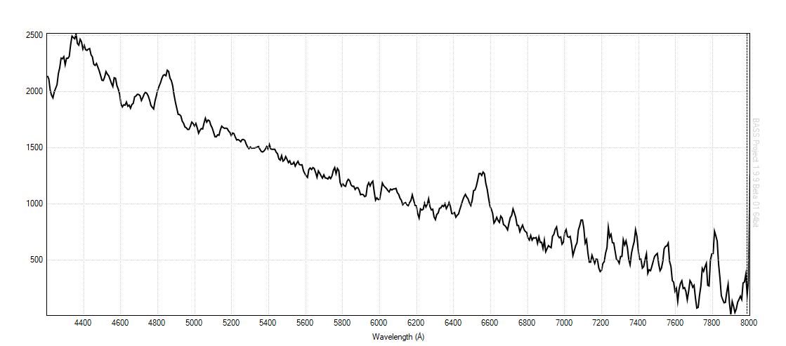

by Andrew Smith
Good points Robin, I have been looking at subtracting the pre flare spectra from the flare spectra I go of HIP25953 as both the continuum and lines are changing significantly. The attached is the result at the peak.
Flare peak - pre flare spectra
Flare peak.png (34.79 KiB) Viewed 10744 times
Regards Andrew
