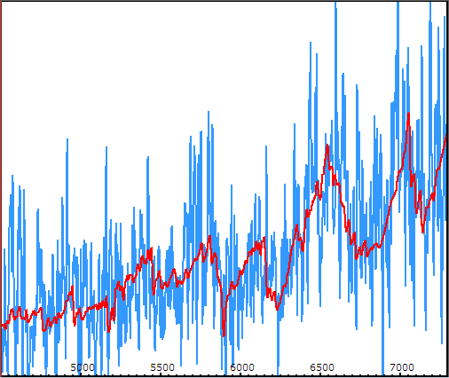

An extremely noisy (SNR~3 :o ) ALPY 600 spectrum last night suggests an M type star (M3?)
Red - Pickles M3v
Re: Call for observation for a new variable star
Posted: Thu Mar 05, 2020 11:16 pm
by Andrew Smith
Well done on such a faint star Robin, even with that SN ratio it looks fairly conclusive.
Regards Andrew
Posted: Fri Mar 06, 2020 11:24 am
Thanks Andrew,
It was much harder than I expected. I recorded SN 2020ue at mag 14.5 and higher air mass the same night and got an SNR of ~30 so at mag 16 I expected an SNR of ~15. Either it is a fair bit fainter than that or the bright moonlight had a greater effect.

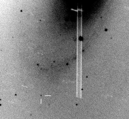

Posted: Fri Mar 06, 2020 11:51 am
OK I see on the astrosurf forum it has been remeasured at V mag 17 (though brighter in the red) so this is the faintest object I have recorded with the ALPY in its standard configuration.
Olivier, can you post a link to my spectrum in the astrosurf thread ?
Here is the guider image
