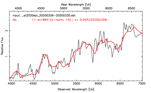

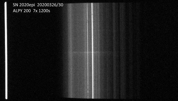

I managed to confirm and classify it (a type Ic) based on 2 spectra with the ALPY 200 on 26th and 30th March. It is still mag 18 so this is the faintest classification I have made :)
https://wis-tns.weizmann.ac.il/object/2020epi
Here is an example match to a type Ic. (The black profile is the average of the two spectra.)
and here is the raw spectrum image (The supernova signal is much fainter than the sky background, ISIS background subtraction and the optimised binning option worked very well)
