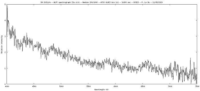

J'ai observé dans la nuit du 11/05/2020 la supernova SN 2020jfo qui se trouve dans la galaxie M61.
L'objet est aisément repérable sur l'image de la caméra d'autoguidage. Il en a été autrement au niveau des acquisitions des spectres.
De brusques rafales de vent ont perturbé le guidage et j'ai dû invalider de nombreux spectres bruts.
Le spectre réduit, fortement bruité, est les résultat de 30 minutes de pose.

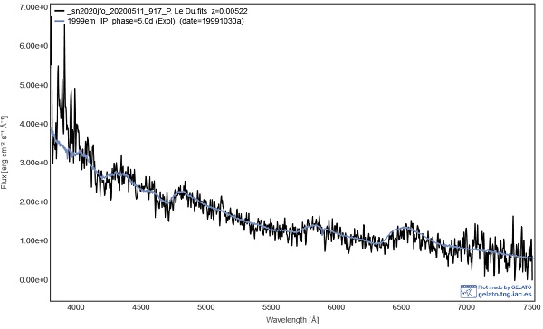

Toutefois, Gelato confirme à 100% une correspondance avec le spectre d'une supernova de type II.
Configuration : Newton 0.2m F/D 5, Alpy600 avec une fente de 23µm et CCD 414EX en binning 1x1
I observed on the night of 05/11/2020 the supernova SN 2020jfo which is in the galaxy M61.
The object is easily spotted on the image of the autoguiding camera. It was different in terms of spectral acquisitions.
Sudden gusts of wind disrupted the guidance and I had to invalidate many raw spectra.
The reduced spectrum shows a lot of noise. It is the result of 30 minutes of exposure.
However, Gelato 100% confirms a correspondence with the spectrum of a type II supernova.
Equipment: Newton 0.2m F/D 5, Alpy600 with 23μm slit, CCD ATIK414EX binning 1x1

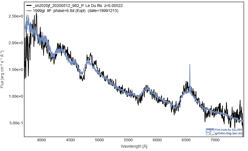

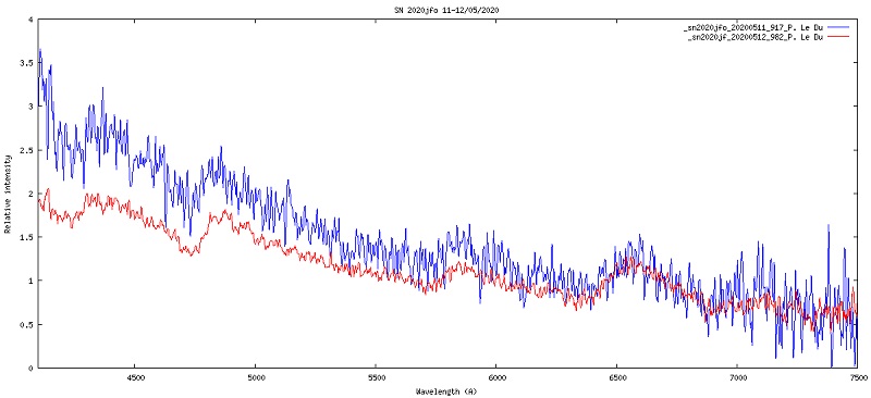

Bonjour

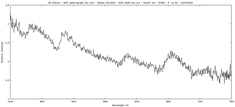

Nouvelle observation de la SN 2020jfo dans de bien meilleures conditions et avec le même matériel.
Cette fois ci, 5 poses de 20 minutes exploitées.
New observation of SN 2020jfo in much better conditions and with the same equipment.
This time, 5 exposures of 20 minutes exploited.
Spectre du 12/05/2020
Comparaison 11-12/05/2020
Analyse Gelato
Analyse Gelato

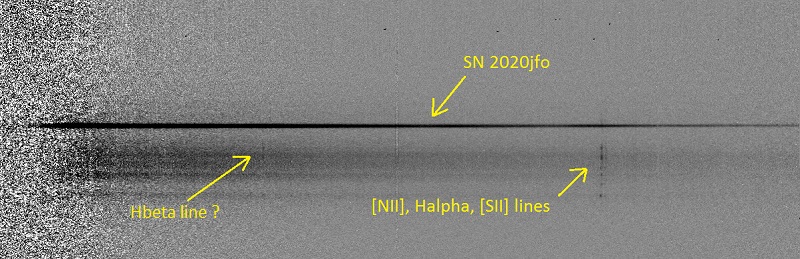

With the slit in that position you should be able to get a nice spectrum of the galaxy as well for free :-

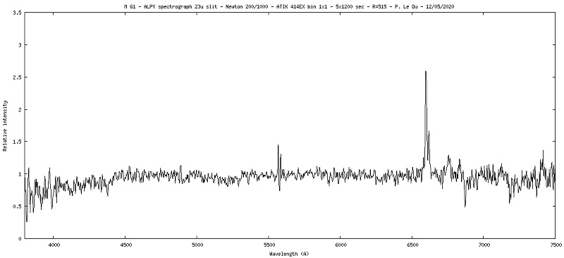

Hello Robin
Yes, I was able to make spectrum on a part of the galaxy M61, in addition I have beautiful lines in emission in the red.
I was able to identify the lines of the doublet [NII], the Halpha line and a line [SII]. In the blue, I think I also have the Hbeta line.
I was thus able to determine the redshift observed by my spectrum: z=0.005221. It is close to what is in the literature (z=0.005224).
The observed leakage speed is therefore 1564.91 km/s or 1543.11 km/s if we remove the heliocentric radial speed of 12/05 (-21.8 km/s).
On the other hand, it is difficult to deduce something about the speed of ejection of this type II supernova because it is not easy to determine with precision the shift of the hydrogen lines on my spectrum.
Maybe you can say more, Robin?
Oui, j'ai pu faire le spectre sur une partie de la galaxie M61, en plus j'ai de belles raies en émission dans le rouge.
J'ai pu identifier les raies du doublet [NII], la raie Halpha et une raie [SII]. Dans le bleu, je pense avoir également la raie Hbeta.
J'ai pu ainsi déterminer le redshift observé par mon spectre : z=0.005221.
Il s'approche de ce qu'il y a dans la littérature z=0.005224.
La vitesse de fuite observée est donc de 1564.91 km/s soit 1543.11 km/s si on enlève la vitesse radiale héliocentrique du 12/05 (-21.8km/s).
Par contre, il est difficile d'en déduire quelque chose sur la vitesse d'éjecta de cette supernova de type II car il n'est pas aisé de déterminer avec précision le décalage des raies de recombinaison de l'hydrogène sur mon spectre.
Peut être que tu peux en dire plus Robin ?
Spectre 2D M61
Spectre 2D M61
Spectre 1D M61
Spectre 1D M61

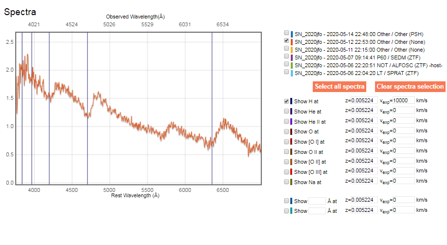

Re: SN 2020jfo in M61
Pascal Le Du wrote: Par contre, il est difficile d'en déduire quelque chose sur la vitesse d'éjecta de cette supernova de type II car il n'est pas aisé de déterminer avec précision le décalage des raies de recombinaison de l'hydrogène sur mon spectre.
Hi Pascal,
The Balmer lines are P Cyni profiles so the emission component is at the galaxy RV and the explosion velocity can be estimated from the absorption minimum.TNS has a nice plotting tool for this so you can measure from your spectrum that the velocity is ~10000km/s currently. (It depends on which element is measured because we see to different depths for different lines)

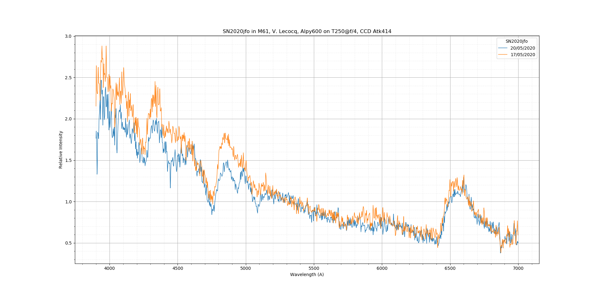

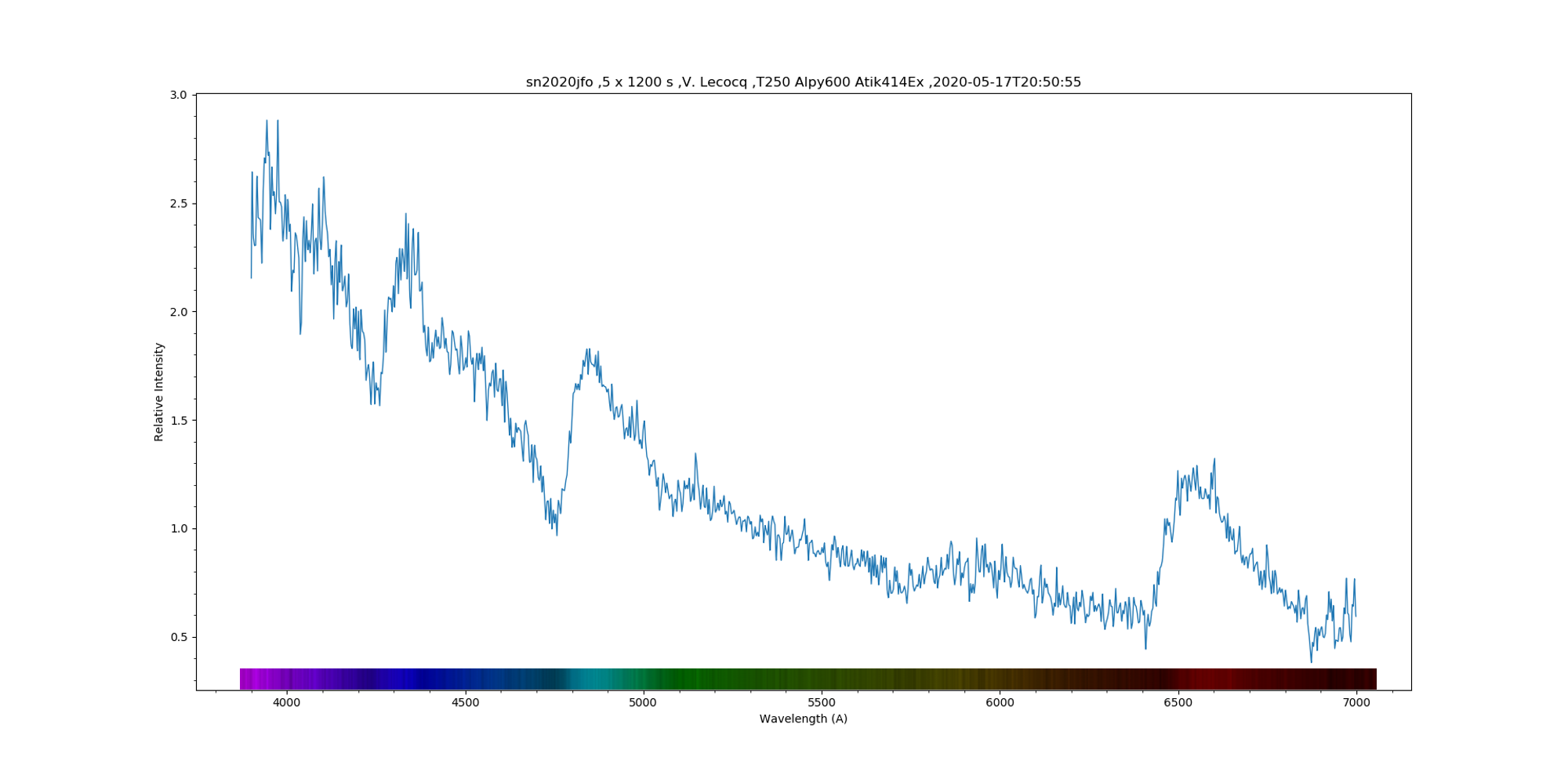

Vincent Lecocq
Posts: 40
Post by Vincent Lecocq »
hello,
my 2 cents !
vincent
Vincent Lecocq
Posts: 40
hello,
evolution of this SN ?
vincent

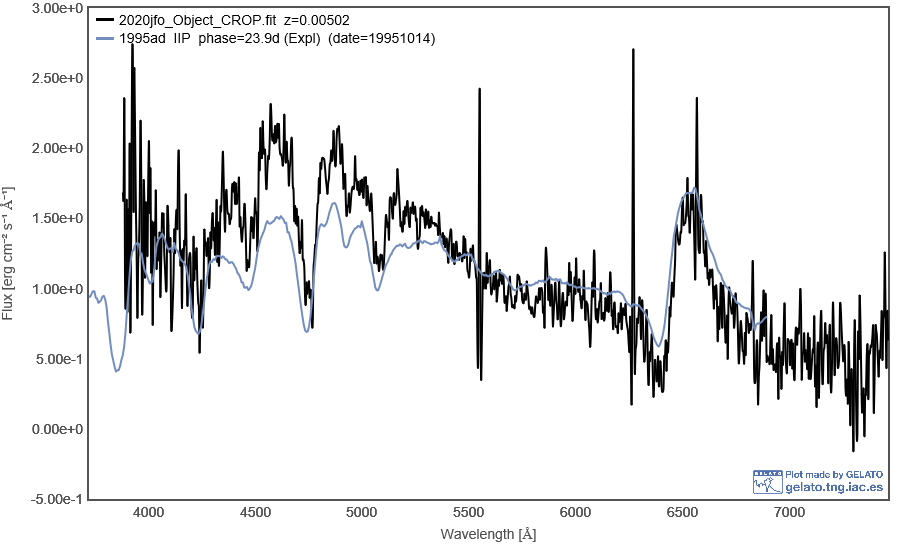

Some results with a LISA spectrograph
The Sn spectrum taken with a RC400 @ f/5.5
And calculating the ejecta velocity with PCyg profils of Balmer lines.
And to confirm that this Sn is in M61, the spectrum of M61
with the calculation of the redshift of M61
SIMBAD value is 0,00523

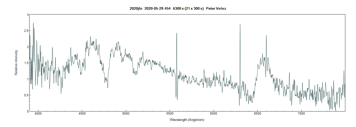

Peter Velez
Posts: 153
Post by Peter Velez »
Here is my contribution on this SN from last night.
21 x 300s LISA images binned x2 with a 23 micron slit through a Planewave CDK12.5. Imaging camera is an Atik 460EX. Imaged remotely at the iTelescope Facility at Siding Springs Observatory near Coonabarabran, NSW Australia. Processed with Demetra.
The 23 micron slit means that I am undersampling. When I manage to learn how to set the correct parameters in SimSpec I can optimise the rig.
At this early stage I'm pleased with the result. There are a couple of spurious spikes though the emission at around 6600 is genuine. I'm keen to learn how to identify particular absorption features to determine the velocity of the ejecta from the spectrum. If anyone can point me towards a useful publication or site for this I'd be grateful.
Pete
