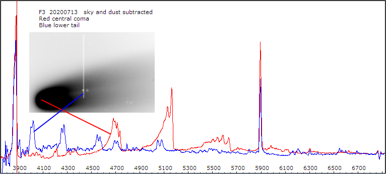

On 2020-07-13 I took some ALPY600 spectra across the tail of C2020 F3 (NEOWISE). The emission spectrum (sky and dust subtracted) is very different to the coma (except for CN and NaD) with several unidentified doublets and no C2/C3 etc. I did not expect this! Is this correct? (The doublets are clear in the raw images and are only in the comet.) I also have spectra of the other half of the tail and the doublet emission lines are there too. Does anyone know what they are ?
Thanks

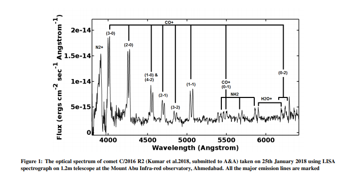

OK, I have been doing a bit of googling and I think they are from CO+. The ion which gives the ion tail it's blue colour. eg
from https://meetingorganizer.copernicus.org ... 8-1220.pdf
If you get the chance the tail is well worth looking at. The intensity is only ~1% of the coma spectrum so you need long exposures but it is completely different from the coma spectrum you usually see

Bravo pour cette expérience ! Analyser différents spectres générés le long de la fente permet de révèler la présence d'espèces chimiques dans les queues de la comète qu'on ne voit pas nécessairement dans un seul profil, c' est une manip à reconduire tant que C/2020 F3 dégaze beaucoup et reste accessible à nos instruments au sol. Cela sous-entend que les images spectrales 2D de ce type de cible constituent un réservoir de données sous -exploité.
Merci du partage !

Michel Verlinden wrote: Cela sous-entend que les images spectrales 2D de ce type de cible constituent un réservoir de données sous -exploité.
I agree. I was surprised at what we are missing by concentrating on the brightest part of the coma. We need an imaging spectrograph for amateurs! (A drift scan spectrum of the comet would be interesting but there would not be enough time in a night to give enough exposure to see the outer coma and tail)

Ces raies doubles ressemblent beaucoup aux raies de la comète C/2016 R2 (PANSTARRS). Très probablement du CO+.
Plusieurs spectres ont été publiés dans la base cometes du LESIA : fin 2017 début 2017
https://lesia.obspm.fr/comets/lib/displ ... ?Num=18651
https://lesia.obspm.fr/comets/lib/displ ... ?Num=18708
https://lesia.obspm.fr/comets/lib/displ ... ?Num=18894
Hubert

Hi Hubert,
Thanks for the links. Yes definitely CO+. It is clear that the spectrum of comets depends strongly on where in the comet they are taken. C/2016 R2 was unusual. The CO+ was seen in the coma.
In 2020 F3 (and in most comets I think) the CO+ is not seen in the coma, only in the tail (perhaps because the light from dust and C2 etc is normally so bright in the coma)
There are other lines in the tail which are not in the coma in my high resolution spectrum near NaD which I have not yet identified
