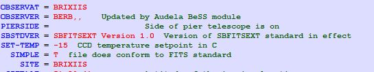

I tried to send a spectrum to the AAVSO database, but I get the message that my observation code is not correct. I now notice that in the FITS header it says twice ',' behind the code. I use the BeSS function to send the observer code to the AVSO observer code. But I now notice that there are 2 comma's behind the code. Can this be changed ? In earlier versions of SPcAudace this appeared to work. I am now using version 5.0.

I will look for a patch. Actually you can modify this header's keyword with the following commands:
buf1 load your_spectrum.fit
buf1 setkwd [list "OBSERVER" "BERB" string "Observer name" ""]
buf1 set bitpix float
buf1 save your_spectrum_updated.fit
Nevertheless, have in mind that AAVSO database dosen't strictly follows Bess fits file and many observers complain when posting spectra there.
Benji

I tried the commands you're mentioned below:
with the commandline buf1 set bitpix float, i get an error that 'subcommand is missing'
as result , i get a very weird spectrum with only vertical lines. I checked the observername, and now it is correct, without the 2 comma's, but the spectrum is changed.
Re: Observercode in FITS header
Posted: Fri Jul 31, 2020 12:49 pm
by Benjamin Mauclaire
Here his the correct command: buf1 bitpix float.
Although the spectrum you saved is now built with integer values. So put it to rubish. I hope you have a copy of the original.
This was why I named differently the output spectrum in my previous post.
Benji

all works fine now with the commands you gave me.
Upload to AAVSO database, was succesfull now.
Thanks !
