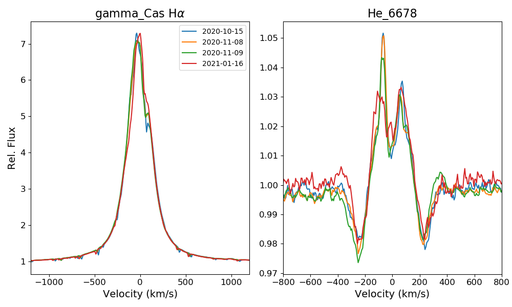

our professional consulter Dr. Myron Smith wrote recently:
Based on your work on correlation of Halpha and HeI6678 EW´s (see the Fig. below) , it is clear that gCas is in a state now of rapidly building up its disk.
This is a condition for which a proposal a few of us wrote recently for XMM (x-ray satellite) time could fulfill.
The star becomes visible to the satellite once again on January 6th.
Do you think a short time before this we could get a very up to date description of what the star is doing (Christmas-New Years Day timeframe)? We would really appreciate it.
Gamma Cas (often categorized as uninteresting and well known star) shows at present a high interesting, not only for professionals, but for amateurs too an unique developement, that could end (very soon?) in a super nova event (or so).

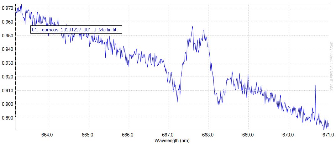

by Jack Martin
Here is my effort.
Any comments ?
Regards,
Jack
Essex UK

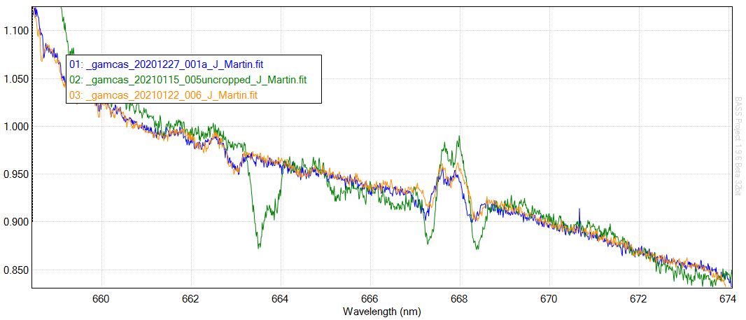

by Jack Martin
Interesting absorption feature around 663.5nm now fading.
Any comments ?
Jack
Essex UK
Re: HeI 6678 Campaign of gamma Cas
Posted: Tue Feb 02, 2021 4:34 pm
by J Labadie Bartz
Hi Jack,
Weird feature. Do you think it is real (in the sense that it is astrophysical and not some detector artifact)? I took spectra of gamma Cas on the night of Jan 15 (UT time ~01:30 Jan 16) and there is no sign of this feature in my sequence of 13 exposures. There shouldn't be any photospheric absorption at that wavelength for an early B-type star. However our data seem to have good agreement in the shape of the He 6678 line profile.
Single exposure from night of Jan. 15.

Hi Jack,
Dust specs and a poor flat correction perhaps ? Is the spectrum in the same Y position on the sensor for all these observations? Is it on all the sub exposures ? What does the reference star spectrum look like ?
Posted: Thu Feb 04, 2021 3:52 pm
by Jack Martin
JLB,
As you have not detected it in your observations, I don't think its real, an artifact of the set up.
Thanks for your input.
Jack
