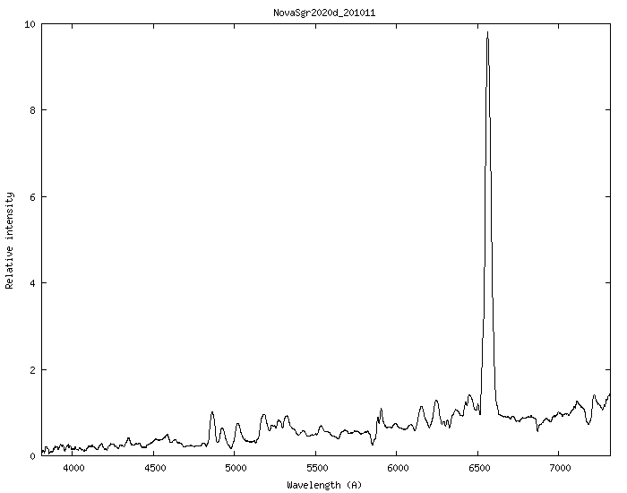

A low resolution spectrum from tonight, with the nova low in the west.
Paul
