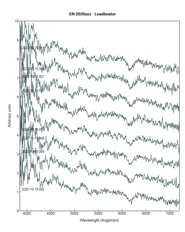

Posted: Sat Oct 17, 2020 11:32 am
Currently mag 13.8 and approaching maximum

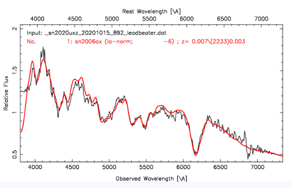

ALPY 600 8x600s (black) overlaid on best fit from SNID (red)
Spectrum in BAA database
https://britastro.org/specdb/
https://britastro.org/specdb/data_graph.php?obs_id=8020
Re: SN 2020uxz in NGC514
Posted: Sun Oct 18, 2020 9:40 pm
by Hamish Barker
Very nice result especially at M 13.8 ! What size telescope was used Robin?
Hamish

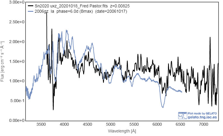

Hi All, Hi Robin,

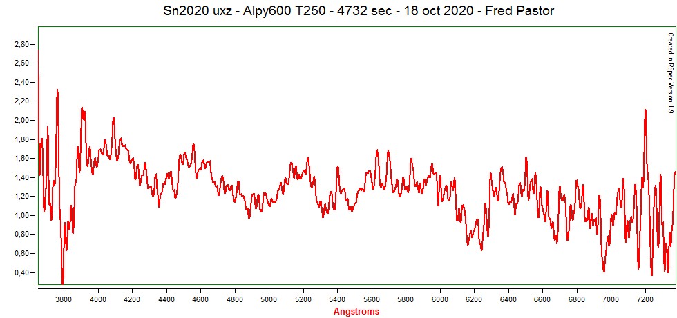

After a second try, I could obtain enough signal yesterday evening. Here is below my contribution:
Sn2020 uxz under Rspec - 7 x 600 sec - 18 oct 2020
SN2020 uxz Fred Pastor Rspec.jpg (80.46 KiB) Viewed 10913 times
My continuum is rather flat, especially in the Blue. Can't explain if this is because of the star in explosion or a bad instrumental response obtained. That being said, Gelato has correctly matched with a type Ia also proposed :
Gelato - matching with 2006gz
gelatoplot (3).png (62.17 KiB) Viewed 10913 times

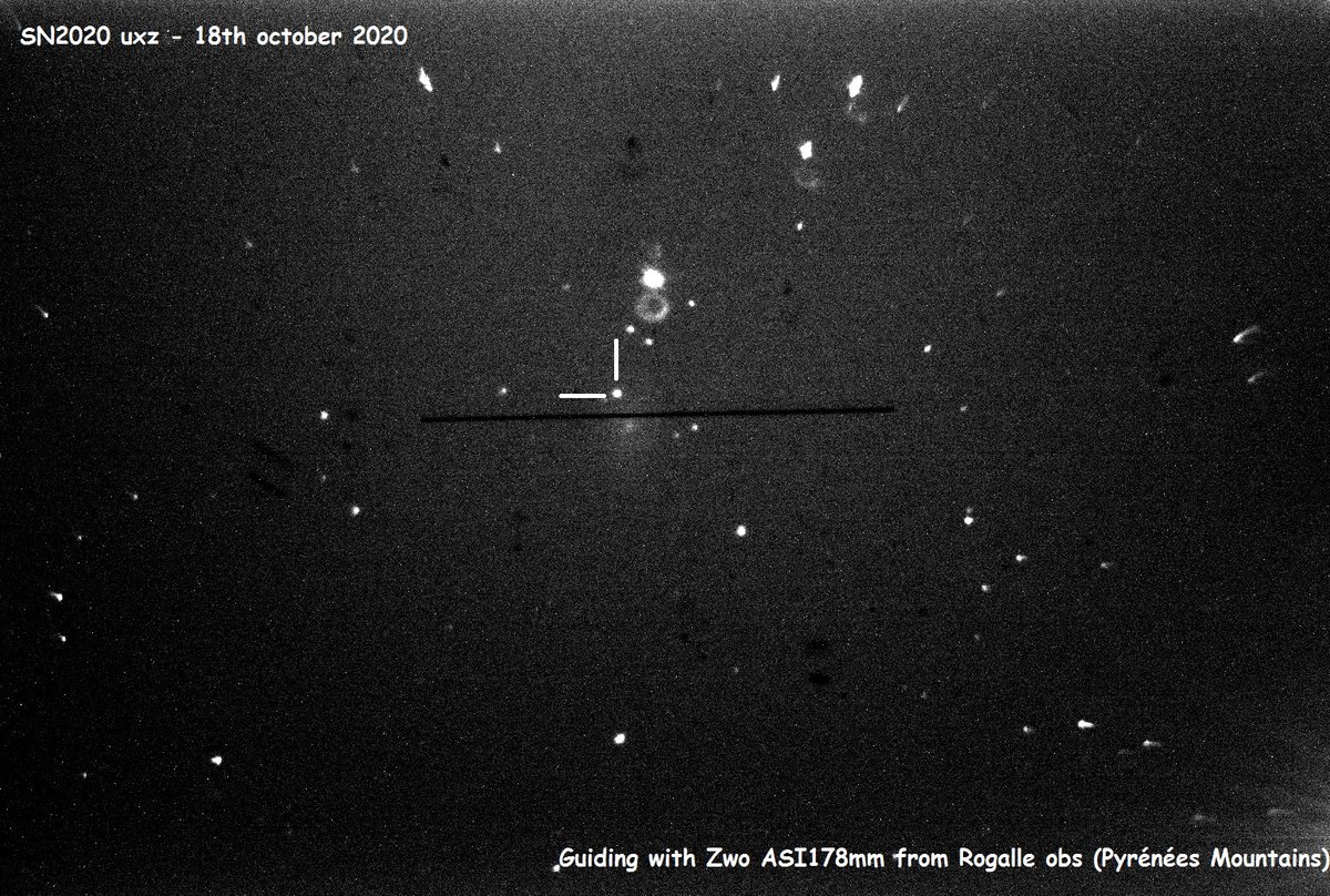

This Sn is still exiting to follow in the days to come, not far away from Mars at the moment in the sky. Here is a picture of my guiding camera below :
guiding cam
guiding cam
Fred
Posted: Mon Oct 19, 2020 6:02 pm
Hamish Barker wrote:Very nice result especially at M 13.8 ! What size telescope was used Robin?
Hi Hamish
280mm (The Celestron C11 at f5.5). This magnitude is ok for me with the ALPY 600. Even the individual 10min spectra show the main features
I can get to ~mag 15.5 with the standard ALPY, though at reduced SNR and mag 16-5-17 with my modified ALPY 200 at R~130 eg for faint supernovae classification
Posted: Thu Nov 05, 2020 3:11 pm

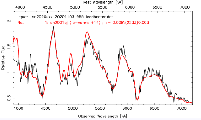

A spectrum from 20201103, approximately 12 days post maximum. Significant evolution since pre maximum
https://britastro.org/specdb/data_graph ... end_pos=ne
but still a good match to a typical type Ia

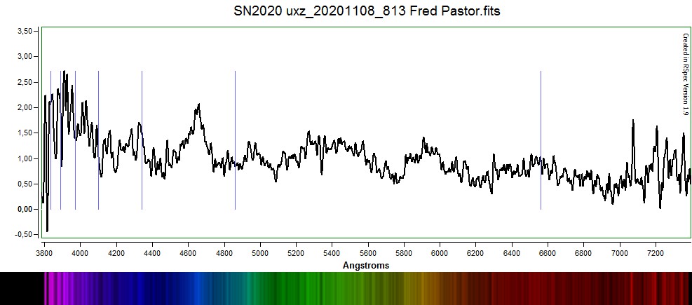

After its 34th days post explosion, and 17th days post maximum; spectrum of SN2020uxz taken yesterday evening :
SN2020uxz Spectrum taken 8th Nov 2020
RSPEC SN2020uxz 09 11 2020.jpg (76.08 KiB) Viewed 10645 times

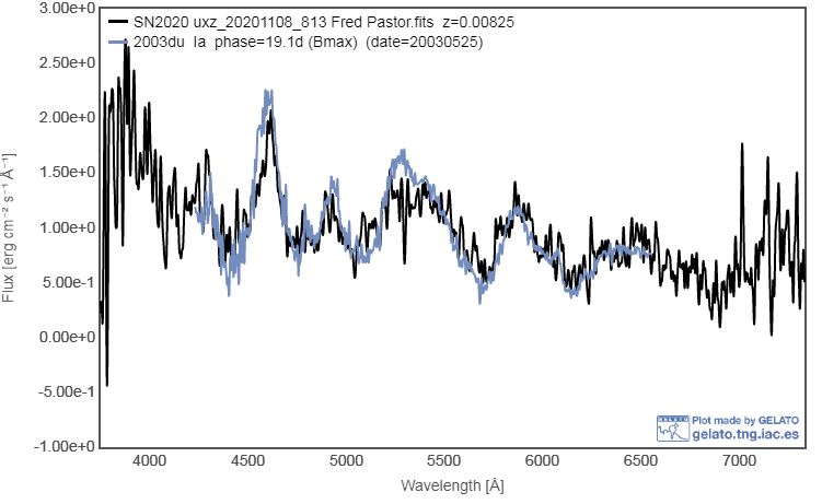

It also match corectly in GELATO with the SN2003du, in its 19th post max:
gelato matching
gelato matching
gelatoplot SN2020uxy 2003du.png (61.05 KiB) Viewed 10645 times
