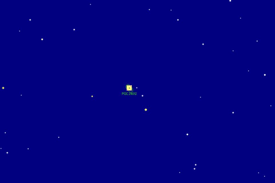

Hi Robin,
Interesting. I just converted the J2000 to JNow coordinates and the AT2020adow is inside the Galaxy PGC24012 mag 15.5 and a size of 51.0" x 30.0" according to my planeatrium program.
JNow
RA 04h 34m 54.6s
DEC +27° 38' 33"
Do not know if at mag 16.2 I would locate it. Will take a look if I have clear sky tonight. A little bit late here but I think it is worthwhile looking for it.
Fortunately there are 3 nice stars like a pointer pointing on the Galaxay 8-)

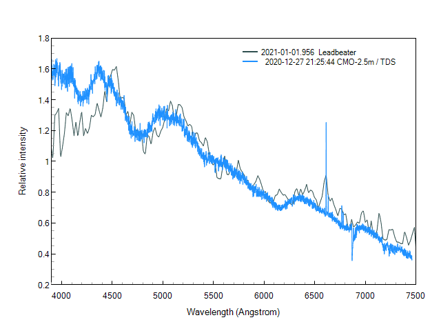

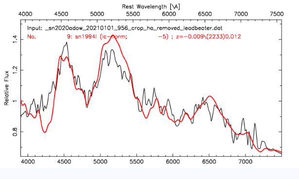

Hi Rainer
TNS is just for confirming, classifying and naming transients. Once this has been done there are normally no further updates unless follow ups suggest a change in classification. It might end up in a paper in while like these (I am a co-author as I took a confirming spectrum of one of them)
https://ui.adsabs.harvard.edu/abs/2020A ... D/abstract
This is what AT2020adow looked like a couple of nights ago with the modified ALPY 200 compared with a Ic from SNID (It was about mag 14.5 from the guider image)
and compared with the professional classification spectrum a few days earlier (note the narrow H alpha line from the host galaxy and how the radial velocity of the broad absorption lines seen in the spectrum has reduced between the two dates, making my spectrum appear relatively redshifted

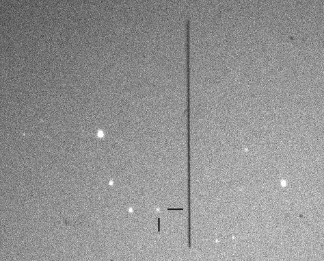

Re: AT2020adow - possible supernova in a low redshift galaxy
Posted: Sun Jan 03, 2021 12:44 pm
Here it is in the guider image. Its brightness completely dominates the host galaxy (note the very bright sky background from the moon. Despite this it was still possible to get a reasonable spectrum)
