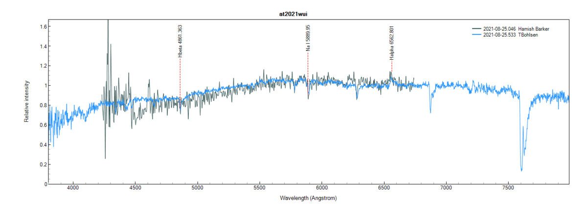

I took a spectrum quite low in the sky, and Terry Bohlsen has taken a better one:
However, now the Rochester list indicates it as type CV, but no details of spectrum or classification report are included.

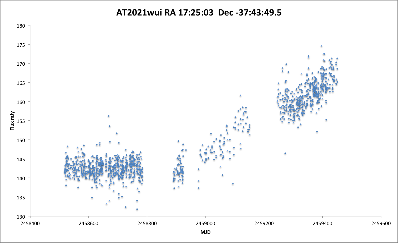

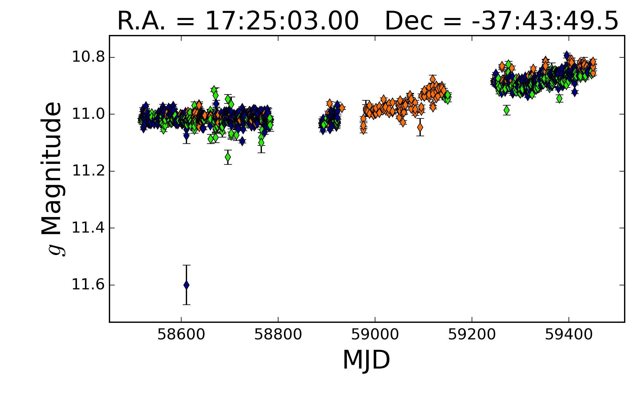

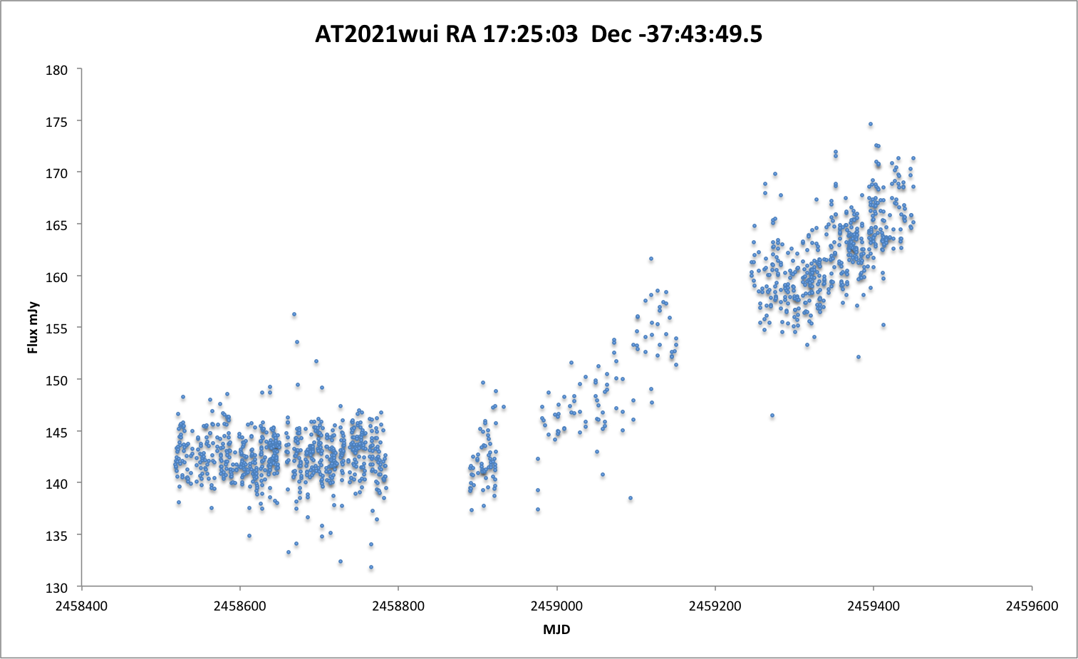

The object was notified from the GAIA alerts team as having brightened 0.3 mag in 2 years.
Here is the the light curve for the coordinates which I have retreived from the ASAS-SN survey:
zoomed in a bit
It's seems similar to a k2iii spectrum but the continuum falls of more slowly compared to the k2iii. There seems to be absorbtion at Hbeta but modest emission at Halpha.
Does anyone have suggestions as to what it is likely to be, and why should there be emission at Ha but absorbtion at Hb?

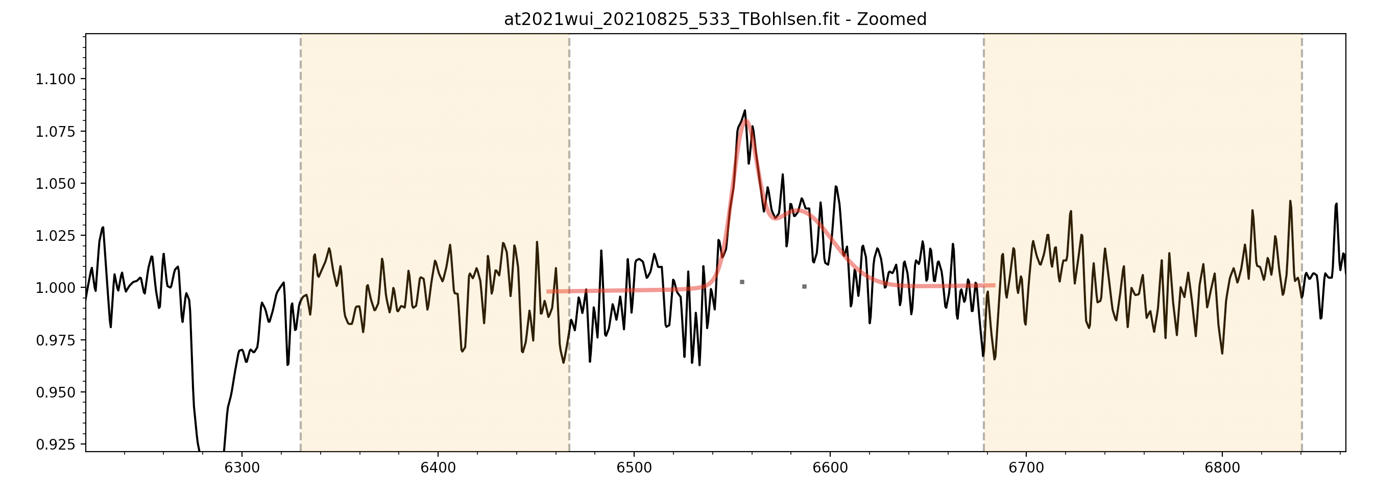

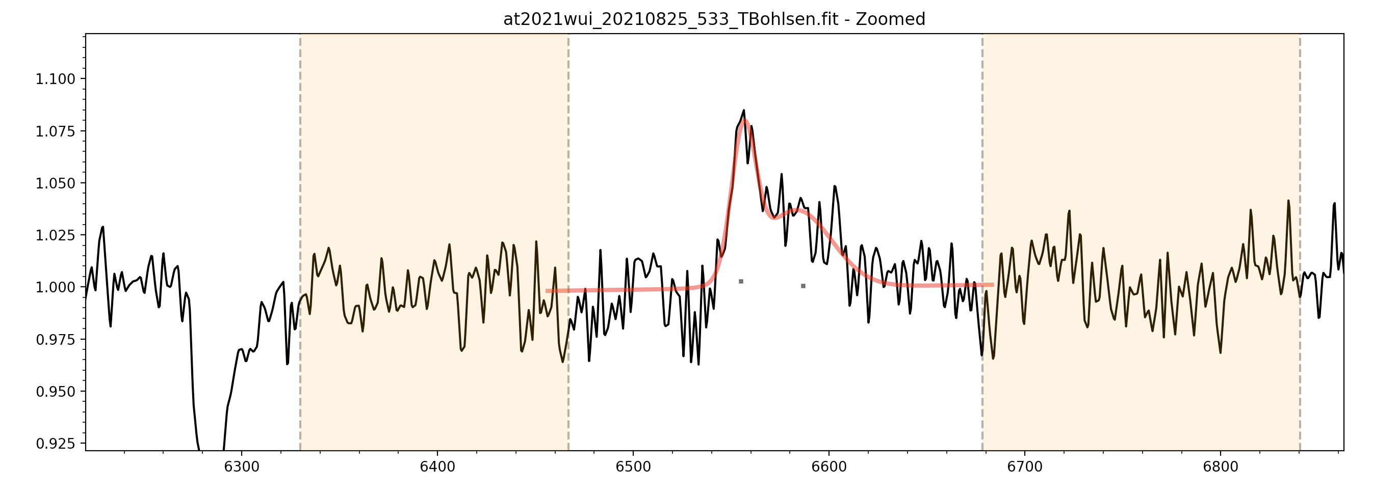

I’ve had a quick look to your [HB Note: Angel was actually looking at Terry Bohlsen's] spectra: it’s definitely H-alpha and very probably [N II] 6583 in emission, likely each line has at least a couple of components (but the resolution of your spectra does not allow to check that, you need high resolution).
Here is the screenshot of my quick check, and the results of a double Gaussian fit:
Gaussian fit 1: SNR = 16.13 RMS = 3.440e-02 center = 6556.293 ± 0.344 flux = 1.056 ± 0.065 EW = -1.06 ± 0.07 FWHM = 14.60 ± 1.14 A = 667.8 ± 52.1 km/s
Gaussian fit 2: SNR = 11.58 RMS = 1.248e-01 center = 6583.134 ± 2.060 flux = 1.677 ± 0.145 EW = -1.68 ± 0.14 FWHM = 42.36 ± 4.39 A = 1937.2 ±200.7 km/s
The broad of the emission lines, particularly the [N II] 6583 emission, suggests that there is some expanding ionised material (a bubble) around the object or ejected from the object.
The high [NII]/Ha ratio, [NII]/Ha = 1.6, indicates that the ionisation is not coming from the photoinization from massive stars/hot stars, but from shocks (as it happens around active galactic nuclei, AGNs, or around other stellar energetic sources).

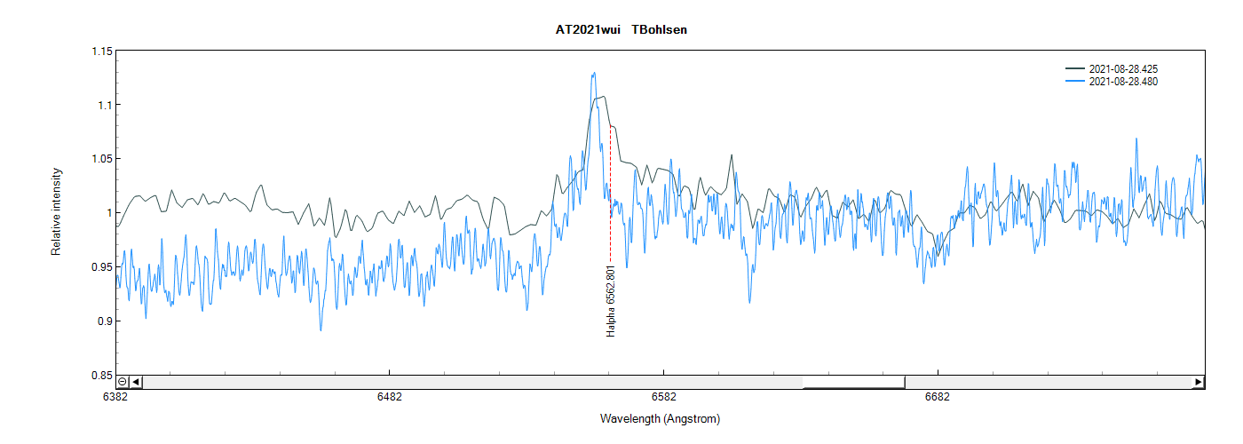

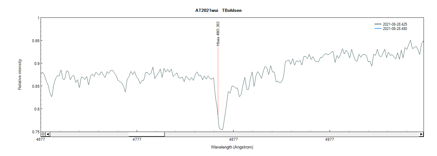

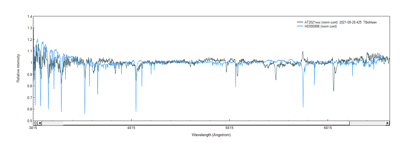

I have taken a few nights data of this interesting object. The graphs below are from the same night using my LISA at R=1600 and Lospec of R=5000.
There seems to be Ha emission that is blue shifted about 280 km/s. Hb is in absorption and shifted 170km/s to the red.
Any suggestions about a mechanism?

So, could the Be emission be sufficient to explain the circa 17% increase in flux? I see only a little pimple of Halpha. Assuming that and say Hbeta were previously deep absorbtions, could that add up to 17% increase? Does the additional flux from what is presumably the disc of the Be stars increase not only at Halpha (or other lines), but also in the continuum?
I found this nice paper with a model an example star with fairly similar (6 month increase then decrease) photometric behaviour:
https://ui.adsabs.harvard.edu/abs/2013A ... S/abstract

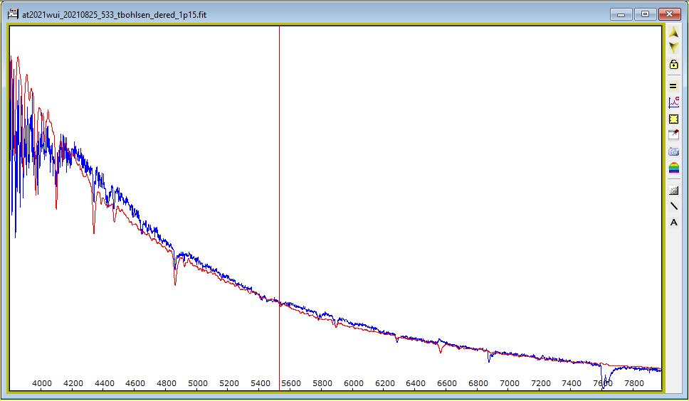

Here is Terry Bohlsen's spectrum dereddened by 1.15 compared with Pickles B1v.
Whatever it is, it is certainly not a K2iii star so to avoid any ongoing confusion I recommend amending your comment on the IAU TNS website.
