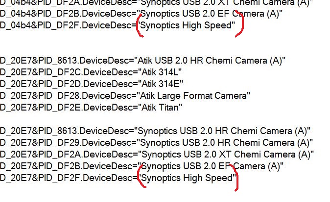

Dear all,
I raise here a problem that is not spectroscopy-specific but not far from it since it concerns the Atik Titan that is nowadays probably mostly used by spectroscopists
I guess there are many Titan users here and perhaps some faced the same problem. Here it is:
I recently bought from a shop in UK a (quite cheap) Titan aimed at being used on the ALPY. I have already an Atik414ex which works without any problem in W10. But I fail using the Titan, even connecting it through PhD2 or Prism or even Artemis Capture.
I have the latest core software fully installed as well as ASCOM 6.4-SP1. The link between the Titan and the atik driver is not done automatically, that's fine I select the driver repo manually: Atik Cameras/Drivers/64Bit and it finds it.
This is my first question: the selected driver for the Titan is named 'Synoptics High speed' (see picture attached). Is this expected? According to W10 the driver works fine. But the camera remains undetected by Prism, PHD, etc...
I have read here and there that Atik driver evolution was problematic at some point, with some backward compatibility issues in particular...
Any idea before I put the Titan in my musem of oldies
Simon

Re: Driver issue with Titan
Posted: Sat Feb 19, 2022 10:16 am
by Alun Halsey
Hi Simon,
Looking for a Synoptics driver online I came across this web page
https://www.driverscape.com/download/sy ... ra-%28a%29 I downloaded and unzipped with no issues and looking through the setup information page I noted that the "Synoptics High Speed" driver is included with the Atik cameras,could be worth trying if you haven't done so already.
- drivers.JPG (140.38 KiB) Viewed 7898 times
Best Regards
Alun
Posted: Sat Feb 19, 2022 10:58 am
by Simon de Visscher
Hello Alun,
Yep I tried that already but without success. Thanks for looking at this
Best,
