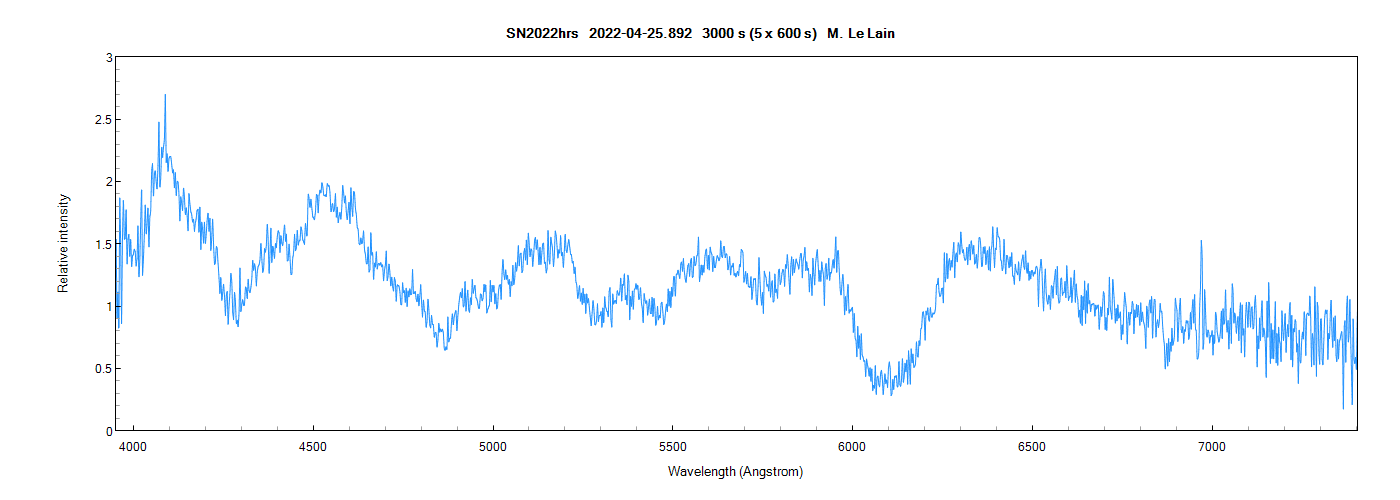

Thanks for this informations, i take a spectrum of this sn last night with my alpy on C8. Here is the spectrum
SN2022hrs_ml
SN2022hrs_ml

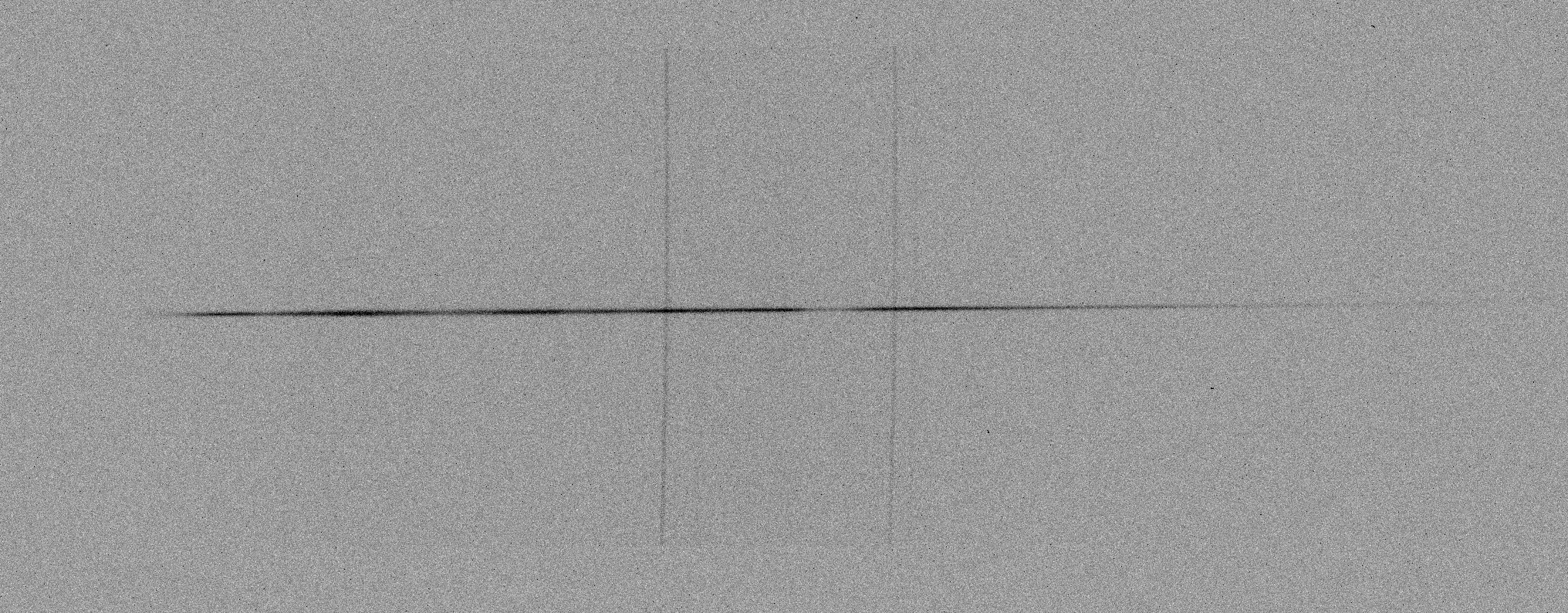

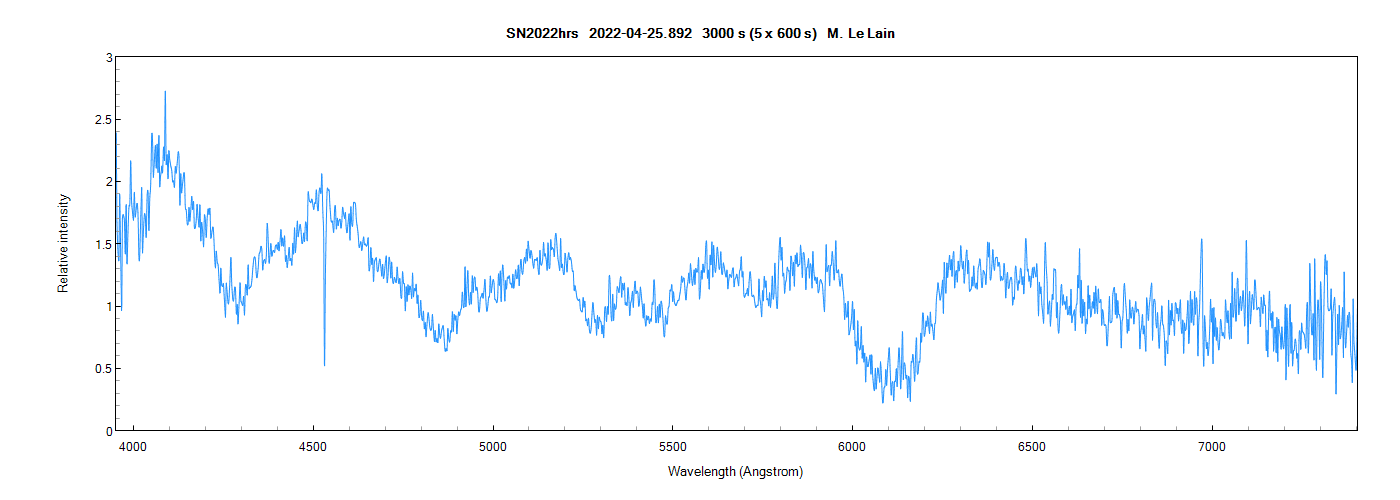

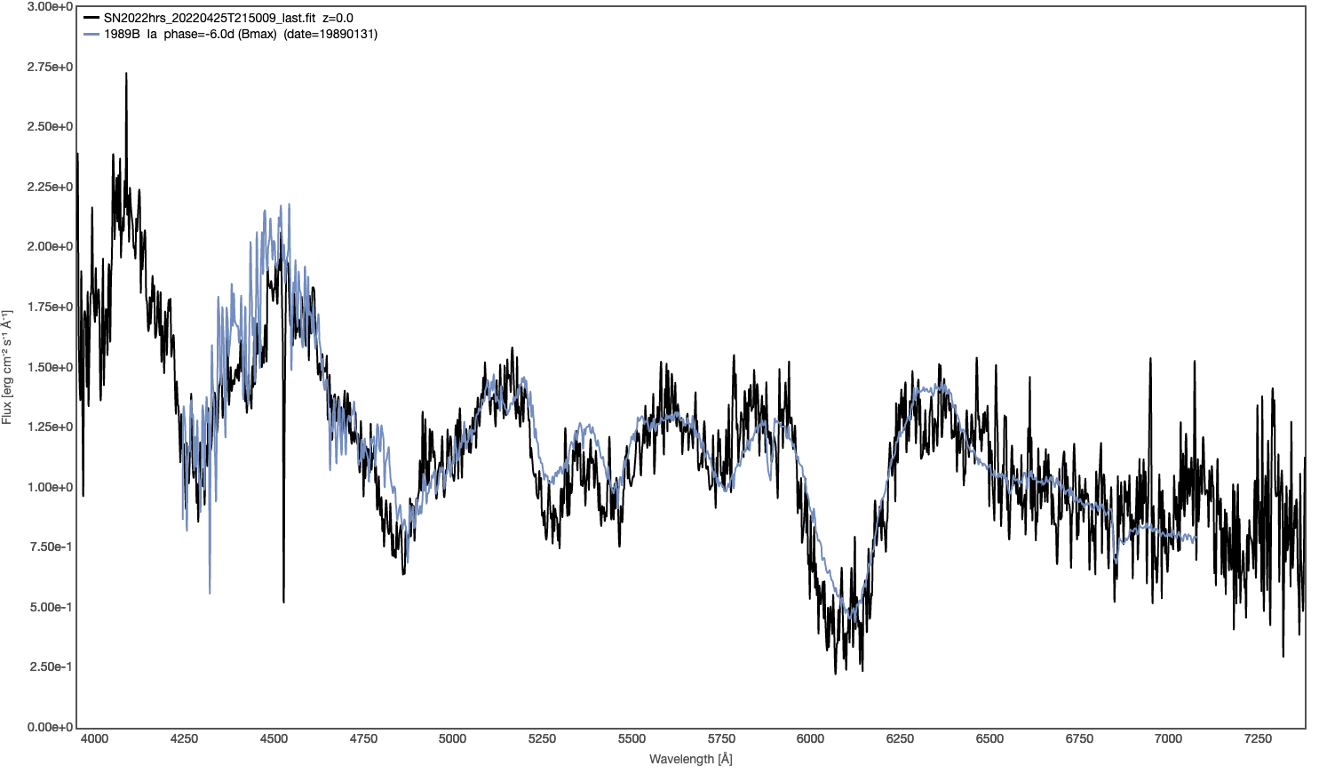

I have a strange line at 4531A. I think it's a artefact, but it's present on each spectra (5 x 600s). Have you any idea ?
sn2022hrs_gelato
sn2022hrs_gelato

Nice spectrum ! You sometimes see sharp emission lines from contamination from the galaxy spectrum but this does not look like that. I suspect it is an artefact. (A cold pixel or a hot pixel that has been made black by the dark subtraction perhaps ?) Can you see it in the images? Does it look like a single pixel? (A real absorption line would appear across the full thickness of the spectrum)

Yes, it is !
Thx for your help Robin
Here is the spectrum, without it
sn2022hrs_ml_2
sn2022hrs_ml_2
