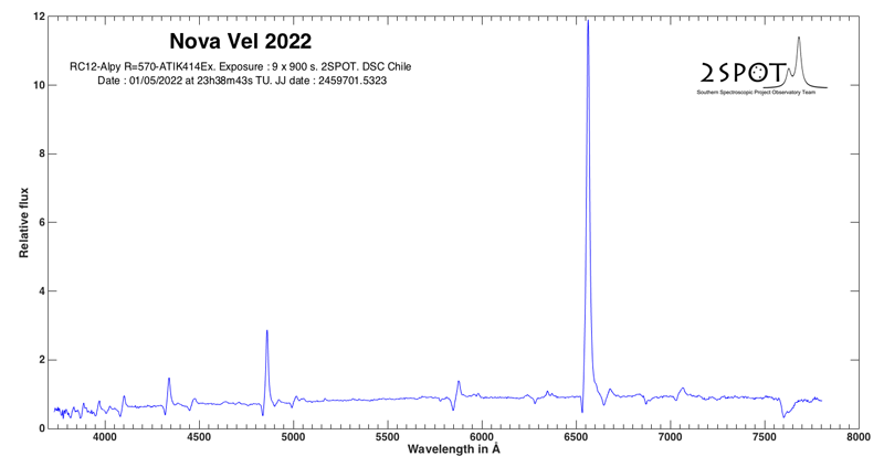

Re: Nova in Velorum AT2022bpq/Gaia22alz
And the spectrum
For Pete and others southern observers : it could be interesting to take a spectrum each day....
Another spectrum made automatically with a script made by Stéphane from ou Team with Prism software.
If the weather is fine the following days, we can produce a spectrum of this target every night. automatically and to the process automatically via our pipeline ARP (made by Matthieu)

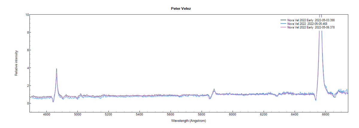

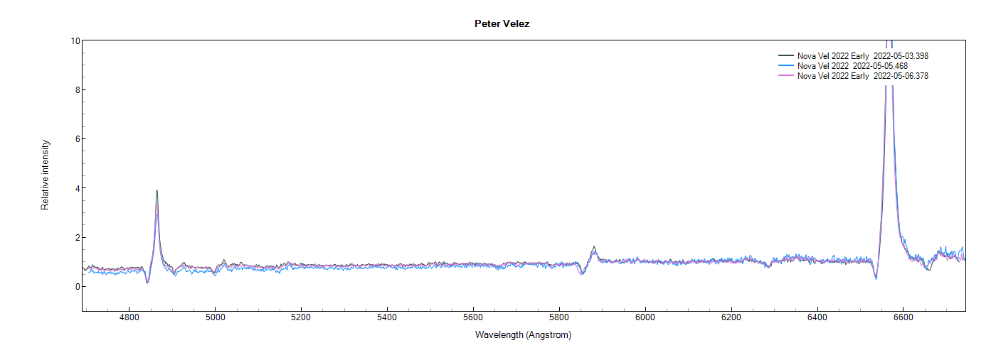

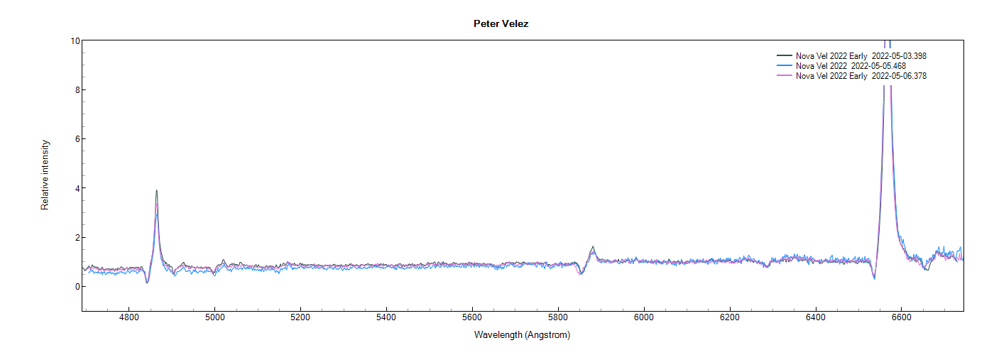

I was on holidays last week but managed to program my system to take 3 spectra while I was away - I only processed them this morning hence the delay. Apart from Sunday 8 May, the forecast looks poor for the next week - hopefully my data covers the period when the 2SPOT guys are clouded over and they can pick this up next week.
Here are my spectra from 3, 5 and 6 May 2022. Between 10 and 12 x 600s exposures each taken with the UVEX on CDK 12.5. R is around 1180. I don't see a lot of development over the week though the P Cygni profiles appear to be narrowing to my eye. I'll do some more homework on this and post separately.
Pete
Pete

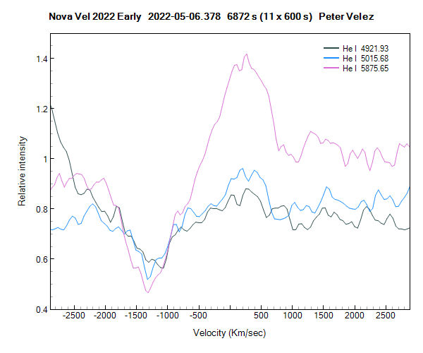

Re: Nova in Vela AT2022bpq/Gaia22alz
Its a bit early to glean too much from the spectra taken to date. Apart from the Balmer lines, the most prominent lines I can discern are He I lines. Here is a subplot showing He I at 4921.9, 5015.7 and 5875.6.
There appears to be the start of a few Fe II emissions but given the noise, I can't be certain of that.
Consistent with ATel 15355, I don't detect any emissions of He II or C IV in the range of my instrument.
Pete
Pete
