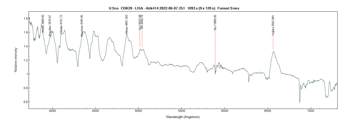

Here is a first view of the spectrum of the recurrent nova U Sco.
Woody

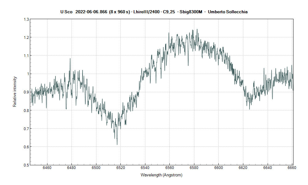

Post by umberto sollecchia »
Salut à tous, je poste mon profil de la nova avec le réticule 2400/mm centré sur le H-alpha
usco_20220606_866_Umberto Sollecchia.png (70.78 KiB) Viewed 10959 times

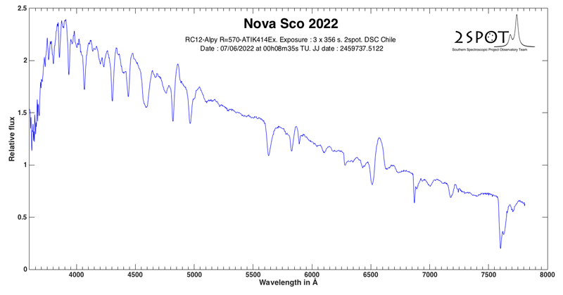

Post by 2SPOT »
And a spectrum taken from Chile this morning with a Prism scrip (automatically made by Prism Software with no human intervention)
We will try it from France with eShel spectrograph, but the target is very low in altitude.....

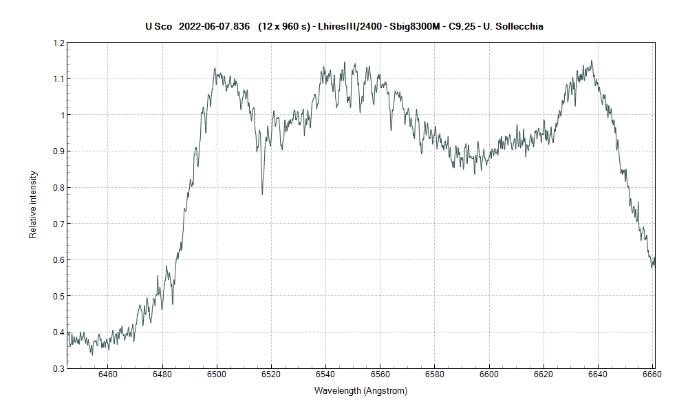

Re: Recurrent nova U Sco in eruption
Voici le profil du 07/06/2022 même configuration meilleure transparence du ciel.
usco_20220607_836_U. Sollecchia.png (53.58 KiB) Viewed 10786 times

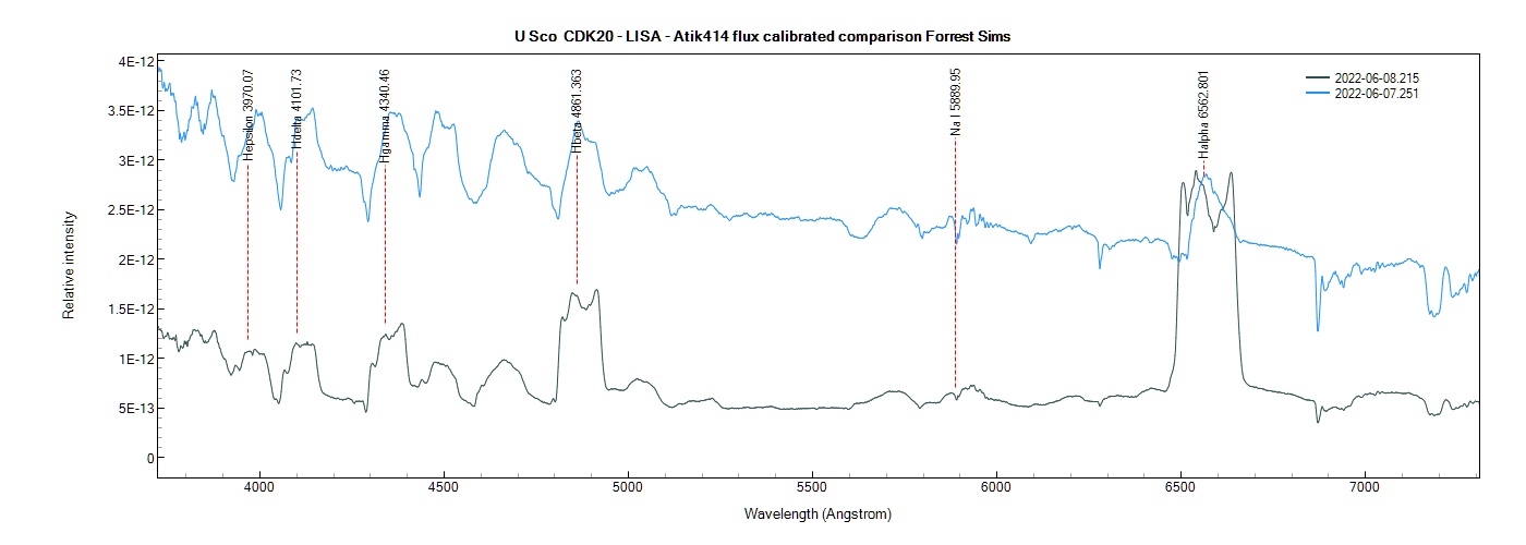

Post by Forrest Sims »
Nice work everyone!
Changes are occurring rapidly!
Here is a comparison of flux calibrated spectra over two nights as the V magnitude dropped from 7.957 +/- 0.072 to 9.484 +/- 0.024 taken with a LISA and processed using ISIS.
Woody
