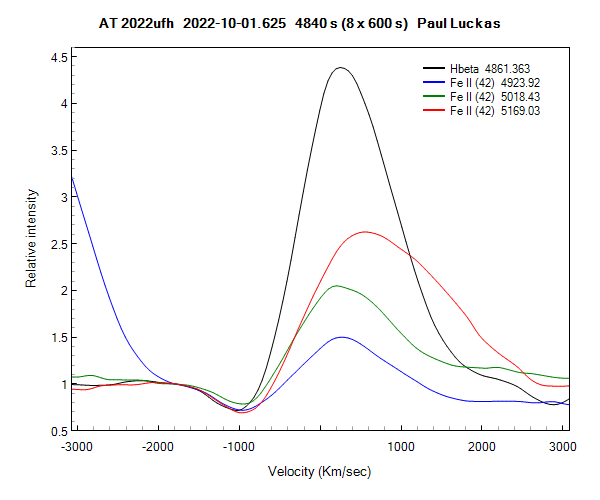

Due to the high velocity of the ejecta low resolution spectra produce very valuable results. For refinement, one can computed the effective velocity, knowing that Observed velocity (square) Vobs equals the sum of the square of the resolution of the spectroscope (Vspec) and physical velocity (Vreal): Vobs^2 = Vreal^2 + Vspec^2.
It is very important to know the resolution of a spectrum in units of km/s (depending of the wavelength).
A common evaluation is obtained by the measure of the FWHM. It should be perfect for a gaussian line on a linear continuum. It is a good approximation in many cases. But for novae near maximum it doesn’t work well due to the strong opacity in the blue part of the spectrum: a part of the emission is absorbed by the ejecta in the direction of the observer, producing asymmetry of the emission profile and at this state absorption resulting from two effects : P Cygni profiles and absorption by neutral gas (not yet ionized due to the opacity) in outer layers of the ejecta.
Thus, the measure of FWHM is a poor evaluation.
Two measures can provide information: the maximum velocity and the velocity at the maximum absorption.
Of course, these evaluations suppose a spherical shape and homogeneous velocity according to the radius at a first order.

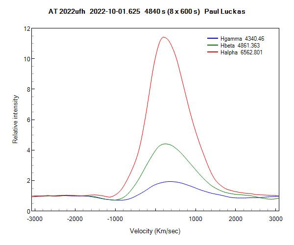

Velocities of Balmer lines
- Compute maximal velocity and velocity at the maximum absorption for the 3 lines.
- Compare them
- Could you explain why H alpha is not the best line to be studied.
- Could you explain why the profiles of these 3 lines are different?
Velocities of Fe II lines
- Compare to Balmer values.
- Fe II (42) are *very very very often * formed in similar physical conditions, thus the shape of the lines should be similar. Why the profile of Fe II 5169 so different ?
