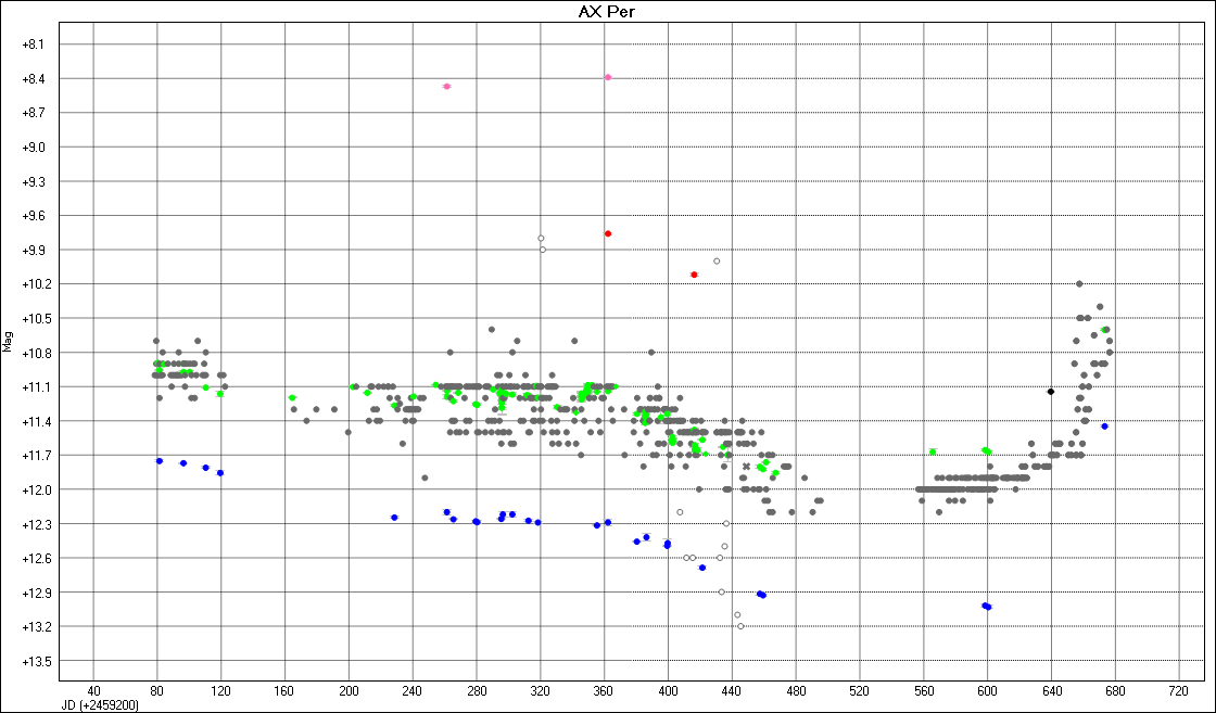

The prototypical symbiotic star AX Per looks bright
Spectroscopy welcome (low and high res) for the database.
