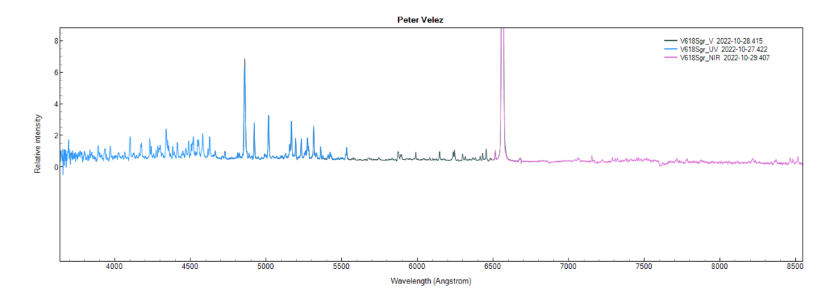

The weather has not been kind to us in Australia this year (again!) and imaging time has been limited. However, so far I have been able to take 2 sequences of the same target at different grating angles - with my set up, this gives me a range of over 4,000 A at resolutions of up to 1500.
To illustrate, I attach a plot of 3 spectra taken of V618 Sgr - my current target of choice. The spectra were taken on 3 consecutive nights. My system controlled all aspects of the imaging process eg set grating, take flats, take ArNe and take the reference star and target images - my only task was to set it running each evening. The NIR spectrum's continuum doesn't quite match the other 2 - likely a flaw in my processing - so I have normalised the NIR to the visual. I have another spectrum of this target in the range 7500 - 9600 A but didn't add this as I have yet to determine how to normalise it correctly.
