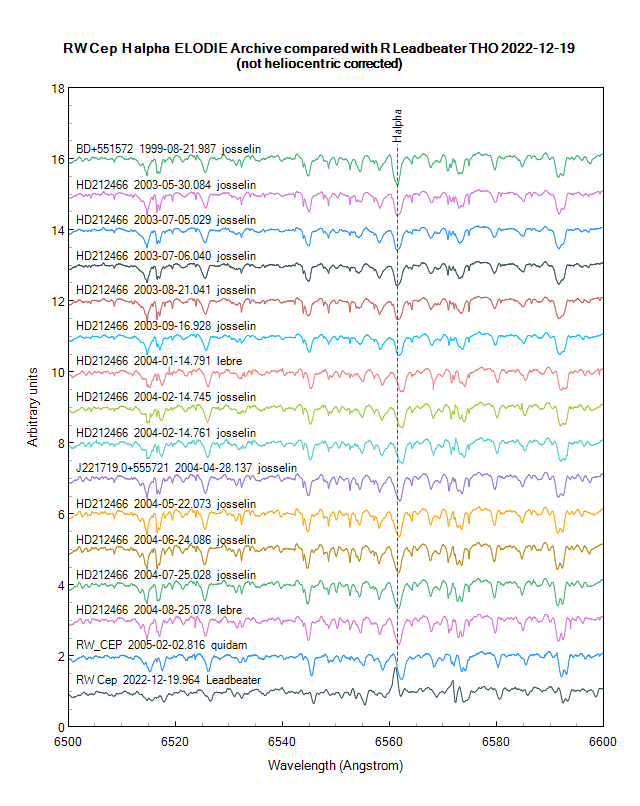

H alpha is in emission
https://britastro.org/specdb/data_graph ... s_id=13128
There may be more lines in emission. An echelle spectrum could be interesting
There are several high resolution spectra in the ELODIE archive but none of these show H alpha in emission (here compared with my spectra)

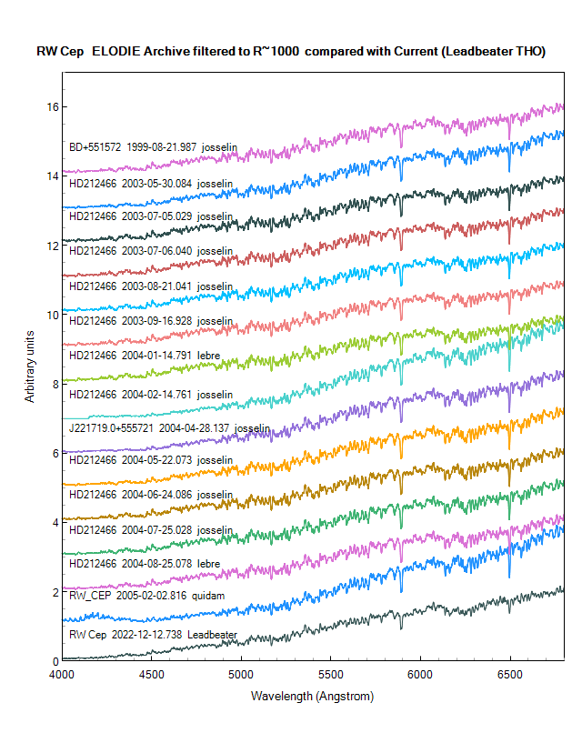

Hi joan,
What do you think of the flux calibration of your spectrum ? Is it ok? What did you use as reference star?
The continuum shape is very different from mine and historic spectra in the EOODIE Archive.
https://britastro.org/specdb/data_graph ... 20+Spectra

Hi Robin,
As you said, the perfect spectrograph doesn't exist, and I'm afraid that an echelle isn't the best tool
for taking a good calibration flux, in my opinion, using a low resolution spectrograph takes very useful
data for it and more easily.
One can see that almost all studies using echelles, represent their data in a horizontal background.
BTW, it's possible that I'll have a good night today and I'll try to take this star again, and go to essay
V photometry with the Piera telescope. It's a pity that SMM one is damaged until the middle of January.
